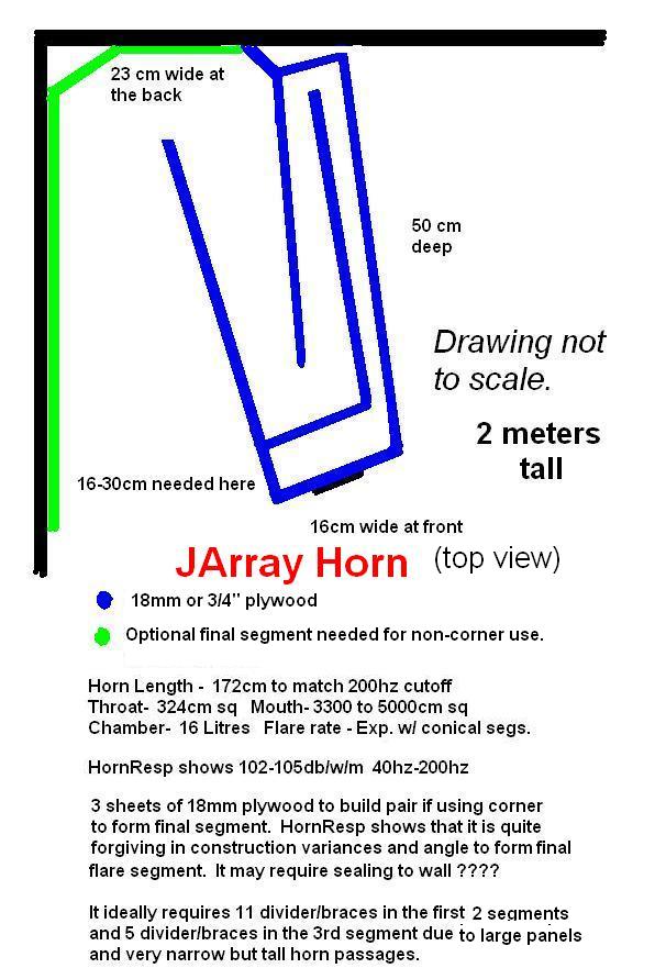

Re: Re: Re: A Modeling I go yupp Yupp
mike.e said:
Where have i seen that image before! HIFI news 1960s??
It's the same image I drew in MS Paint back when I brought the horner horn array topic up in the loudspeaker forum months ago. Did you really see something similar in some magazine or just poking fun at my caveman drawing?

Yep that is where I saw the original image to. Looked through a whole bunch of back issues when I was sinking my teeth in speaker design in the late 80's. Seems like yesterday.
I would post pics if I had the slightest idea how. THere was some thread or something on how to do this but I have never found it. Nor did I figure it out on on my own.
Help !
MArk
For images, go below the typing input window for a reply and click on browse. Just find the file in your computer and click save, which attaches it. Use JPEG files so they are small.
At least now I feel alot more confident in my idea, since some horn expert came up with the same thing decades ago.

Ok all you savy horn designers. I have done my home work. Modeled the hell out of the horn in Horn Response. I understand what to do. But due to system crach a couple of months ago I lost my program that generates the horn area per lenghth increments. I found a great paper by MArshal Leach and a great program that will work along side. But it won't spit out the design on paper. Just in a box that I have to copy by hand. It's the MLutil from the single driver website. Does anybody know of a spreadsheet file that will spit out the numbers?
Mark
Just highlight and copy from the tool on the single driver website and paste directly into excel if you want to manipulate the numbers or simply notepad to just print them.
Also note that HornResp gives you the corresponding flare rate in Hz for each exponential segment. Then convert to conical at the end. Varying the flare rates of the different segments is a common way to use space more efficiently in a bass horn. For example the Jensen Imperial hypex horn flare has a 20hz 1st segment, a 50hz second segment, and about 40hz final 2 segments with a 2m overall length and it's a real champ in the low bass department. Of course it cheats to get the really low bass with the extra large compression chamber.

I have found that there is quite a difference between the Leach model and the others available. I have read that Horn Response uses Leach as a source for the calculation to. Everything that I have found so far ges me a hyp/exp flare rate based on different formulas and gives me a very different horn. The ML util is quite interesting to use. Really quite powerfull. But from it's data I cannot print the horn section table.
If I am going to build such a beast I would like to do it right. I have built around a dozen horns using tractrix calculator on the single driver web site and the hyper/exp calc on the same site. You don't usually get the response that you are shooting for when you design with these. I never knew about the Leach horn paper untill quite recently. Many people who's websites I take as being well researched say that Leach is one of the most accurate methods. See this site:
