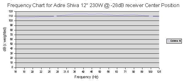

simon5 said:This is a subwoofer I made, when placed in a corner, using RatShack Meter with correction factors...
is the mic at the listening position? You used EQ?
No EQ, listening position, small room so close to the subwoofer.
Probably lucky hehe!
This graph is not done with 1 Hz increments so there's probably room modes hiding in there I guess. I'll try to do a better graph next time.

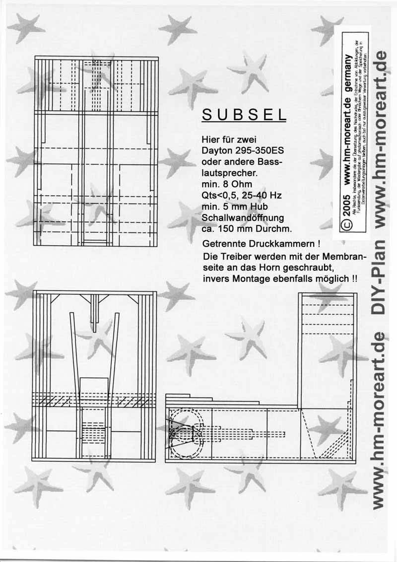

may I show your my SUBSEL free download
hornsub, place it directly in the corner lay it on a side
don´t use it as an armchair.
More or less easy to build only two angles,
I prefer the version with two 6,5" driver
for example Dayton
for example Dayton
hm,
great horn designs. Your book is nice. Unfortunately, this cabinet is to large for my space constraints. Thanks anyway. Maybe one day I will be able to hear one of your horn speakers.
Hezz
Hezz

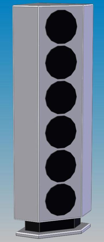

Here is an other option using six 12 inch drivers in a 7 foot tall main cabinet.
This might be a really good option for someone who would rather buy six 70 USD drivers instead of one 600 USD high end 18 mm X-max driver.
The dimensions of the cabinet are about 20 x 20 inches by 11 x 11 on the short sides and about 18.25 across the front baffle.
Hezz
Hezz
JohninCR,
The maximum size of the cabinet is 7 feet tall in an 8 foot space. The above 12 inch array cabinet would be a maximum size but I would like a little smaller.
I will supply you with the specs for the Dayton 8 inch driver even though I think I will go with dual 12 inch sub. But I think that it would be both interesting for you to model and also might be a good solution for others. My mockups show that you can get 9 of the drivers mounted in an 7 foot tall cabinet.
Hezz

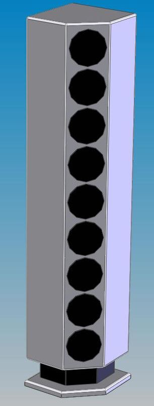

OK JohninCR,
If I was to do an 8 inch array I would need cabinet something like this. Again 7 feet tall and 18 x 18 inches on back sides. 11 x 11 on short sides and about 9.5 across front baffle.
A single Shiva that's virtually flat from 125hz to 16hz at 108dB, with no EQ and the response is that flat?
I'll take that with a pinch of salt even with room gain 😉
You'd probably get a a flatish response in a larger room but then it certainly wouldn't be flat to 16hz at 108dB and no EQ or driver destruction for that matter.
I could work at the p-p required for a 12" at 16hz 108dB but I already know the answer and the Shiva isn't it.
Also why do you have the sub running all the way upto at least 125hz? Bet you can hear that sucker booming away in the corner 😉
