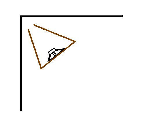

Now that I got the stats what was your layout idea again. I know that it is hard to paint a picture with words. But are you trying to model the horn with the woofers in a manifold or multiple segment or what???
Tough question but if I get your drift I will be infor some awesome bass.

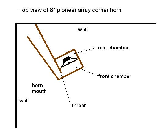

I forgot to answer your HornResp question. For multiple drivers you enter a single driver's info. Just double click on parameters that you don't know and fill in the answers. You need the basics of Sd (I guesstimated 177 for the pioneer) Fs, Re, Qes, Qms.
Once you have one driver in, save that, then ADD to start a new model and make the multiple drivers. One driver won't do much in a short horn like this, but when you essentially stack 8 of them together, the results gets impressive.
I usually let it calculate an optimum hypex horn to see the potential and go from there. Figure out how to build it after you get the results you want.
One last thing- Parts Express showed and xmax of .10mm on that driver. I'm sure that must be a typo. I figured it was supposed to be 10mm. You might check with PE first before buying.

The drivers would just be in a straight line below the one shown. Now that I think about it I'd alternate which direction each driver faces to get the extra benefit of push/pull operation. Get the wiring right if you do that. That would also give you double the air volume for temperature management if you plan to really push them.

I thankyou for that drawing. I had seen something similar years ago and your pic triggered the memory. An ingenious use of the corner and big saving in cabinet volume and size. HornResp is up and running. I should have something modeled as soon as I can find the damn driver specs.

No problem Mark. With larger drivers you'd probably want to do a 4 segment horn with the folds behind the chamber. That way you can get much more horn length but retain a compact size. A super easy one with large drivers would look like this from the top.

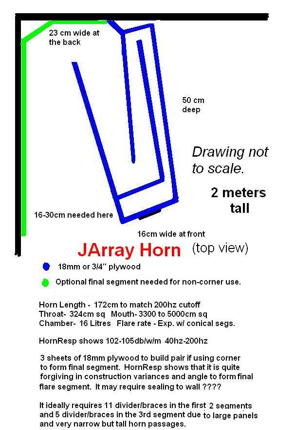

Using 3ftX3ft of corner space and an array of larger woofers you could probably get flat in room response lower than 32hz without EQ. About 2.5m of horn length should do the trick. I think I would build the final fold into the unit and not have to worry so much about attaching and sealing. Leave a little extra space on the rear right side, so you can turn the horn some to adjust the final flare and mouth. The really nice thing about the design is that folding isn't restricted to a rectangle making that part pretty simple. If you play with it in hornresp you'll see you have a lot of leeway in the segment lengths to make it all fit. Use a good number of pathway dividers which will act as braces to and it will be really solid and heavy.
For a 7ft tall one I would run the first 2 horn segments as 8 passages and 4 passages on the 3rd segment. I think this would be accomplished best with just 7 horizontal braces, 3 running the entire length and the other 4 just the first 2 segments. The 3 larger braces would look just like the pathway view from the top looking down. Make 1 and it would be the template for all of the other braces. Once you glue the braces to one panel, it would form a skeleton for the entire horn and make construction pretty straight forward. Just plan well the order you assemble it so you can seal it properly as you go.
Sorry about the lengthy explanation but I've already been through the planning of the 16 small driver horn, which starts with very narrow pathways making 15 divider/braces necessary through the 1st 2 segments with 7 of those through the 3rd segment in order to maintain a good height/width ratio of the pathways. I just need to decide on drivers.

If only you were a little closer than Costa Rica. I'd happily whip up your cabinet design. I appreciate your description. My background trade training is in cabinetmaking. Twenty years worth of stuff that did not include to many kitchens. Mostly furniture and fancy architectural millwork. Lots of curved work, bent mouldings, spiral staircases and the like. And I have done quite a few horns.
I had been working on a horn array off and on for about a year. But I could never come up with a reasonable cabinet that didn't require being built inside a house. They wouldn't fit through the door!
Then along comes John and bingo!
The lights are on again!
You do impress me with your forthought with regards to panel dampening. Right on the money. I woke up this morning with sort of the same idea but your idea will be better. If you think about it a bit you can trade the weight for proper panel stiffness. For example if you use 1/2" or 12mm material the stiffening ribs that you describe will allow a very stiff yet light cabinet. The ribs would have to follow the entire flow path to be effective at that panel thickness. I'm currently looking for poplar plywood with the same structure as Baltic birch. I know that it exists here in Ottawa I've worked on jobs were I saw it hanging around. It's just finding the right source for it. This stuff is very stiff and very light. (compared to birch) And is available in 4' by 8' sheets. It is easier to work with due to it's size and weight. And it is almost as stable.
For the horn bends there is some wonderfull stuff called bendable plywood that has become my favorite thing to use. It allows a pretty tight radius and when laminated up from two thinner sections ( 2 x 5/16" or 8mm = 16mm or 5/8") Makes for a very stiff wall. And it is not to expensive. At around $56 a sheet. I have a couple in stock but for these babys I will need around 8 or ten sheets.

Thanks Mark,
It wasn't so much the panel damping that I was concerned about. It was keeping a ratio of less than 7/1 throughout the horn pathways and then how to build it. The throat on my small driver version is about 1/3 the size of this one for 8's, so virtually no way to get a hand in the 1st 2 horn segments once the panels are on. It could be all 12mm ply except the outer panel on the last segment.
Also, you don't have to worry about smooth curves at the bends with bass, so that makes everything really easy except making the braces and the driver holes and not much in the way of angles.

Hold the presses. I found an error in the HornResp input for those pioneers. VRC is liters and VTC is CC's. For the response I was talking about, it needs to be a rear horn until I work some more on the design.
Mark, if you are plugging this stuff in be aware of that difference above. To see a schematic of your horn, do calculate then under "Window" the schematic is a selection item.
