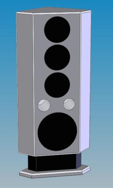

Here is a 3D mockup of my corner design. My idea is to use one 12 inch woofer in a Qts .7 tuned enclosure getting the lowest F3 that I can. The 12 inch will make up about half of the surface area of an equivalent 15 inch driver. I think that a good twelve inch driver with a strong motor assembly can have tighter base than a 15 inch due to stiffer and lighter cone. At least at a reasonable cost.
THe rest of the equivalent 15 inch surface area will be made up of three eight inch drivers vertically mounted above the 12 inch driver. These are the high transient response drivers and will each be mounted in a critically damped Qts .5 sealed enclosure. They are closer to ear level and my hope is that they will kind of fill in the slightly less defined bass that the 12 inch driver will output. The three 8 inch drivers will be 16 ohm if possible and be driven in parallel with one channel of a external stereo amp. The other channel will drive the 8 ohm 12 inch lower driver.
Hezz

I think your idea seems good in principle to the layman, but the idea in theory and practice I think will actually be quite bad. Your stalling point is that you have a very narrow bandwidth for each set of drivers, and also a crossover between them. Crossovers are bad as they introduce phase and group delays.
Also it's a myth that smaller drivers are faster or have better transient response -- you will find that if you design your sub right with a single 12 inch it will be fine. Think of a how a big heavy Porsche can still stop, start handle better and go faster than a little shopping hatchback 🙂
Finally, you re trying to get fast bass and good transient response, then sticking the sub in a corner. You will make more difference than ANY sub design will ever make simply by placing the sub somewhere else in the room. Corner is the worst place to put a sub as it drives the most room modes and often sounds most uncontrolled -- totally negating all your effort in designing a good box.

Isn't this the worst of all worlds? With all drivers covering the same frequency range, the sound will certainly be no better than the worst driver in the bunch. The FR will also likely end up rather odd because the 8" and 12" drivers will have different F3 and sensitivity, which will likely lead to exagerated 60-100Hz and an even sharper rolloff for the subbass.

Tiroth,
you make a good point about the sound not being any better than the worst driver and it is possible that I may need to low pass filter the larger driver but in the world of the best sounding high end speakers an approach like this is often used and works very well in reality.
Check out the Wilson speakers and the dual sized woofers that they employ. As far as frequency response goes. It is rare for any speaker to have a flat response and so long as it doesn't have a grossly unbalance response things seem to work well.

Hmm, I'm sorry but I think you will be able to achieve so much more if you were willing to change your design. You would be much better off using one decent 12 inch drive unit, or two cheaper 12 inch drive units, than the mismatch you have there. I'm sure this would stay within your cost constraint as well. As Tiroth said, you are likely to end up with a rather bad case of one-note bass. It may work in the design you mentioned, but I'll bet they aren't trying to do it all within such a narrow bandwidth.
It really is a myth that smaller drive units have better transient response. A cheap 12 inch one can whoop a bunch of 8 inch ones in that department if you choose wisely, its not really much to do with price.

Hezz,
I believe the Watt/Puppy is specifically designed so that the rolloff of the mid complements the rolloff of the woofer, and even creates a hump to correct for the baffle step This can only be achieved by very carefully matching the drivers and their alignments. You can't just put random drivers together and hope that they integrate.
I think 1.5 way would be better; the drivers can share operating range but the lower-Fs driver is used merely as a fill-in. I can't comment on how this approach works in the real world, although I have contemplated it myself. The problem I have is that if your 8" drivers go sufficiently low, then it's hard to find a 12 that has significantly more extension. You end up choking the 12 and preventing it from reproducing much--at least that is what I fear.

I fully realise that quality reproduction is your goal that is why I am quite strongly trying to steer you away from your original design. I would speculate that what you find bad about the sound of subwoofers is not all down to high Q. In fact the Q is probably quite a minor factor. The filters and other controls used play a large part in the sound as does the drive unit itself, i.e. under dynamic conditions the parameters may change somewhat. And room placement is the biggest factor of all.
I urge you to use a single type of drive unit to maintain an even and predictable sound. It should be a larger rather than multiple smaller units because it will be much more likely to go lower and do so easier. As a bonus it will probably be louder, too.
It is perfectly feasible for a smaller drive unit to have a higher Qts than a larger one. As I keep saying, smaller drive units are not intrinsically faster or better at reproducing transients.
A pair of 8 inch units has roughly the same cone area as a single 12 inch. However, the 8 inch units require 2 lots of cones, chassis, magnets, voicecoils, assembly, etc. which weighs and uses much more than 2x the materials of the 12 inch. So for the same price point a manufacturer can make the 12 inch unit better.
OK, I do see both of your points and they seem to be good ones. Perhaps I was sticking to this original line array idea too much. If I was to use any crossover at all it would be the 1.5 kind of idea. But really I wanted no passive crossover at all between the Amp and the speakers because of needing to adjust speaker cabinet volume in a slightly guessing game kind of way from having inline resistances changing driver Qt.
Tiroth used the Watt/Puppy example but I was thinking more of the MAXX or X1 as the bass module is designed as kind of a 1.5 but then again the upper driver is probably going up higher into the 300 Hz range. So this places the crossover points further apart. However if there was no crossover on the upper driver would crossover interaction in a narrow band be an issue.
My original idea with this was not to have the upper array and lower driver split frequency duties. Which is what I think both of you are or were thinking. But rather to layer or mix the sounds of the smaller drivers with the larger one in the hopes of getting more micro dynamic detail. It is obvious that a well designed 12 inch speaker can have better transient response that a poorly designed 8 inch. And while producing the signal the sound should be the same. The issue is the starting and stopping of the driver cone in as fast as possible a manner without any overhang. this is easier to do at a modest cost with an 8 inch driver. Also, all other thigs being equal the 8 inch driver cone should be more rigid. This alone should help make the sound cleaner as the cone does not flex as much when accelerated by the motor.
The WATT was originally designed as a stand alone near field studio monitor so early iterations of the WATT/Puppy ran the watt at full range as I recall. Perhaps that is why newer versions of the speaker have gotten more praise for bass sound integration as there was been adjustments to this design issue.
Since this subwoofer is designed primarily to be for sound effects it might be wise to go with the simpler and likely more dynamic dual 12 inch drivers. My main goal is for seamless integration with the main speakers given my placement constraints. And I hate boomy one note bass.
I would rather the speakers did not even make themselves known untial they were called upon to reproduce the needed effect.
I still feel that the acoustic sum of the drivers with the original idea would work better than you guys are thinking. but I am starting to think that maybe since this is an effects speaker and not a music reproducer that I should be thinking more in terms of dynamics. In this case I'm sure the dual 12 inch would be superior.

Ah but thats no use if your system has 2 vertical woofers on the front and 2 arranged vertically on the rear,youved got a multidirectional system + more when driver to driver spacing = more than one wavelength.
Hezz said:OK, I do see both of your points and they seem to be good ones. Perhaps I was sticking to this original line array idea too much. If I was to use any crossover at all it would be the 1.5 kind of idea. But really I wanted no passive crossover at all between the Amp and the speakers because of needing to adjust speaker cabinet volume in a slightly guessing game kind of way from having inline resistances changing driver Qt.
I thought you would use an active crossover if anything as you hinted at using a pro amp channel per driver bunch. Don't even think about passive crossovers for anything lower than 200Hz. The inductors will be large and expensive and the response garbage due to the massively varying impedance over the full wanted bandwidth.
Hezz said:Tiroth used the Watt/Puppy example but I was thinking more of the MAXX or X1 as the bass module is designed as kind of a 1.5 but then again the upper driver is probably going up higher into the 300 Hz range. So this places the crossover points further apart. However if there was no crossover on the upper driver would crossover interaction in a narrow band be an issue.
Crossover interaction is not the issue. Simply having a crossover is. Every filter introduces delay and phase variances. This would be compounded by you trying to filter in such a narrow bandwidth.
Hezz said:My original idea with this was not to have the upper array and lower driver split frequency duties. Which is what I think both of you are or were thinking.
I'm not sure how you managed to come to that conlusion. Maybe I need to shout 🙂 As I have mentioned at least twice and Tiroth at least once, if you don't filter you will likely end up with one bass.
Hezz said:The issue is the starting and stopping of the driver cone in as fast as possible a manner without any overhang. this is easier to do at a modest cost with an 8 inch driver. Also, all other thigs being equal the 8 inch driver cone should be more rigid. This alone should help make the sound cleaner as the cone does not flex as much when accelerated by the motor.
That is indeed the issue. However, starting and stopping without overhang is exactly what transient response is all about. As I have already said it is a myth that a smaller driver can be better at this than a larger driver. At least intrinsically.
