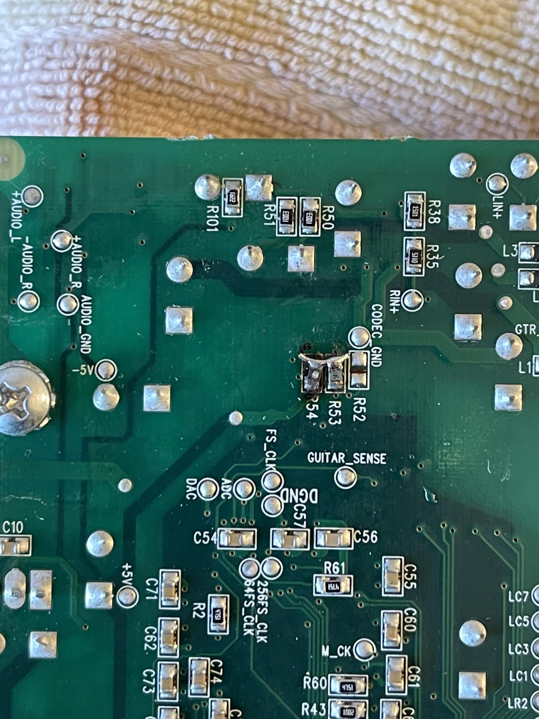

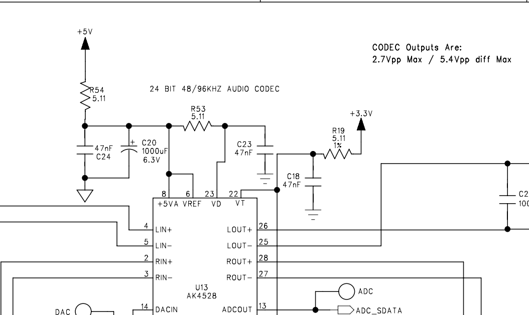

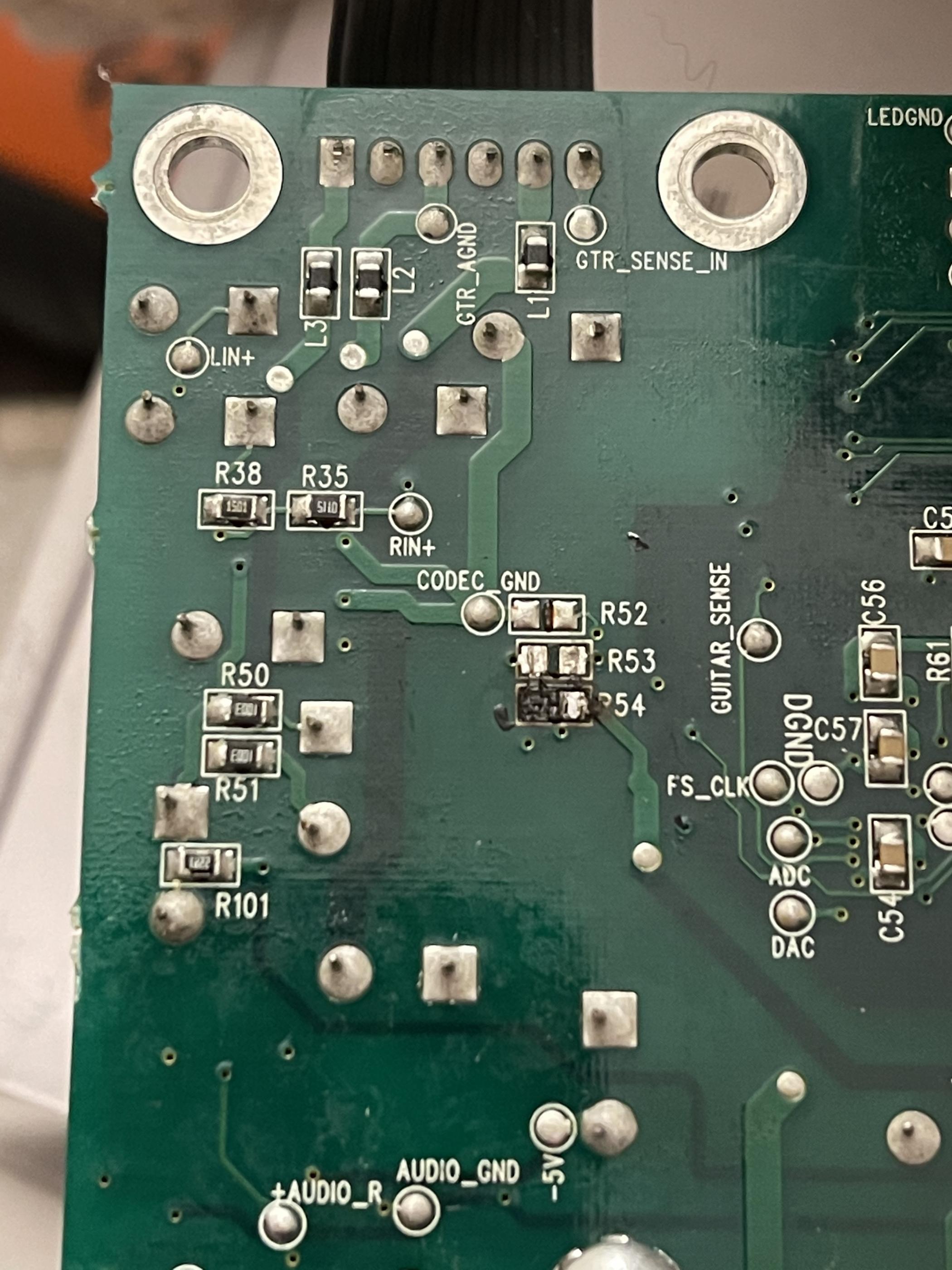

Replaced R53 and R54 (and U3 while I was at it). Unfortunately, powering back on recooked R54. The 5V rail was ok when I checked it before, what else could be causing too much current to flow through R54? Maybe a bad U13? Should I remove R54 and recheck the 5V rail? See second picture below for relevant area of schematic; see post #2 for full schematic.
All the electrolytics LOOK ok, but I don't have an ESR meter to check them. Is there anything else I can do to evaluate if they are still good? Should I just replace them all?
Removed and checked C20. Capacitance reading was ok, but resistance values were a bit wonky so I replaced it. Replaced the cooked R54 as well.

Replacing C20 did the trick! The amp works fine now. It even survived me running it for a few minutes with the speaker cable not fully plugged in (whoops!).

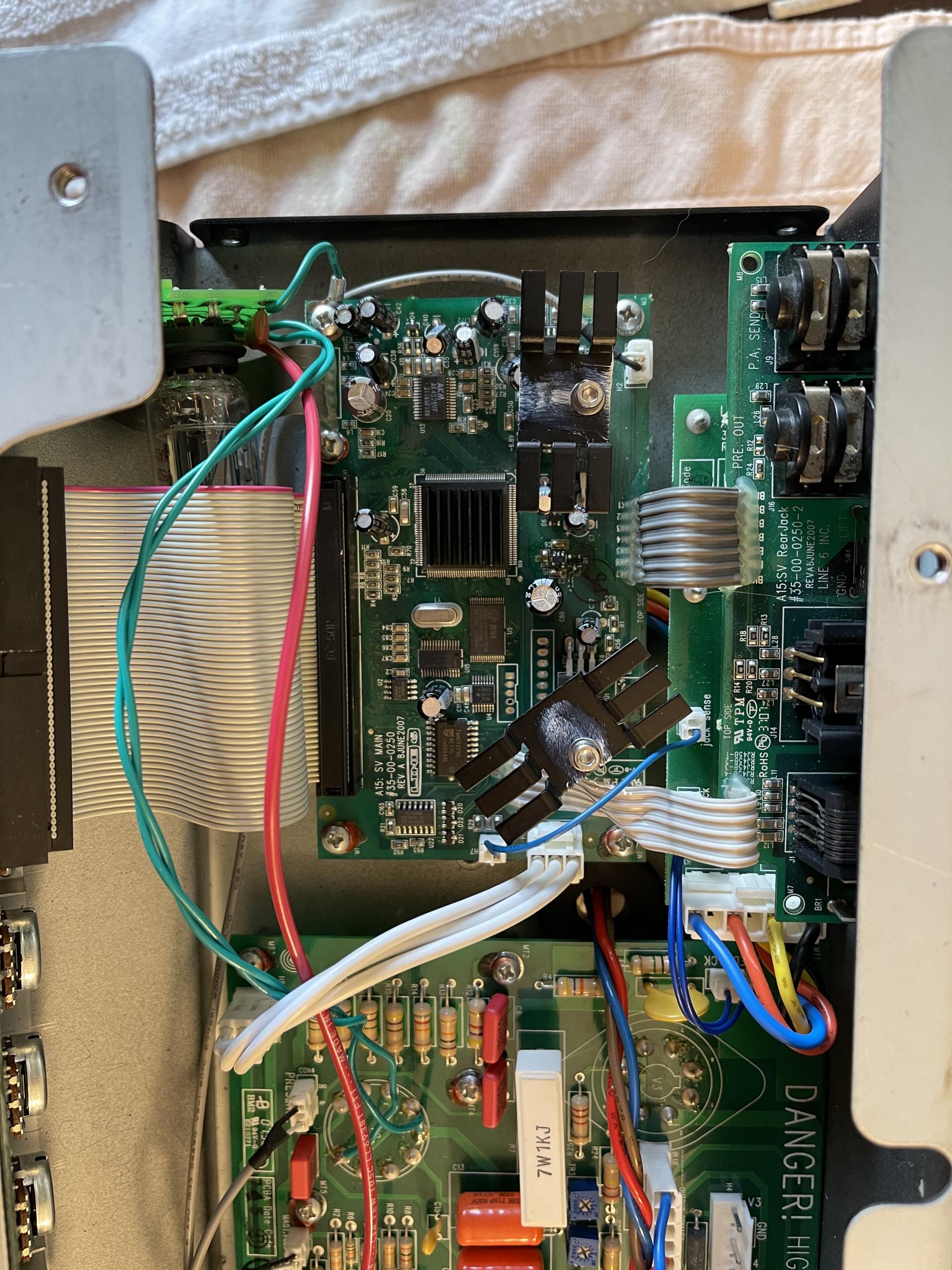

I also added some heatsinks on the voltage regulators and DSP chip to help ease the overheating issues common to these amps.
