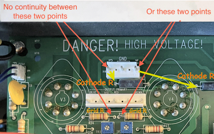

The bias test points go to One Ohm Cathode Resistors, NOT the grid voltage.
With tubes out the test points will read zero.
Yes, you do want to check grid voltage *before* you put tubes in. Measure at the 220k resistors' legs.

The amp has test points for the bias voltage ans test points to measure the bias current. I was hoping to get a measurement of the actual bias voltage, seems it was 33V. I thought if it was not in the right range the tubes might have been red plating causing a bright bulb condition. Sorry for the confusion.

  • No matter how I turn the bias trimpots, I only measure ~15mVDC max at the bias test header.

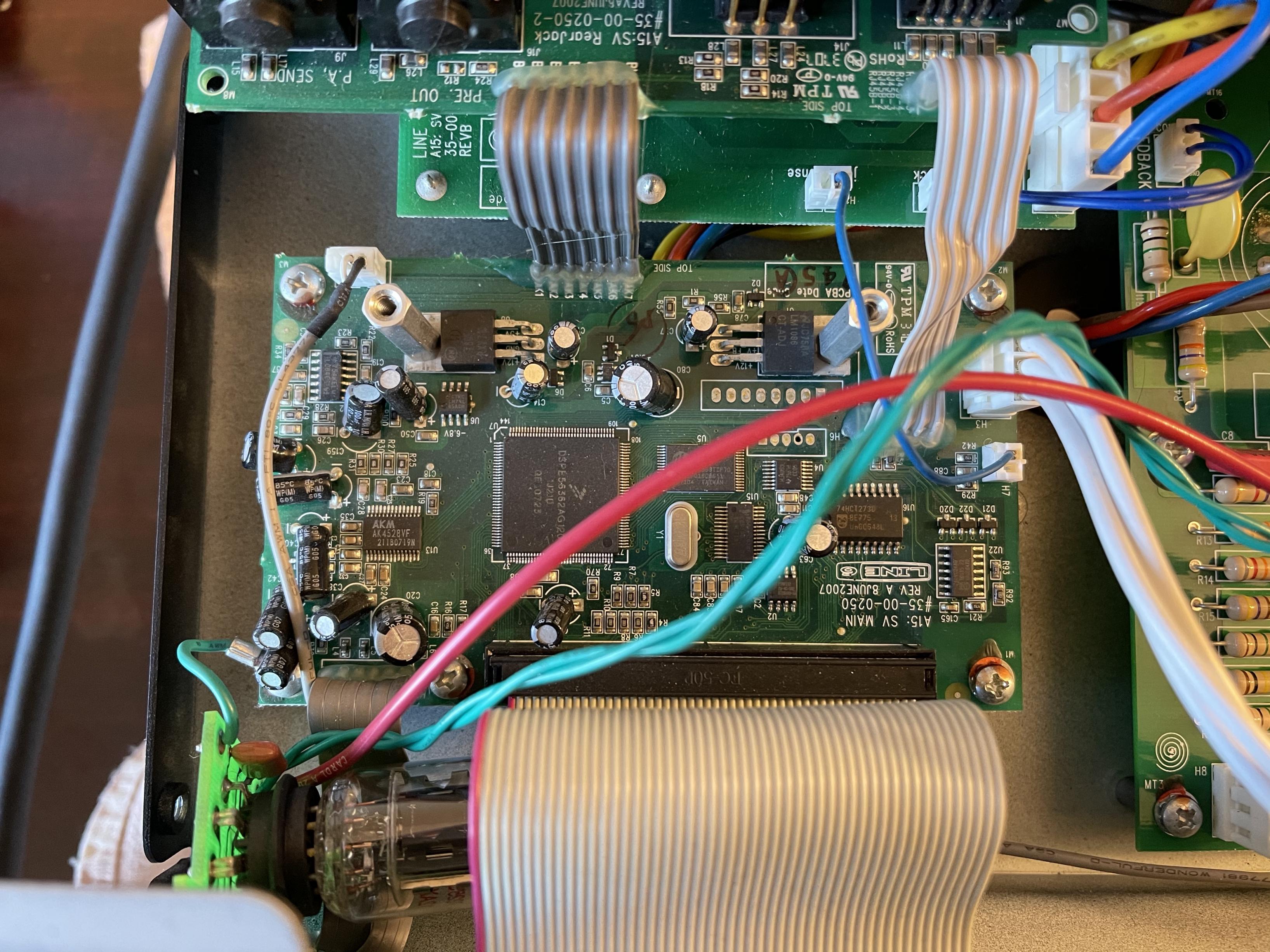

LCD screen showed bars in both standby and "on" states. Next step is to check voltages on main board; see picture for PCB in question. Unfortunately, a lot of these ribbon cables are glued on...

Probing around in the main PCB I found that I'm only reading ~+1.9VDC at the positive of C80 (should be +3.3VDC) here. +12VDC, -12VDC, +8VDC, and -5VDC rails look ok. However, I do read ~+5VDC at one side of C6, so it looks like there's something off in the U3/C80 area.
Any other easy ways to check if U3 is ok? Would a bad C80 cause this low voltage reading?
because there's little chance of a full schematic googling the processor board trouble shows that the problems stem from inadequate heat sinking of the regulators causing the voltage to collapse and the processor itself running hot and there are several YouTube vid's showing some homebrew heat sinking mods(a few scared me) but most worked.
