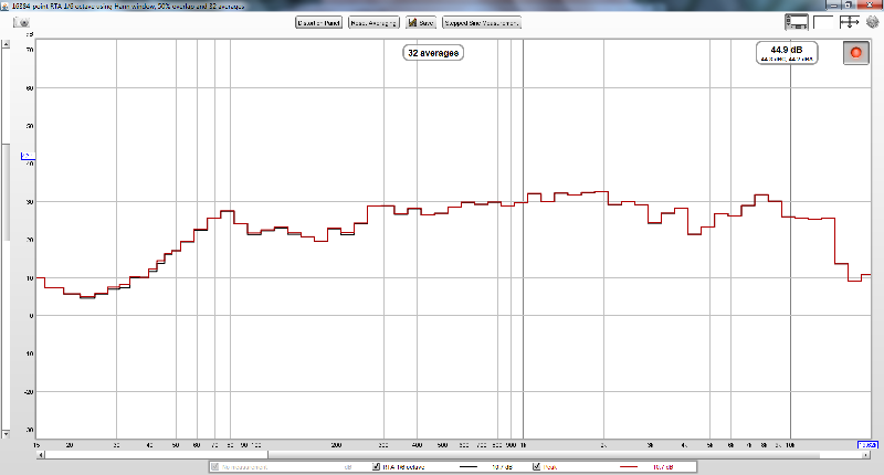

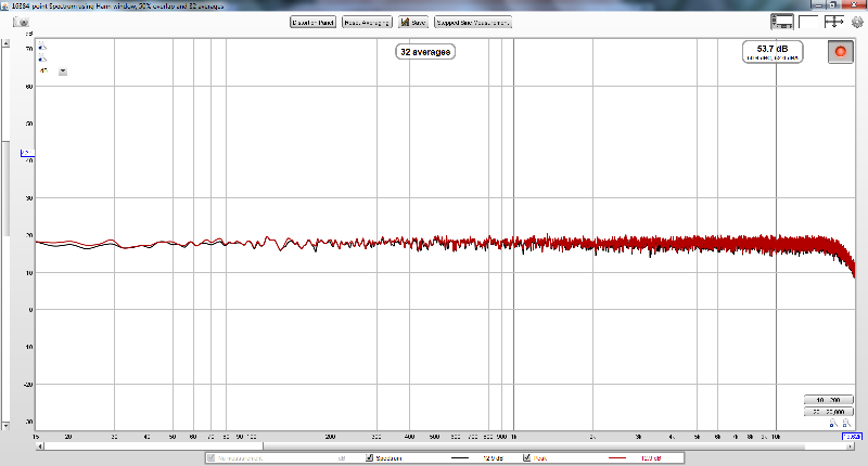

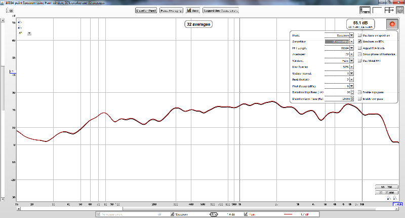

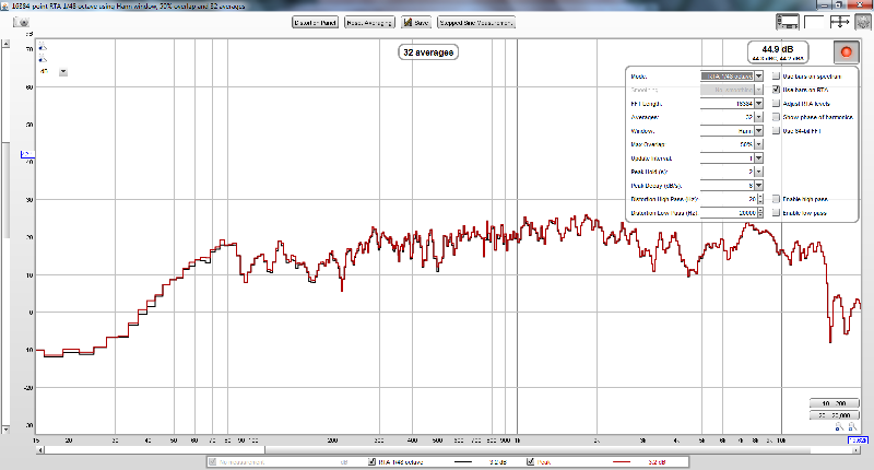

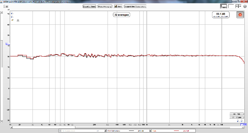

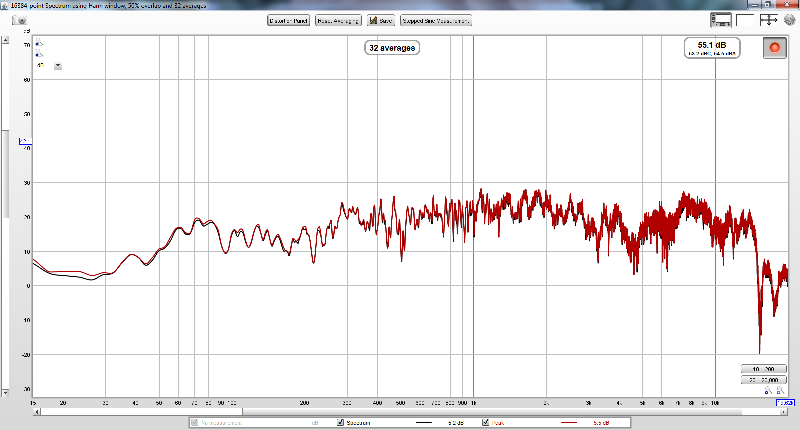

For those interested in the Lii F15 - and questioned about the manufacturers use of smoothing - let's see. I ran some white and pink noise tests in my non-anechoic living room listening area. FYI - here they are.
I used an Ivie noise generator and Apex 220 mic, Tascam US-122L ADC. Two sets of 3 screen shots, first is electrical input to the driver, followed by "1/6 smoothing" / 6th octave wide bands and the no smoothing / 48th octave bands. All uncalibrated to actual SPL reference - just to see the relative frequency levels in this drivers response; the woofer was not enabled.
Aaand, it seems I ruined all the pictures by resizing them for DIYAudio's storage sake, now you cant read the graph axis values and I, of course, lost all the originals. Repeat another day...
I think you're losing level from 1k down because of the limited baffle size.

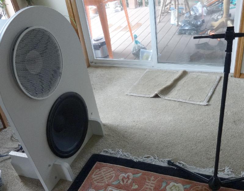

Uh, I dont have a protractor big enough to mark off all the angles for a polar measurement. The ones posted are at a little bit of an angle - mainly because my mic stand is collapsed as far down as it'll go. I had the boom for it at one time, but lost it...
Let's see if I can get something a little more readable up tomorrow. I think the downward slope from 2K through 200 Hz is easily compensated by EQ, which I assume all modern systems have and use.

from a jj test we have a near 20db up/down in the frequency ....
I agree, the response seems a bit uneven.
