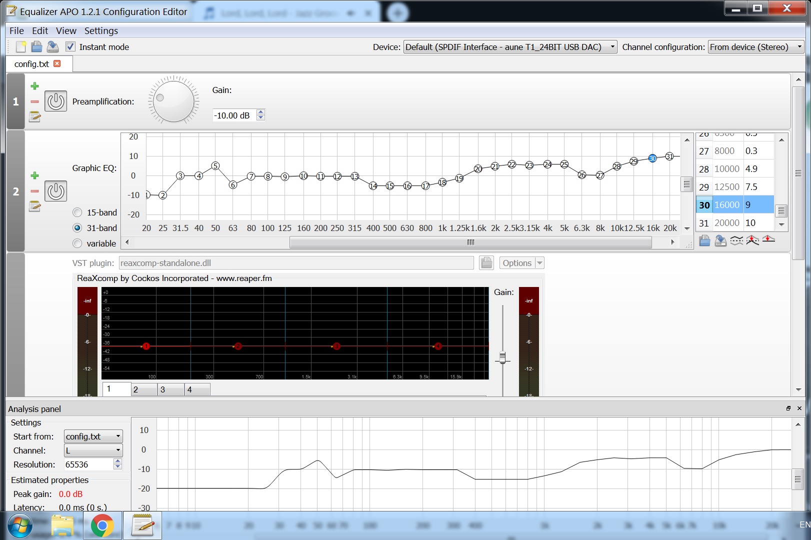

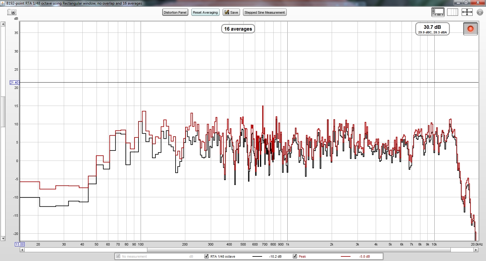

So I obtained an Apex 220 measurement mic, was able to connect it to a Tascam US-122L providing 48V power and A/D services. The following two responses were taken, using REW's 48th octave analyser.

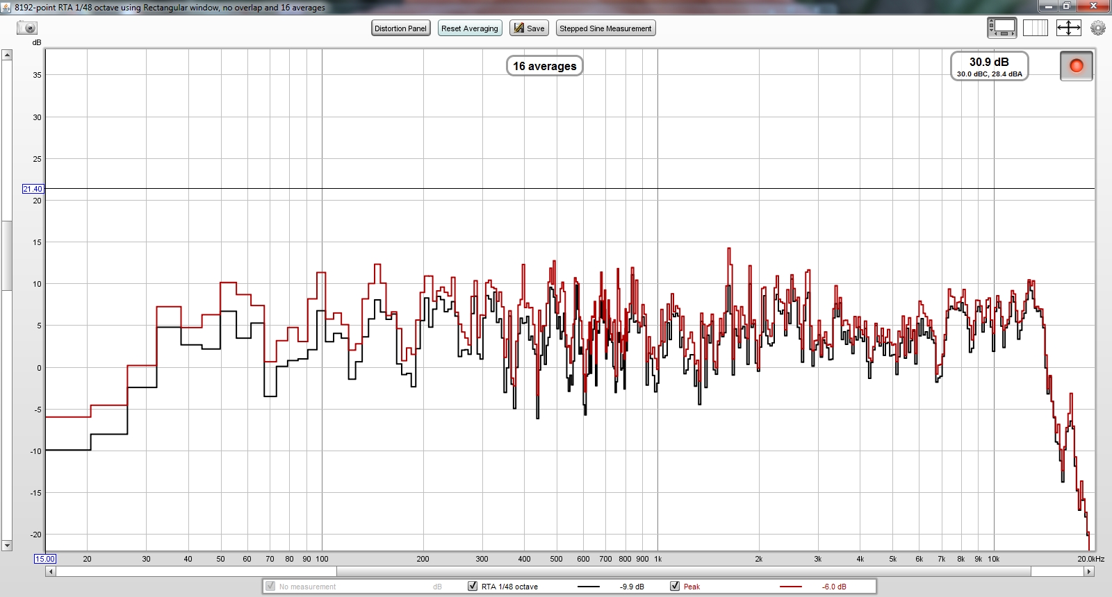

I was playing a 15 minute pink noise recording - with much liberty on Equalizer APO's 31 band EQ as needed to effect the responses shown. One with sub, one without.
Unsure if I can duplicate or come close to the EQ settings in Daphile, my convenient non-Windows player.
Thanks for looking!
