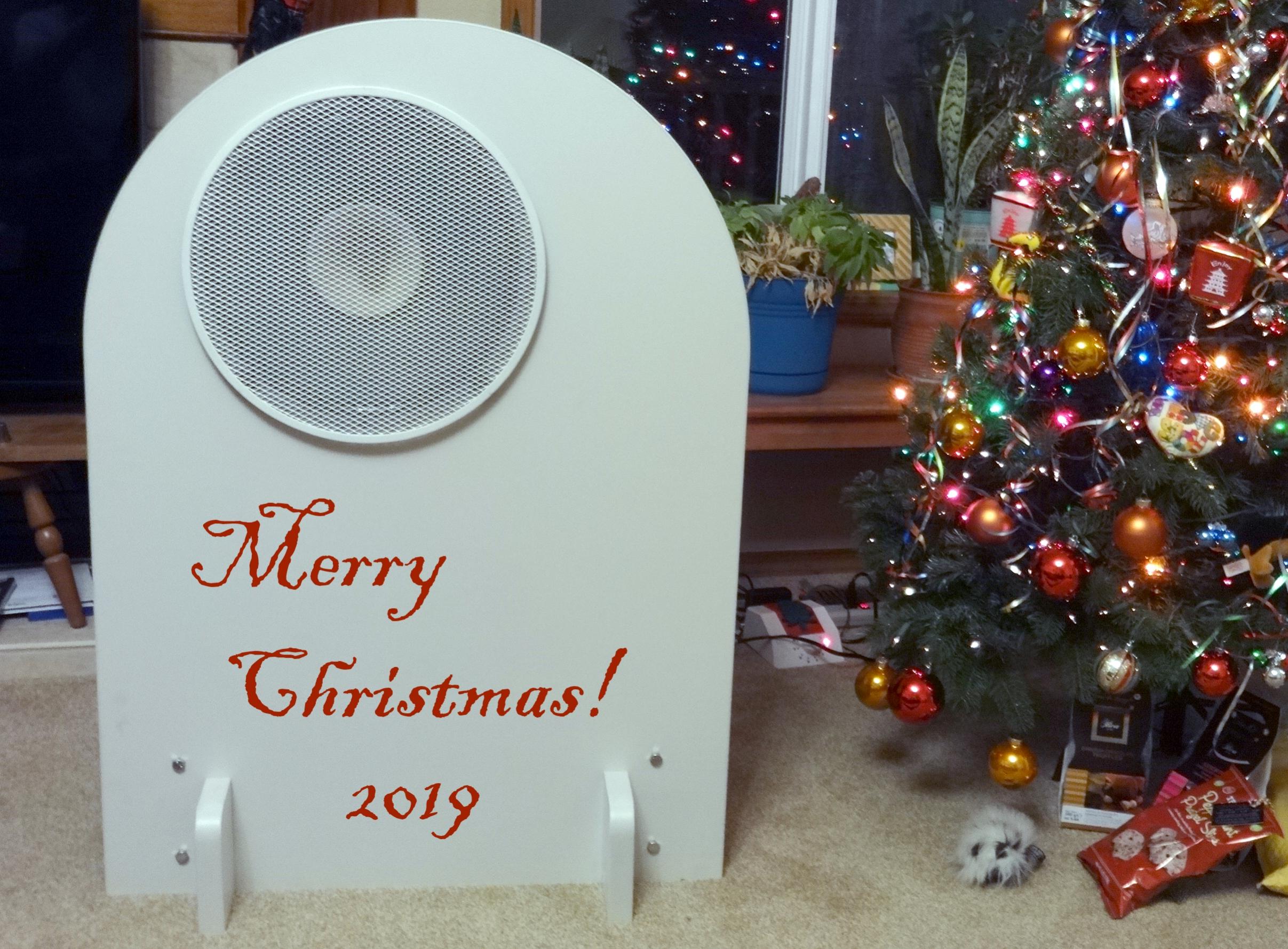

I tried to match the paint on my 16" pizza screens and came pretty close; the pic shows what they look like. The inanimate objects have been less than cooperative lately... Velcro backing not wanting to stick, etc.

I dont have any woodworking skills but i have access to all the tools in my university shop and the very knowledgeable shop technician who i am sure can guide me through anything.
my idea is to use those 3/4 inch MDF panels that home depot sells for ~15 bucks. they are 2 by 4 feet and then to use two 2 by 4 inch wood as feet.
I have these questions:
1 - should I have the panel straight i.e. 90 degrees from floor or should it be slanted? is 0.75 inch thich enough to support these drivers?
2 - the width of the panel is the next question. these MDF panels are 2 feet wide should I keep the whole 2 feet or should i make it smaller? the room that they will be used in is 25 by 30 and ~14 feet high ceiling?
3 - why do some people mount the drivers not in the middle of the panel? it is kind of ugly but i guess there is a good reason for it
4 - how high should the driver be mounted?
5 - any advice or things i shhould know?

3/4" is thick enough, keep the full width, there is a reason why the drivers are mounted off centre but I don't know the exact reason but I've found mounted in the middle to be ok. But maybe stick with the experts and mount to one side.I dont have any woodworking skills but i have access to all the tools in my university shop and the very knowledgeable shop technician who i am sure can guide me through anything.

I would slant them slightly back with supports behind not sticking out the front for a better look. It's so simple to do just get on with it and see what you think.

I would keep the panels the way they are unless you don't have the space or you want to give them the barrel shape.
I believe you'd get more bass if you lower them sligthly, in that case it can be interesting to slant them also otherwise they should be at ears level and slanting isn't nescessary.
@Dadbeh -
- They say putting a bass driver closer to the floor is preferable, as that allows for better "floor coupling" - where the room floor becomes part of the driver enclosure arrangement. However this trades off having a full range driver at or near ear level at a seated position.
With the F15, I've read the image can "float above" a lower, closer to the floor position, however I became spoiled by first listening to mine at ~ear level; now I'll give up the floor coupling to keep how they sound to me there. Everything's a compromise between competing attributes.
- Because the back wave from the speaker cancels the front, you should place the speaker such that the baffle distance front around to back is maximized. That would be centered. However, a symmetrical baffle placement effects smooth frequency response, so that's why you see the asymmetrical designs. Not maximizing the baffle distance front to back reduces bass extension. Again, everything's a compromise between competing attributes in choosing a design.
I read you can trick an asymmetrical placement into behaving more like a symmetrical one (bass-wise) by placing additional structures ("wings") at the back of the baffle to virtually extend the baffle width at the shorter driver to baffle distances. But, as in most such tricks, this only works so far before it introduces sound effects of its own. Another compromise. It's something I'm going to try with my arrangement, as I have the leftover materials.
I wonder how the small barrel shape baffle would sound with back side parenthetical wings around the driver; (O). You can tell my age when I try to construct visual representations using ASCII text!
If you can afford it ($15 vs $30), you could certainly double up on the MDF thickness wise, as it's well known the more stationary mass a driver has to "push against", the better the sound, particularly transient or what some call "fast" bass (different than FAST). Wing structures mounted to the back of the baffle will also increase the stationary mass and mechanical stiffness, which is a plus - unless you need to move them around a lot.
