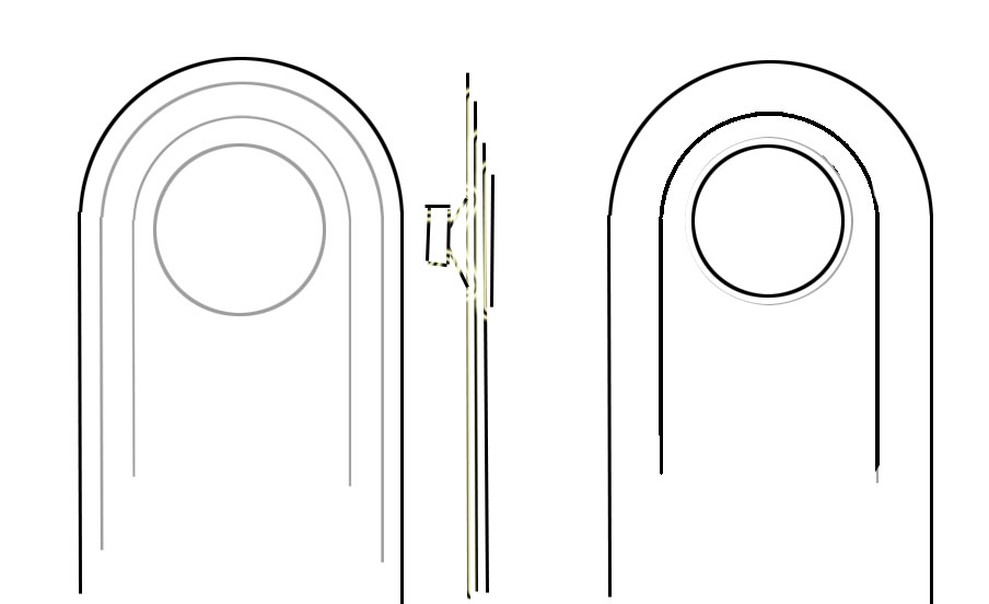

Since you have four, I suggest to make concentric shapes and use 4 layers for making the baffle in 3D. A picture would explain better...I'm hoping someone can suggest where to arrange the 15" driver cutout on the surface
Just make four figures and glue them to form a concentric and protruding shape.

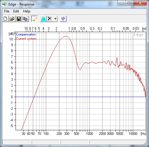

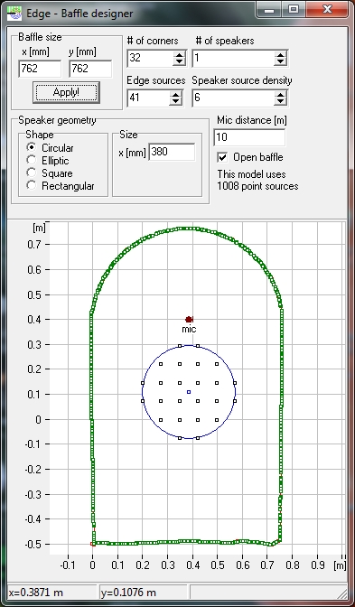

I gave the "edge" program a go, doing a couple of rough simulations just to see how its results correspond to driver positioning. This is with the baffle cut to ~50" and the semi-circle intact.
First, I placed the driver appx centered to produce a result. I assume bass is maximum here and diminishes as you move the driver towards any edge; please see the first two photos of my simulation.

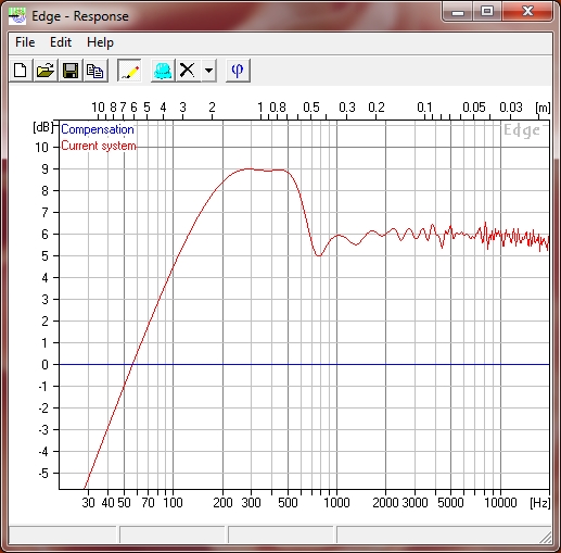

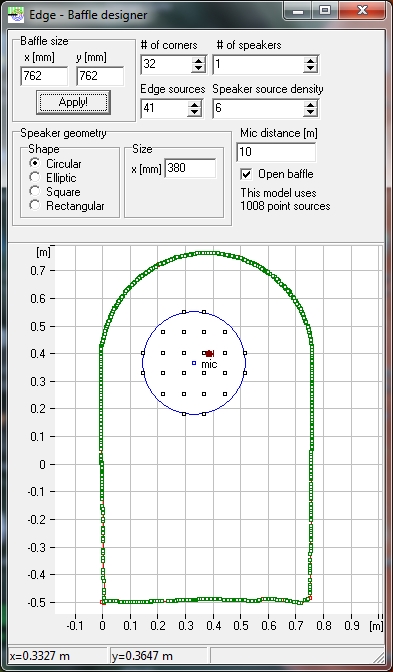

Then, I panned the driver position about the baffle surface to produce another frequency response output. Here about 0.5 db of bass is lost, due to moving away from the center of the structure. However to my eye, the resulting FR is "better". The second two screenshots show this new position.
Could someone please confirm that I'm using the program as intended? I ask because I also simulated the Wharfdale arrangement - a popular one by the looks of various OB photos I see - and the result is closer to my "centered" FR plot... There, I can also move the driver to what looks to me to be a better position. However I never see that position - nor any other - in these common arrangements; always the "stock" placement.
