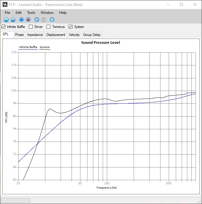

Sorry for the total noob question but I am an electronics guy not a speaker guy (yet)! 😎
My current speakers are modified Klipschorns. I have built several fullrange speakers in the past ... Fostex, Alpair 12p Pencils, Alpair 5 Frugel Horn Lites,etc. There is a clarity and imaging that fullrange speakers do that other speakers can't compare with. But, they don't dig deep enough for me to replace my behemoth corner horns.
The F15 looks promising but as stated in this thread, the Qts is a bit high for an enclosure. I used unibox to model the enclosure they have on their website but the F3 is only ~40Hz with only a 1.5db spike. I e-mailed them and asked if they had any measured data on that enclosure and they do not yet I see a lot of F15's in bass reflex cabinets on their website.
I was wondering if maybe a MLTL enclosure would be able to go a little deeper? Unfortunately the programs for those are unobtanium and/or over my head so I have not simulated that yet. Just wondering if the rules for MLTL and Qts were the same as bass reflex since they are very similar.
Also forgot to add that OB is out because my room is small at 12' x 14' and I listen across the 12' direction. That and lack of bass would not satisfy me. I also need high efficiency as I run a 45 SET.

I've been playing around with LATL software and started with 4*Sd area for s straight MLTL. Ended up with a 1.5m tall cabinet! Looked for an off-the-shelf port (6" Parts Express) that keeps velocity below 10m/s. I am able to get the box pretty low! What do you think? Or is this too much of a peak at the port SPL?
I know ... this is a HUGE cabinet! 😀
