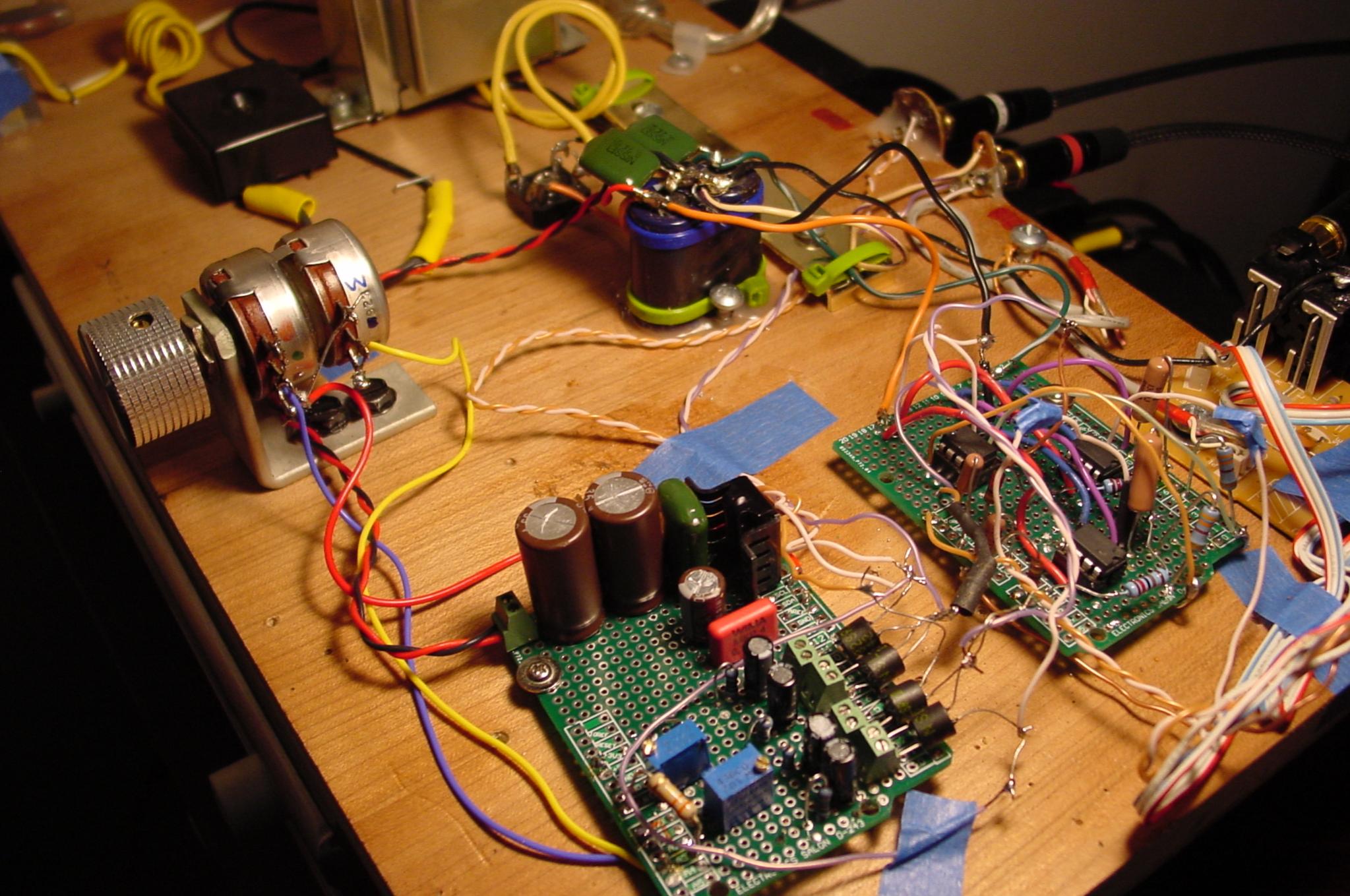

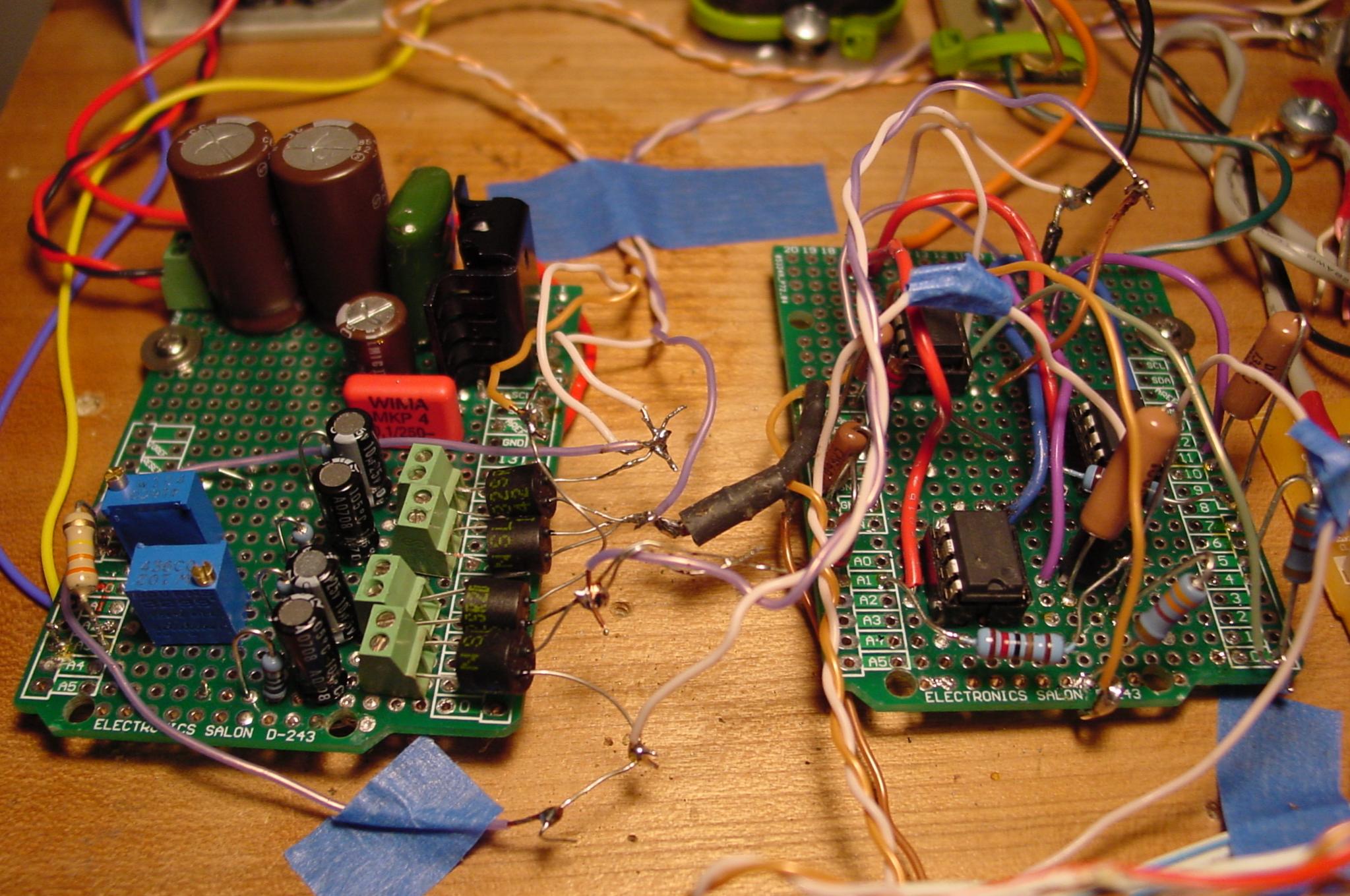

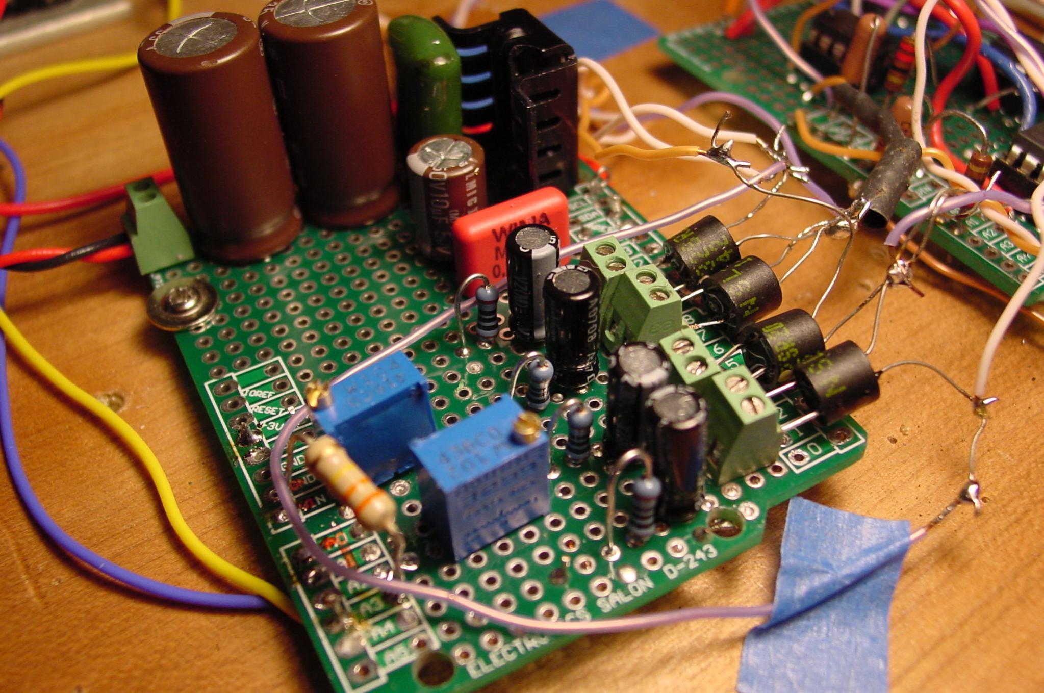

Finally after it would seem way too many tries, I have balanced channels. Even though I bought the sorted LDRs, they were quite off from each other. I had to use a 330K resistor in front of the signal LDRs LED power supply to bring things down to a usable audio level. There was just too much gain too early. Also, a 100K Bourns pot was necessary to bring the loud channel even--though little of the 100K is being used, but much more than 1K. This is even after matching the LDRs as close as possible.
Wow! The outcome is amazing. I have been listening and unable to turn it off. All kinds of new layers come through that I have never heard before. Not all are music. Some are spatial. Peter Frampton Live "Do you feel like we do" sounded like you were in the arena yourself. The electronic solo floated in the center.
Thanks George for such innovation, it has great returns for those that try it.
Here is the breadboard, you see the evidence of many trials. A proper case and clean up is coming.

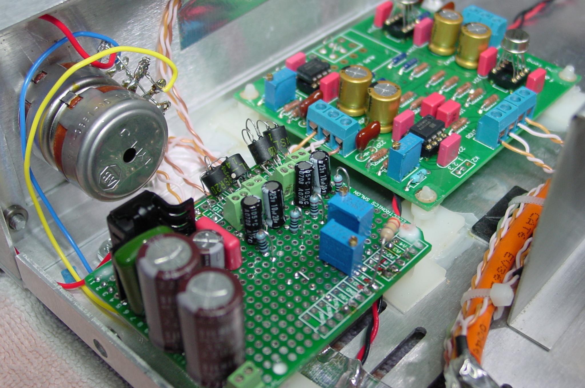

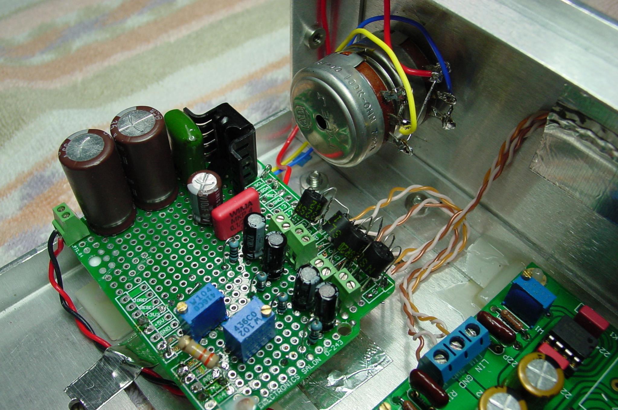

I did not want to leave you thinking that the piece of scrap board pictured earlier was worthy of the the Lightspeed, so here is it in its pre and chassis. An LME49720 op amp based preamplifier with OPA 2134 phono stage. 100K pot from military electronic surplus in Florida. Very stout and precise.
As for the caps discussion, .33 uF at the entry of the 7805 regulator, .1 uF at the output of the reg. and 220 uF elna Silmics at entry, and 100 uF after, then 10 uF at the legs of the LEDs. Voltage to LDR system 4.94 VDC.
You can see this in the picture. How does it sound? I don't have the audiophile lingo to describe how good it is...absolutely zero background noise. There is extra bass to boot, wonderful.
