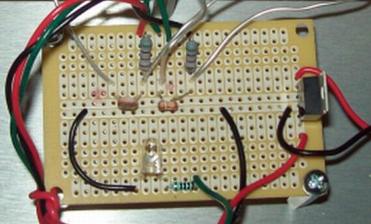

Or this one, another clone piece of crap, advertised as being new and superior, around the traps, one of my customers got it on loan from the maker and took this shot of the guts.
One can clearly see it's just bad a clone of a MkI Lightspeed Attenuator using series resistors and shunt really cheap LDR's.

Today i've tested the LDR and with potentiometre @minimum still have some music, is not totally quiet. What i did wrong ?
I followed this article to build it DIY Lightspeed Attenuator - Passive LDR Volume Control (optocouplers)
Still is an audible enhancement over previous Alps pot.
The amplifier is a MyRef C also fresh finished project.
Hi Autpi, glad you've also discovered the magic the Lightspeed can give.
As the circuit is posted by me, it is correct, the Lightspeed Attenuator will not go to complete silence it does have a very small amount of sound at min volume that can be just heard.
As the series LDR cannot go complete open circuit when no led light present and the shunt LDR cannot go complete close circuit when the led light is at it's brightest.
You could use your source pause or stop button if you need complete silence. Or you could make a mute switching arrangement that's be done somewhere in these pages.
