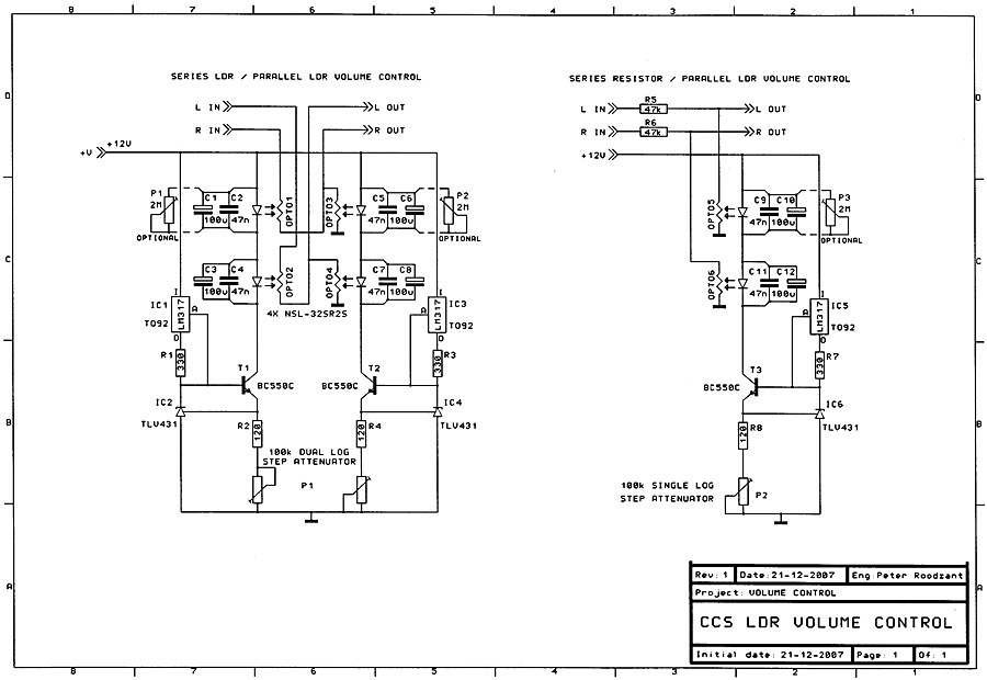

Carlmart, I do not know who posted that and have not tried it.

Carlmart,
Guessing that this guy posted.. well didnt post but came up with it anyway.
http://www.diyaudio.com/forums/members/peter-roodzant.html

Carl,
That was one of the first designs using a CCS - Peitjers designed this one a few years ago and you can find details about the operation on post #1000. I built one of the Series LDR/shunt LDR ones (George's MkII) complete with the caps across the Leds and one of those cheap china stepped SMD vol controls instead of a pots - works like a charm.
ZenMod developed a similar version with some refinements in the Poor Man's Serbian .... with the k170/j74 jfet buffers, not the B1 cct.
Maximus, Uriah, Blues, also use CCS's to drive the Leds in different ways - different results, but all very good sounding devices, just like the original.
A timely reminder for anyone soldering these devices that they are quite sensitive to over heating so either be quick, or use some of those cheap heat-sink clips - this has been mentioned quite a bit, and is worth repeating.

The circuit I posted up a month or so ago has as far as I know never been tried out by me or anyone here
As I will be beginning a project to work as 6-channel control system, I wonder how would you handle the remote level setting and input switching.Doing 6 channels will be will be fun for you to do the matching, I wish you all good sanity if you manage it.
As for the remote level and switching control circuits there are many on Ebay you modify that can be used personally. Here is one, at these prices you could buy three to get your six channels, manually set the level for each pair and then use one remote as the master for all three. You will get 12 inputs if you want, the relays would take the place of the LDR selector switch on the circuit I posted, a month ago.
