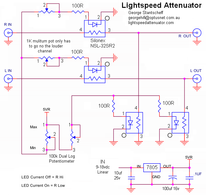

Thanks Geoff, here is a circuit you can follow, it's the production version MkII, and also the purist version, the supply shown is just as good as pure battery power, so no need to good any more exotic with it.
And if you want, you use two single 100k log pots instead of a dual, then that way you have balance (dual mono) for awkward shaped rooms or unbalanced systems.

George, many thanks for the circuit. I will build two separate mono units, since they will be located each on their own loudspeaker. This means that I am not too worried about matching!
I'm now thinking about a similar solution to the selector switch problem - do you have any experience? (I've been unable to play anything but vinyl since soldering in my source to get the sound quality - a shame since I have a Nak tape deck and a Leak tuner standing dumb!)
Best regards

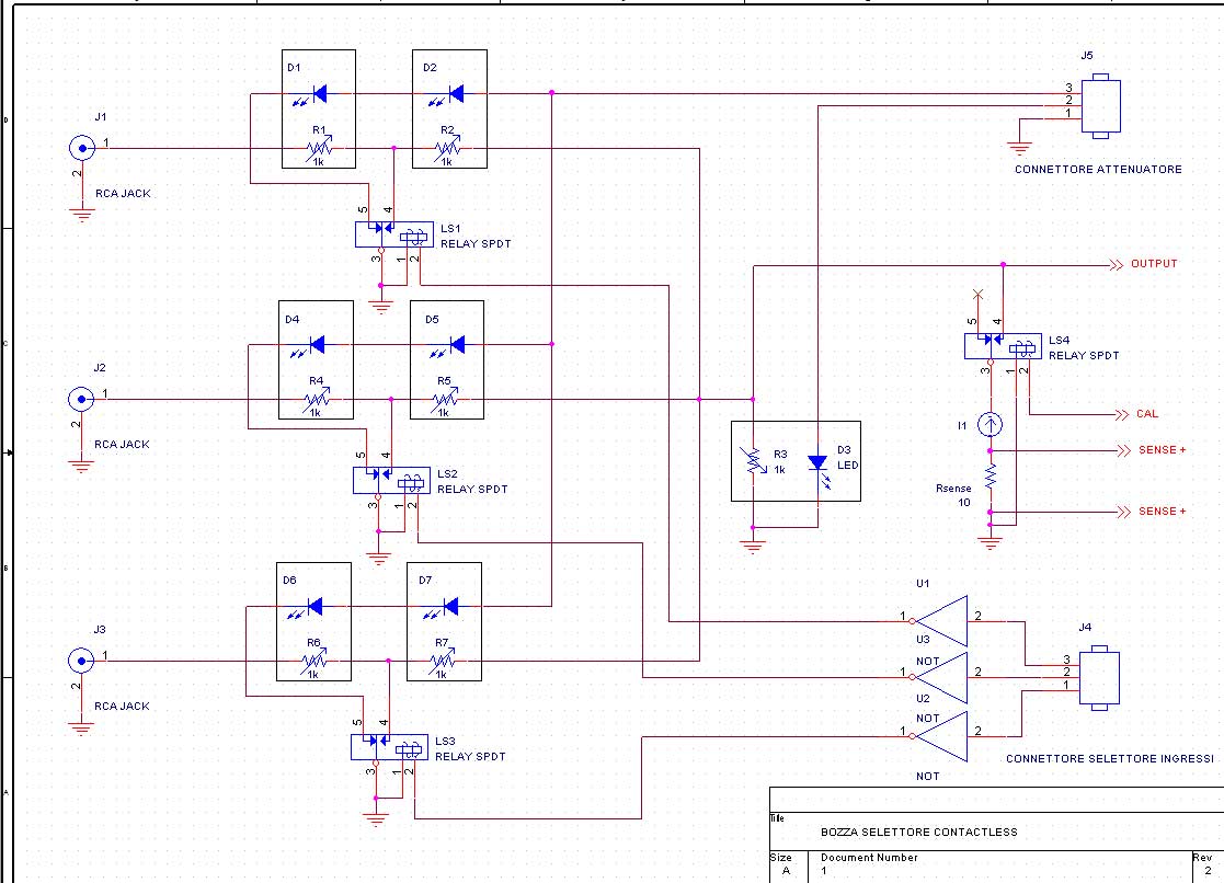

Here is one I have on file, 3 inputs, but it needs a few ldr's, but not impossible.

why 2 series ldrs?
Hi Andrew, yeah simple in theory, and automatically shorts out the two unused inputs, but what a nightmare to match up the 14 ldr's for stereo use, wouldn't wish it on my worse enemy. Why can't somebody make the perfectly consistent ldr's. Suppose then I'd be out of business.

George,
A quick question: why are 2 series LDRs needed with the muting relay? I'd think you could just put the relay to gnd after or before the (one) series LDR.

I built one recently that has 4 sources to select from and one set of outputs. No matching necessary. The setup is like in the schematic you showed George. I suppose general matching is necessary to make sure you dont get a bum LDR. But I just match at one point around 250R to make sure they are in general vicinity of each other. Then transistors turn them ON/OFF and if I use a trimmer with power to wiper of trimmer then from A and B of trimmer to the base of transistors .... I can balance the LDRs out til they match. I use an optocoupler to ground. Not an LDR but basically a transistor to ground between the two LDRs. It works great on the bench but right now I am getting about 600R in series. I need to tweak the value of the resistor that is in series with A or B to the transistor base and I will get the 40R or so that I am looking for. I think it will work very well. Jon Ver Halen gave me the idea a year and half or two back. I need to remember to send him a board when I get it finalized.
I recently have been listening to an input switcher by John Chapman of Bent Audio. It uses relays. Fantastic sound! Holy Smokes! Way better than others I have listened to like those red boards/blue relays on Ebay. Dont know what is so special about the relays he uses but hoping that I can get even better results with this little setup.
So guys, you can simply use a few pots to balance out your two channels if you want to use LDRs for input switching. Very possible. However, George is right.. You dont want to use just one LDR per channel. You must use two and the relay or however you send signal to ground must be between the two LDRs or else you will short a preamp to ground or you will mute your amp when you try to select another input. The dual LDR solution isolates the amp from any other sources and keeps a huge amount of resistance on either side of whatever solution you use to ground which also keeps your source from shorting to ground. Probably your source would be okay shorted to ground if its output is a decent opamp as they are often rated for continuous short but you cant count on it.
Another solution I have been thinking is like this..
A source sends signal and the LDR is ON so signal (this is with just one LDR) passes to the amp. When we want to turn that source off the LDR goes dark and the signal has the opportunity to pass through a 50R, or so, resistor to a relay to ground. We get rid of the cost of one LDR and the regular resistor is only in the signal when the relay is ON which is when you dont want to listen to that source anyway. This way does not 100% attenuate the signal but man it wont be something you will hear. When the signal has a chance to go through 50R to ground or 20MegOhms.... how much do you think is passing to the amp?! Still, dual LDR is probably best solution. I need to get in the workshop and get my series resistance down to 80R, then I will be happy 🙂
