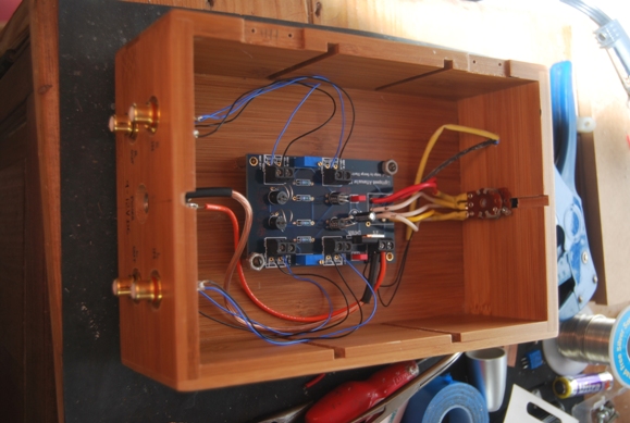

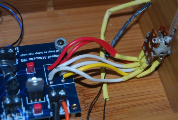

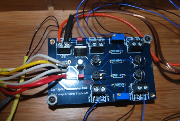

Hi All, I have just completed my second LS, no1 suffered from destroyed LDR´s when soldering. I then destroyed circuit board trying to change them, AHEM. The latest one I took great care with to ensure that it did not suffer the same fate. But, The sound is there in the background, very low, no matter where the volume is set, when I move the pot there is no change. any help with this would be much appreciated.
I believe you have wired the potentiometer incorrectly. When you correct it you will have volume and volume control.
Remember, 5V goes to the connection between the two gangs of the pot. Then remember that on each gang two of the pins must be shorted together.
I think I should stress that 5V must go to where the two gangs meet.
Uriah
Uriah
CLN put your DMM on the long leads of the LDRs and see if they have ANY resistance. What resistance do you get? Turn the pot. Does it change?
Have you verified if you have 0V and 5V going to the right sides of the power input terminal?
Does your wallwart in fact output DC?
U, No resistance recorded on long leads of all LDR´s No change when pot is turned. My power supply is putting a regulated 6.8VDC into the power input terminal.
Colin.
Colin.
what kinda sound you hearing in the background? Is it noise OR a whisper when the pot is set to minimum.....I'm using the same setup without any problem...
Hi, Thanks for your reply. I can hear the music at very low level, it does not alter with the volume pot.
Colin.
Colin.
CLN if no resistance is recorded then something is direly (is that a word? ) wrong, which obviously is obvious to you.
Whats wrong I dont know. I dont have that board and cant figure out why you have no reading, which means zero power, from the LDRs. No power is getting to them. Do you have a solder blob somewhere shorting ground to positive? Maybe a pick underneath.
Uriah
Uriah
Thanks for that, I did check everything but obviously not as close as I should have, I will re-check again and report.
Colin.
Colin.
Having checked the underside of the board I cant see anything that would cause the problem. This may sound really stupid but I just have to ask, on the diagram for the board I noticed that where the connector blocks sit that all the circuit runs are on the inside except the actual power which appears to be the circuit runs on the outside of the board, if this is true then this would explain why I have no power.Colin.
That would explain it if the outside two connections are not in fact continued through to the inside connections of the board, if you follow me. Colin.
