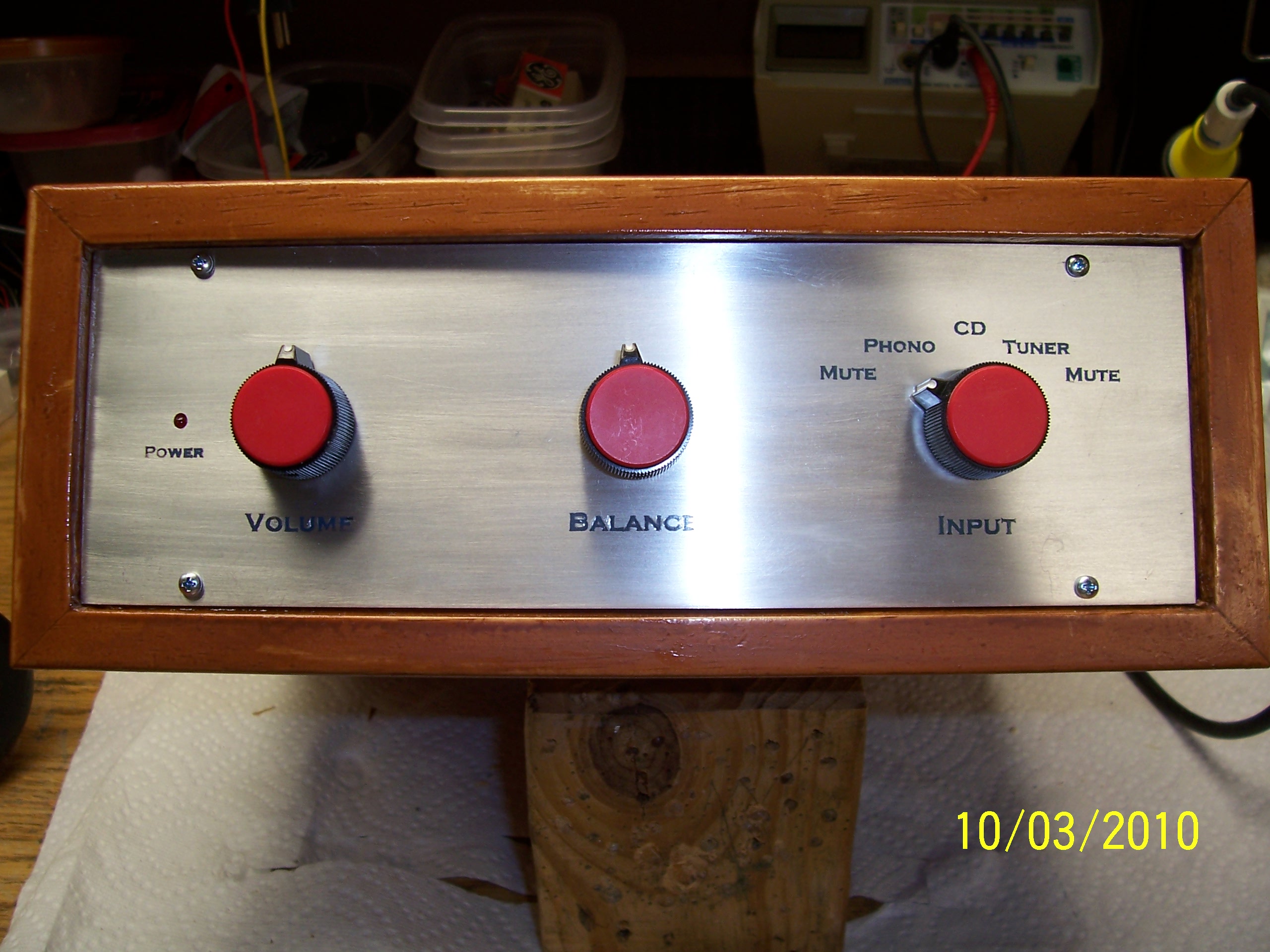

I'm not all that pleased with the cosmetics. I'll use better wood next time, do a better job of staining, and hopefully print lettering better on the faceplate.
But, except for replacing those hideous Radio Shack knobs, at last my LDR attenuator is done.

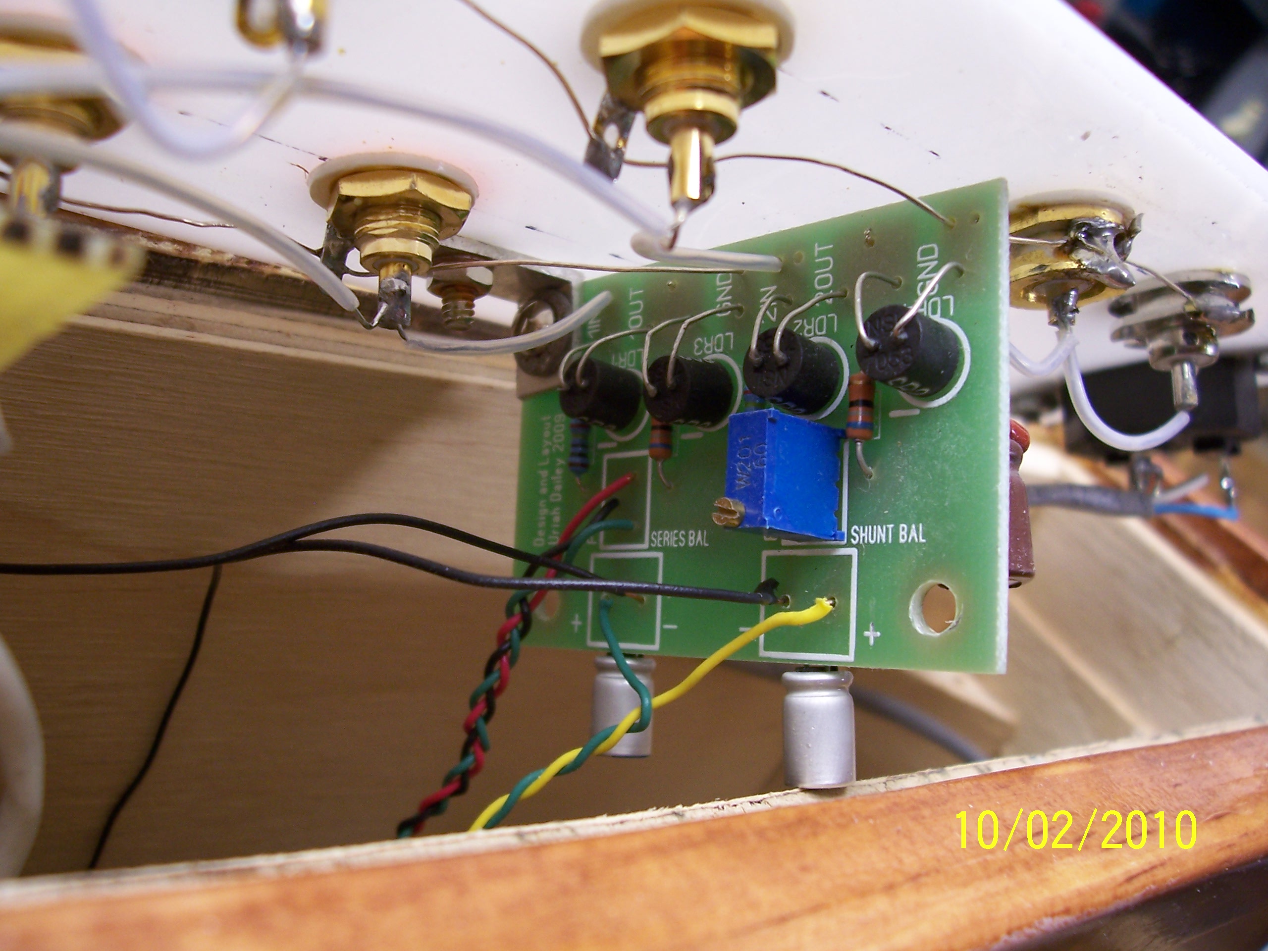

When I read this, I knew I had to try it out. Unfortunately, I'm cheap, so I used a bit of what I had on hand. Having heard it now, I wish I had used all premium stuff, mainly Cardas Rhodium connectors (I only had two) instead of the assortment of cheapie Cardas and Connex WBT ripoffs.

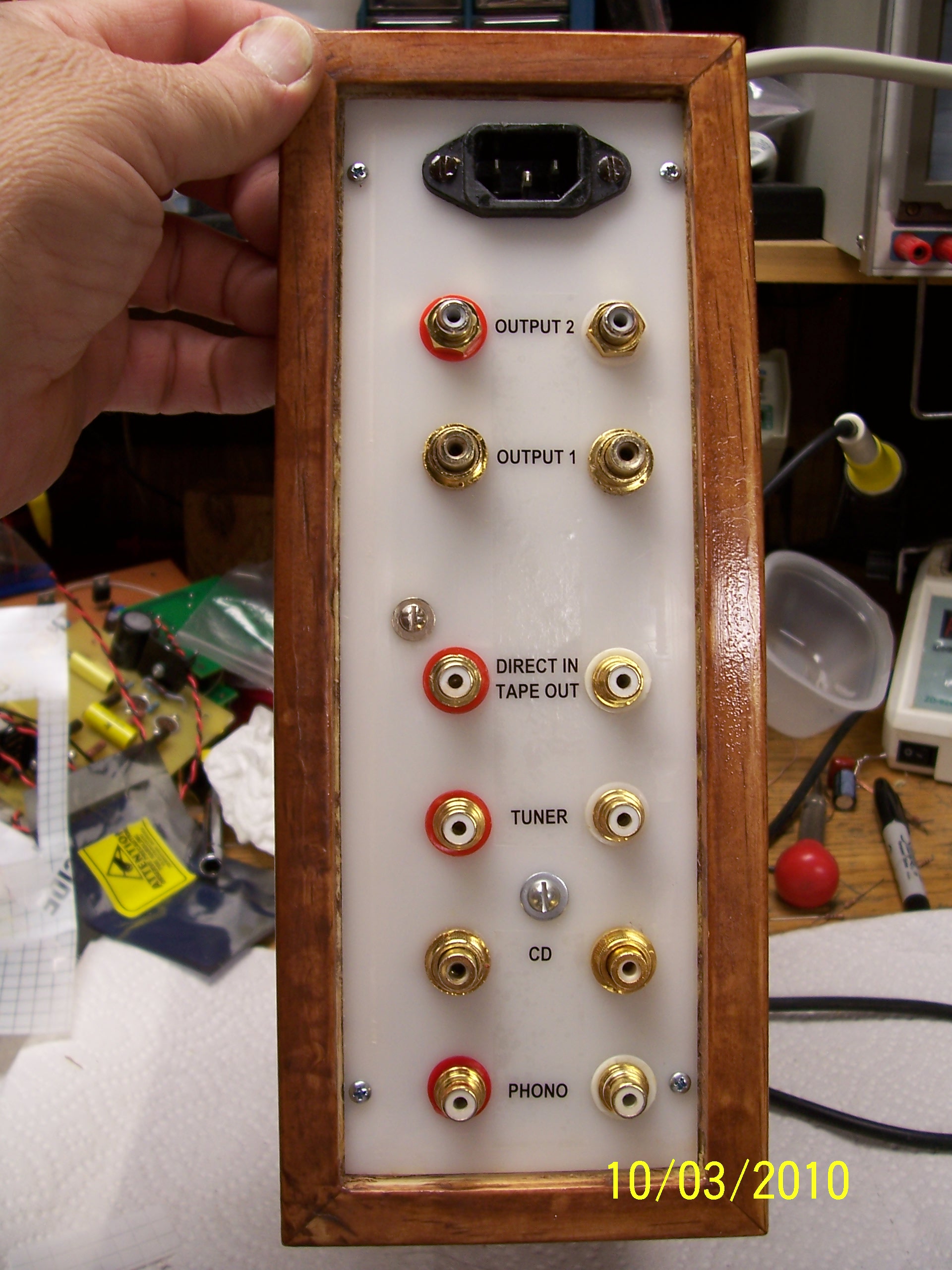

I have more than one source, so a selector was critical for me. I used SIP reed relays, 5V, with a separate 7805 regulator to keep any transients off the line to the LDRs. The reed relays on FR-4 perf board, interconnect via silver wire from Handmade, with Teflon sleeving as needed. There is a versatile input/output point, sort of like a tape out, connected to the relay output. This serves as either a direct input, bypassing the relays, or an unbuffered output for taping or input to another attenuator (for comparisons). The input selector has "mute" positions where no relay is selected. In one of these positions, the direct input has no more than a couple inches' uninsulated silver wire hanging off of it, which certainly shouldn't affect the sound. This gives the opportunity to use the circuit as George intended, with no selector or contacts in the way.

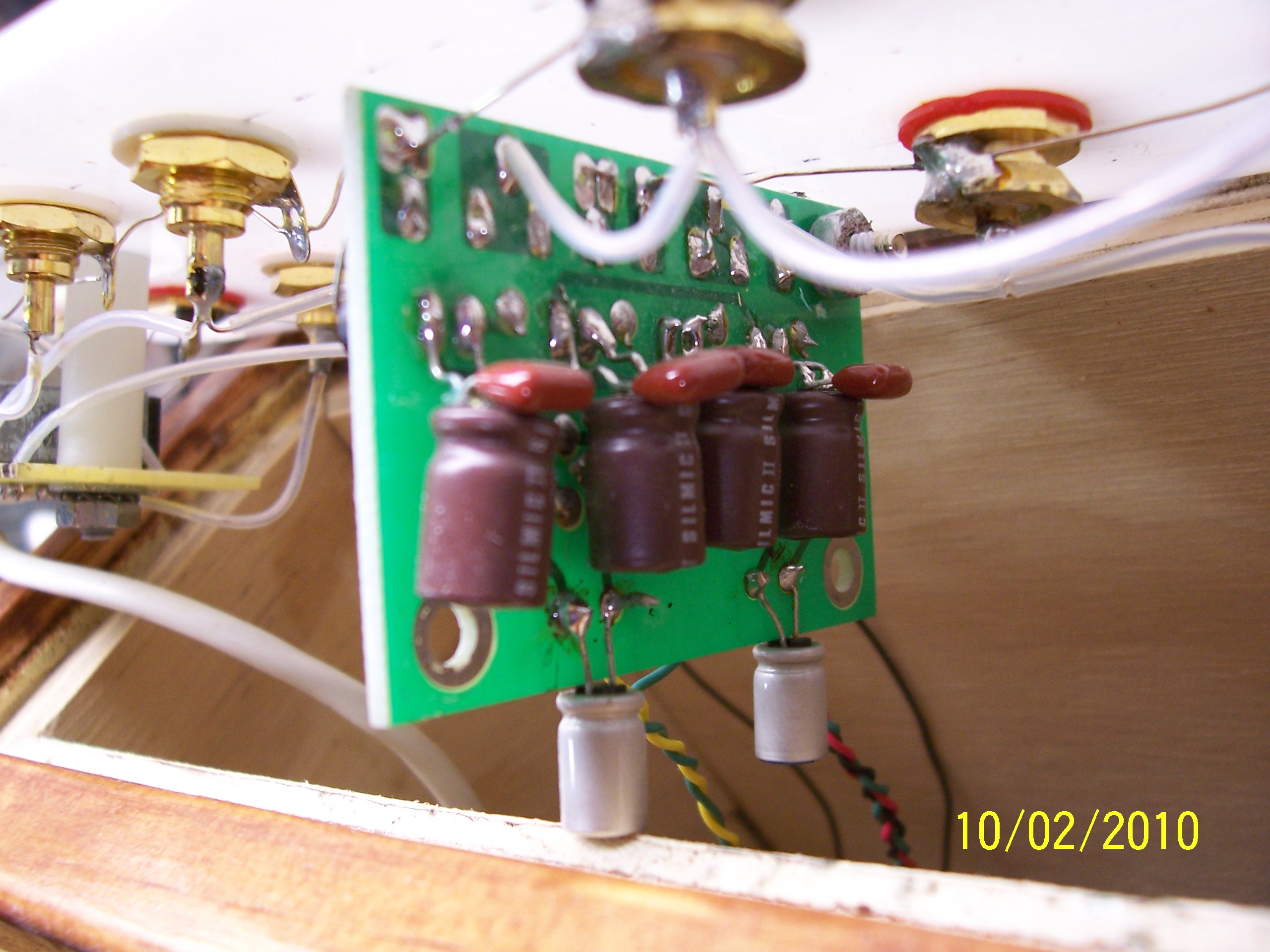

I used a transformer I had on hand. Schottky diodes, big capacitance, and a common mode choke in the raw supply. Then I configured an LM317 as a current source, followed by a shunt regulator made of a TL431/PNP and a shunt cap of an Elma Silmic. I also used two small 150uF solid polymer electrolytics across the leads from the power supply to Uriah's LDR board. I followed that with a Silmic/film cap combination right across the leads to the LED of each of the LDRs.
The back plate, mounting all of the signal wiring, is Delrin. You can never use enough Delrin. Nice sounding material.

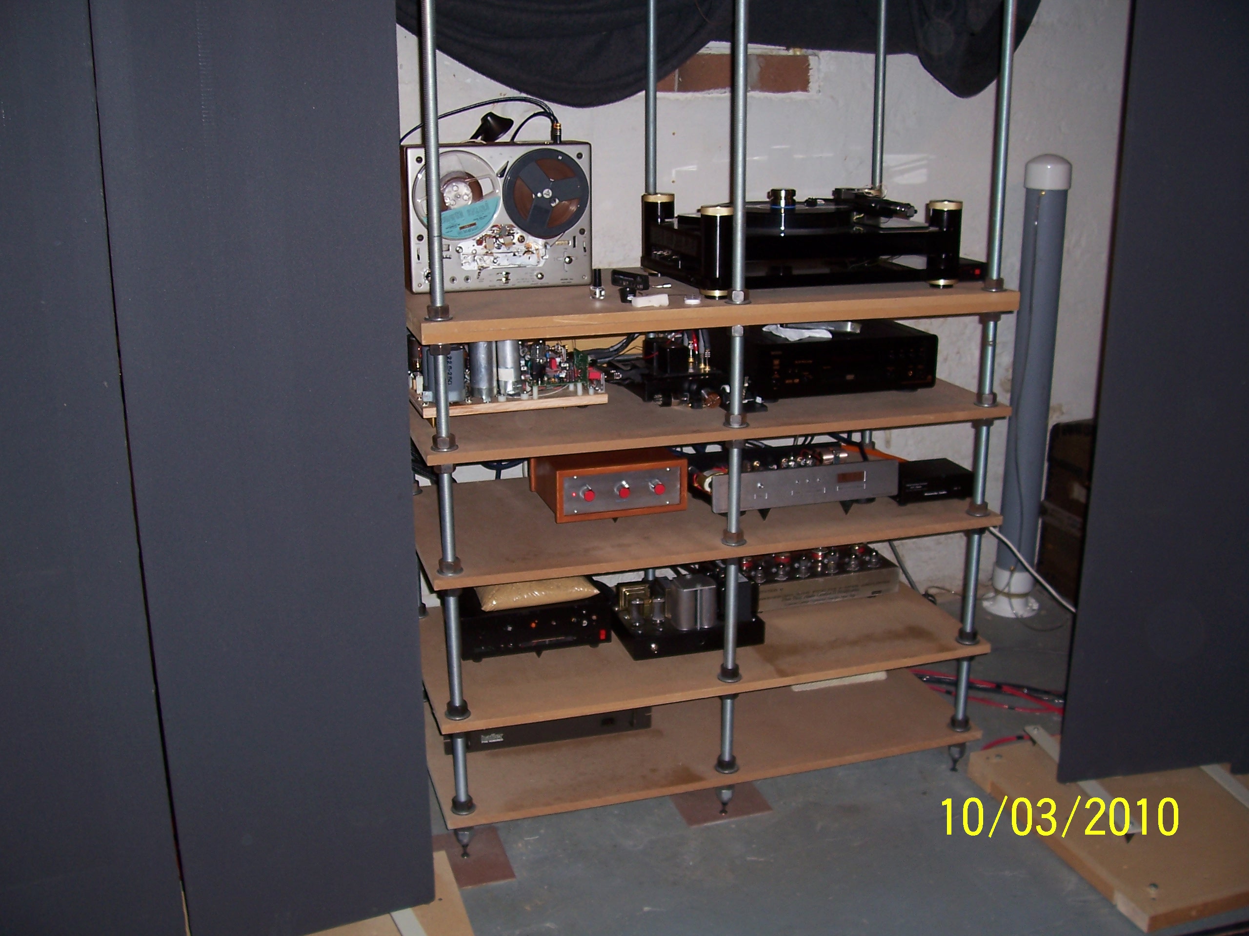

So far I've compared it to my old stepped attenuator, Beta Follower line stage and two superb sounding passives, both using TWO P&G 20k stereo pots. One is a DIY preamp, built in Bubinga wood, using Kimber wiring, Shallco selector, etc. The other is from Savant Audio, built in a one-piece solid machined block of Delrin (!!!) and using at least four pieces of Cardas Litz wire per terminal!!! The two stereo pots have their sections paralleled together, making each a mono 10k pot, but with two wipers.
My "Lightspeed" copy sounded far and away better than the DIY
P&G preamp (although it looks so much better). But the Savant was another story. Bass was equal between the two, midrange was full, solid and I think, better in the "Lightspeed". But, the treble was a little better detailed in the Savant preamp. Not much mind you, but a little more "air", you could tell how much pressure the drummer was putting on a brush on a cymbal, for instance.
For me, my passive was a winner, but the owner of the Savant preferred his because of the slightly better resolution. Still, in his words, there are bigger differences in swapping brands of output tubes.
The LDR preamp is a winner. For everyone who's read this and not yet built or bought one:

I think its a fantastic and well thought out build. If you want some nice knobs check the swap meet. Luvdunhill has some knobs for sale. Trust me they will be inexpensive and he is a very nice guy.
Do you get a little delay in volume change with the caps across the power inputs? I did on mine but the caps on the LEDs worked great.

Very little delay in volume changes or balance changes, sort of like smoothing the motion of the post after you move it. No problem at all.

What value caps do they put across the LEDs? Are they using the PETP caps in conjunction with a big electrolytic, or by themselves?

I think he has 100uf BiPolar Nichicons and a .1uf Russion K73-16 across each.
