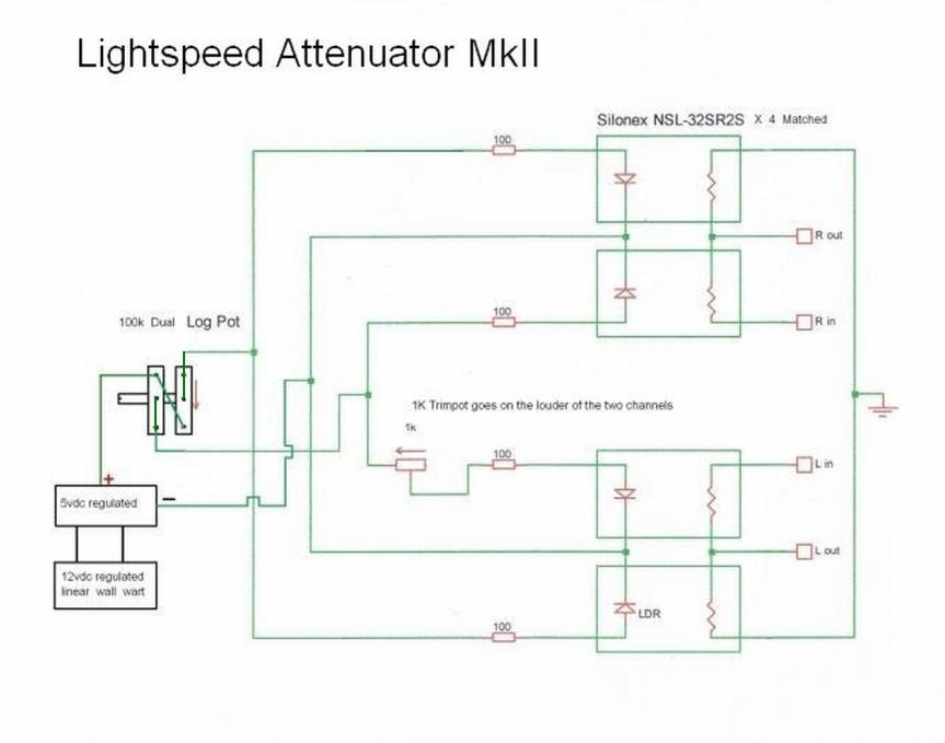

I've played with every concievable passive pot, Bournes, Alps Blue Velvet, Alps Black Beauty, Penny&Giles, Dact Switched resistors, and transformers.
Nothing has beat the sound of a series/ shunt LDR arrangment in the attachement, it has no contacts in the signal path, I believe that is the secret.
The only stipulation that all these passive controls including the series/shunt LDR need I believe is,
1: Low source impedence (cd player) <200ohms
2: High input impedence (amplifier) > 50k.
Cheers George

I think its your grounding. However if its not your grounding, your supply looks fine. Maybe you have a cold solder joint or such. It is very possible that the noise comes from the wall wart. Try a 9V battery. Use alligator clips. Clip it to the rails right after that 7810. Maybe the noise goes away. If not, make sure you dont have the signal ground and earth ground mixed in the lightspeed and never connect signal gnd to the 0V.

Hi George,
I am using the light speed MK II version. The supply circuit is based on uA7810 & uA7805. It is feed from a simple 12V DC wall wart adapter.
Best regards,
Bins.
I use a 470uf before the 7805 the a 100uf after then a .1uf . I do not earth the neg rail to signal ground, it floats with the neg of the wall wart.
Cheers George

Hi George,
Best regards,
Bins.
I would dump the 7810. It is not needed. Indeed, it probably needs more headroom than the 12V input, which may be the problem. If you want to use both then find a 14V+ wall-wart. The 7805 works fine w/ 12V input.

Hi George,
The negative side of the supply is not earthed as shown in the supply schematic which was posted earlier. It is actually connected to the DC supply socket's outer terminal. So, I think the light speed ground is the place to check for the noise issues:
1. RF Interference - Can this be avoided using aluminium shield around the LDR's (The shield will also be connected to the LDR's common ground point) ?
2. Ground - Can I take the RCA ground's to a final earth point and ground it explicitly ?
3. Cold Joints.
Best regards,
Bins.
I wouldn't think so. I'd say it's more the wooden case.
Also try not earthing the negative side of the supply, let it float.
Cheers George

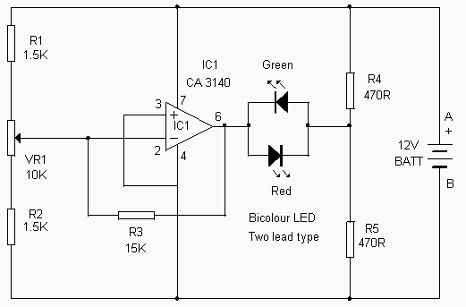

I am going to use the 12V rechargeable cell to drive my light speed (Feels like being in a classical Nagra world with battery packs). I have found a simple circuit to use with the battery section to indicate the state of the charge remaining (Green -> Fully charged; No Color -> Neutral; Red -> Low Battery)
