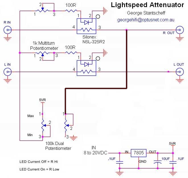

I am using 3 LDRs at each position right now. Well until yesterday with I removed one each from Shunt. I dont hear a sonic benefit. Maybe maybe a bit richer but I have to AB it some more to be sure. Unsure about THD.
Never tried or heard of anyone trying what you are talking about for control.
BTW I guess Dartzeel uses some 100 LDR per channel .
Uriah
Trouble being you'll need one pot for the series ldr DC voltage control and then another pot for the shunt pot to earth. How will you logarithmically control the two and keep channel balance at the same time.
It will become even more user unfriendly than my production Lightspeed Attenuator is that has separate L & R volume controls, which is an option that some customers buy (because they have system imbalances) But is a pain to use, just like the Audible Illusions 3a Preamp I used to have.
Cheers George
Cheers George
Thanks for the replies George & Uriah,
How about a tri or quad pot?
One group for the LDR's and two others for shunts? I'm thinking the shunt isn't as critical and might be fine with regular pot instead of LDR's. Plus, no matching and can go to 100K.
Of course if it doesn't sound as good then no point...
If the shunt arent matched really well this will throw your balance from Left to Right off more dramatically at regular listening than if your series are not as well matched. Its the math that screws it up.
I am not saying dont do it. It would be fun and educational. Then you could remove to gangs of the pot and just run matched shunts with the second gang and see what the difference is. If you are prone to experiment this might be fun. If you just want the best sound and no confusion and consternation go with matched quads.

Your'e right. A remote is a nice way to go. Maximus has developed a remote and power supply for the Lightspeed circuit. No its not already built but it sure is high quality.
The switching wont work as you have envisioned. LDRs go to about 50 Ohms minimum. Lower than that is not to healthy for them. To slam one on to 50Ohms to ground wont drop your min volume to anything like minimum when you want to listen to a different source. So you would have to parallel a lot of LDRs to act as one to get down to just a few ohms or use a relay to ground.

Uriah,
I understand that the shunt LDR's resistance cant/doesn't go to zero and will pass some signal BUT I'm also suggesting another LDR, say a -32SR3 in series after the shunt. When turned off, the spec sheet says it presents a resistance around 25M ohms, so with the two LDR's we now have a "potentiometer" with the "gain" turned all the way down. Opposite happens when you switch the LDR's in the other direction - signal sees no shunting resistance and only 60 ohms or so series R. OR am I missing something here
Charles
Most of the SR2 go that low to. My bet is that most of the SR3 are actually the same thing. Just that they are confirmed to go that low. Anyway I could be wrong.
What you said and what George said both make a lot of sense and given that the relays work the way George mentions I dont see why it couldnt work. Its a good idea and I hope you build and post here about your build.
Uriah
