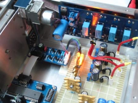

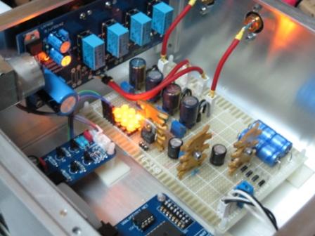

Looks amazing - what are all those bits inside?tHE iNSIDE.....
Alan
