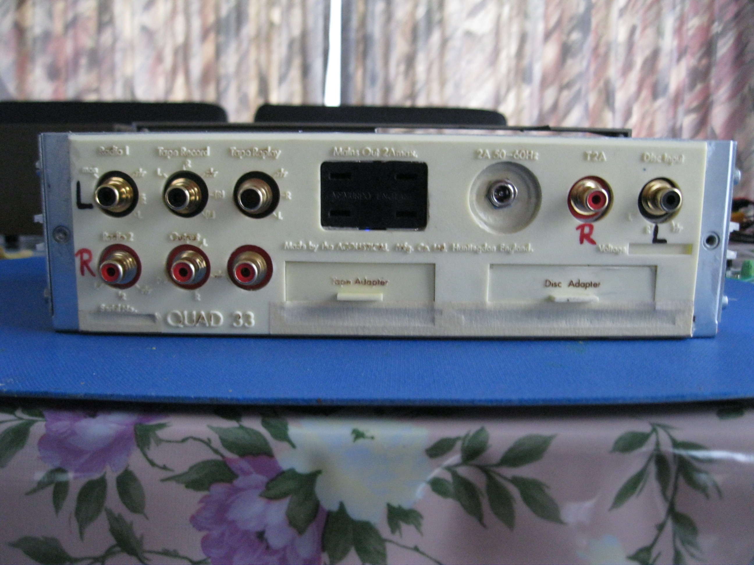

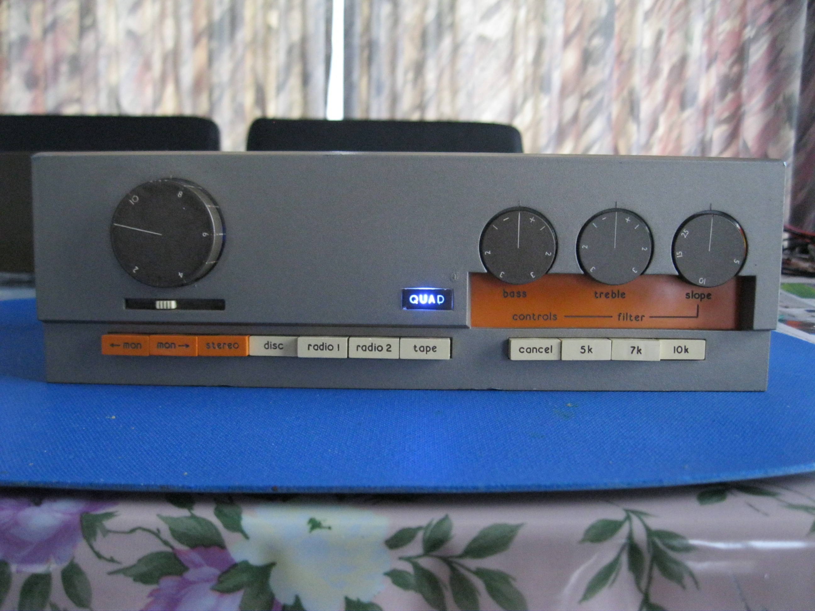

I have attached pictures of the converted Quad 33. I modified the rear panel to accept RCA plugs. I opted for a 3 input LDR board as I listen CD's and the radio. So, on the rear panel there are 3 pairs of RCA input sockets and 1 pair of RCA output sockets. Next to the output sockets is a socket used to plug a DC power block into for recharging the12 volt battery inside the chassis.
On the front panel, an LED battery indicator is used where the "Quad" light originally appeared. The red LED continues to shine until the time the battery needs recharging, when it then changes to blue. The charging circuit is activated by pressing the "cancel" switch. To deactivate charging and return the preamp back to use, the "10K" switch is pressed. The "disc","radio1" and "radio2" switches are used for the inputs.
I carried out the mechanical alterations, whilst Chris provided the necessary circuits. He also checked the conversion when it was completed to make sure everything was in order.
It's been an amazing project with fantastic results. I couldn't be happier. The music from my hi-fi system is the best it has ever sounded and this is in no small way due to the Stereo Coffee preamp. It's a top quality product and it"s been a pleasure to have met Chris who is a really lovely guy and was always on hand to assist.

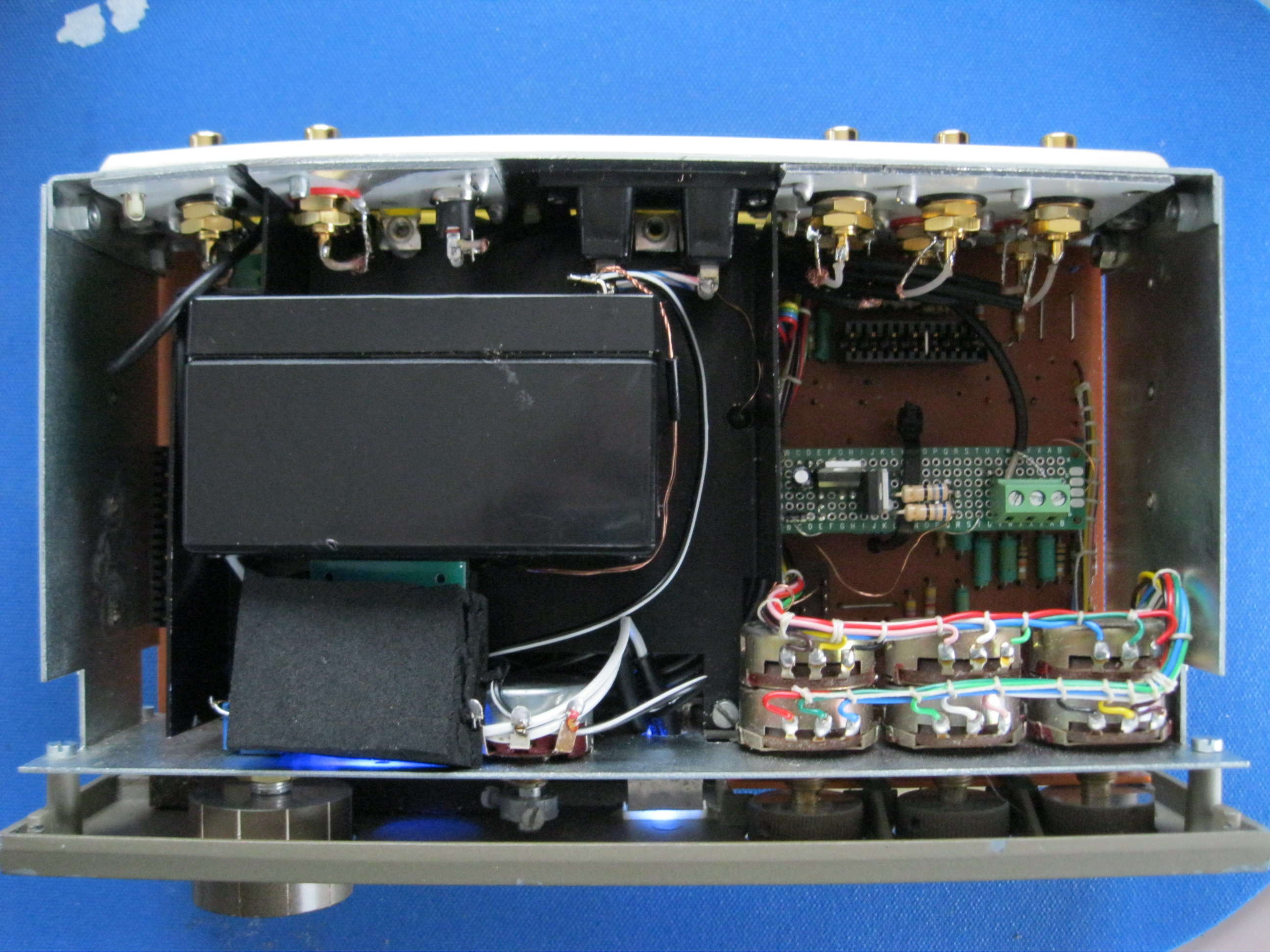

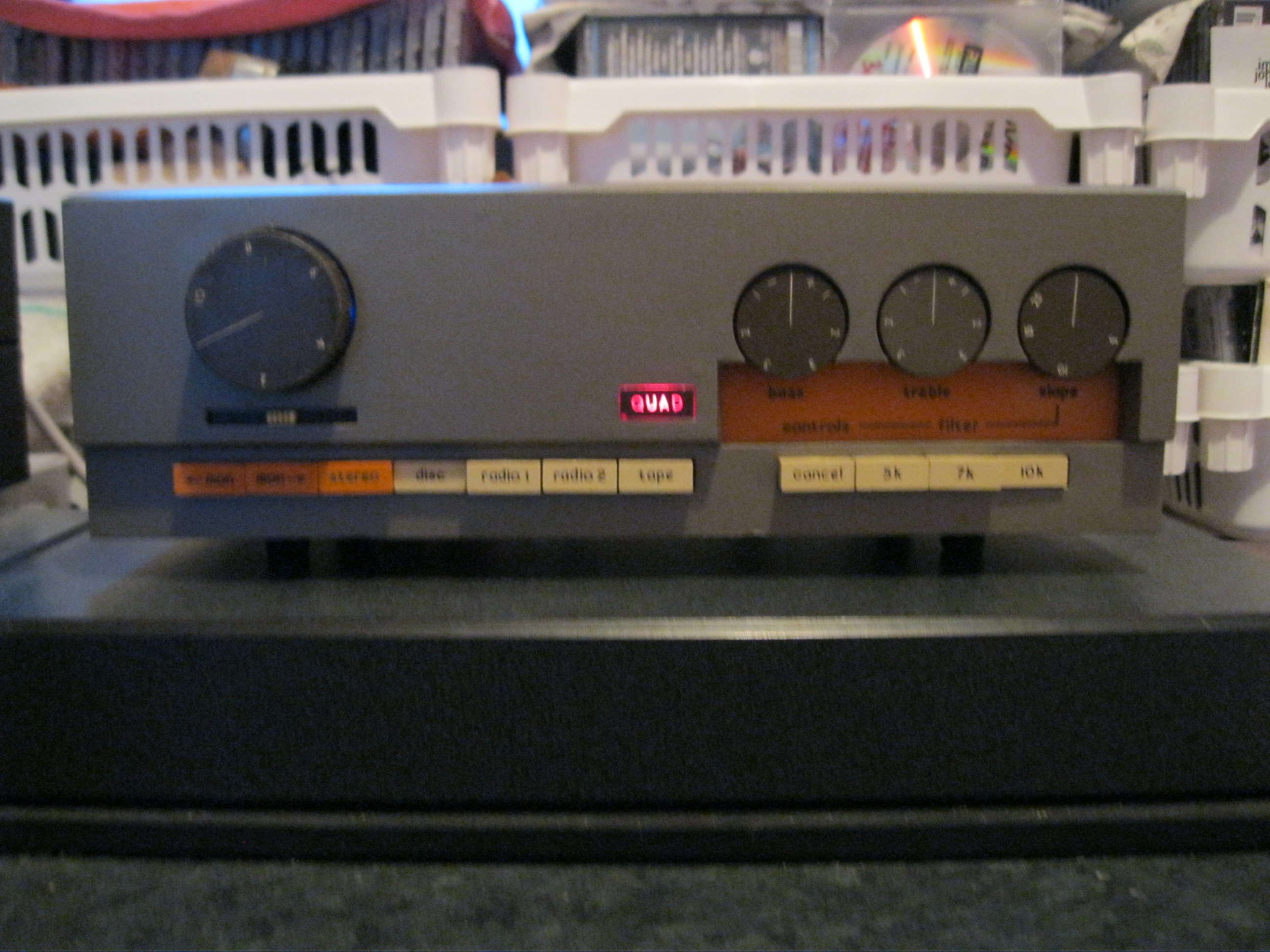

I have just completed another successful stereo coffee build into a quad 33 ( my own )

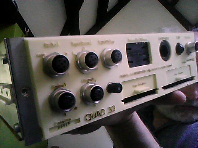

4 inputs and facility for tape out. For rear plugs I used a 5 pin locking plugs and sockets
that fit perfectly.
The power supply uses the original Quad transformer extracting 16VAC, this then supplies
the electronics salon LT1963 regulator board with ultra low noise 12vDC out.
Complementing the FM3 tuner in the wooden sleeve housing both, it looks and sounds wonderful
some images in a few days to follow.

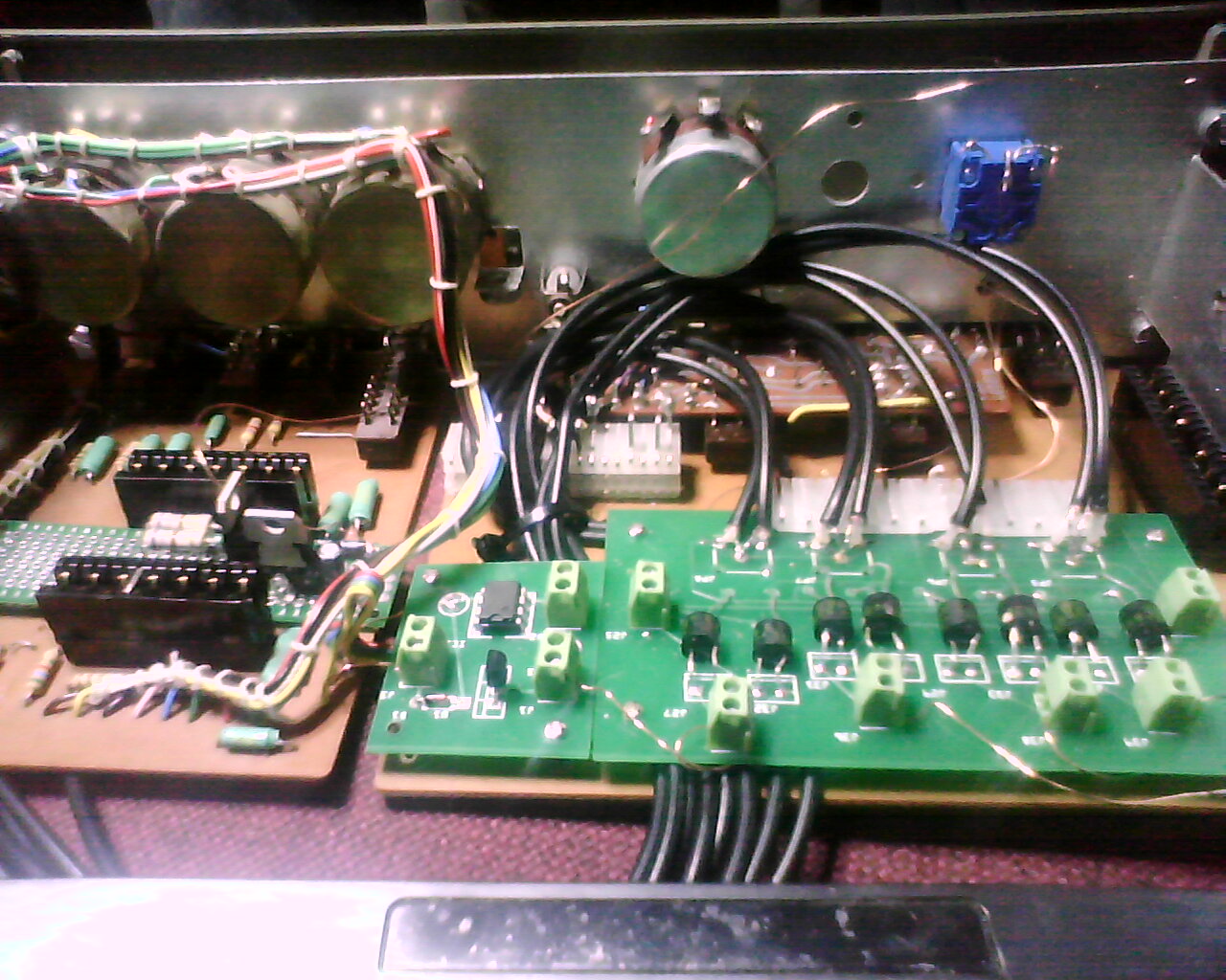

Some images of the stereo coffee Quad 33 build as promised.
Also LDR board showing 2k trims for perfecting LR balance above and possibly beyond the initial matching we provide.
