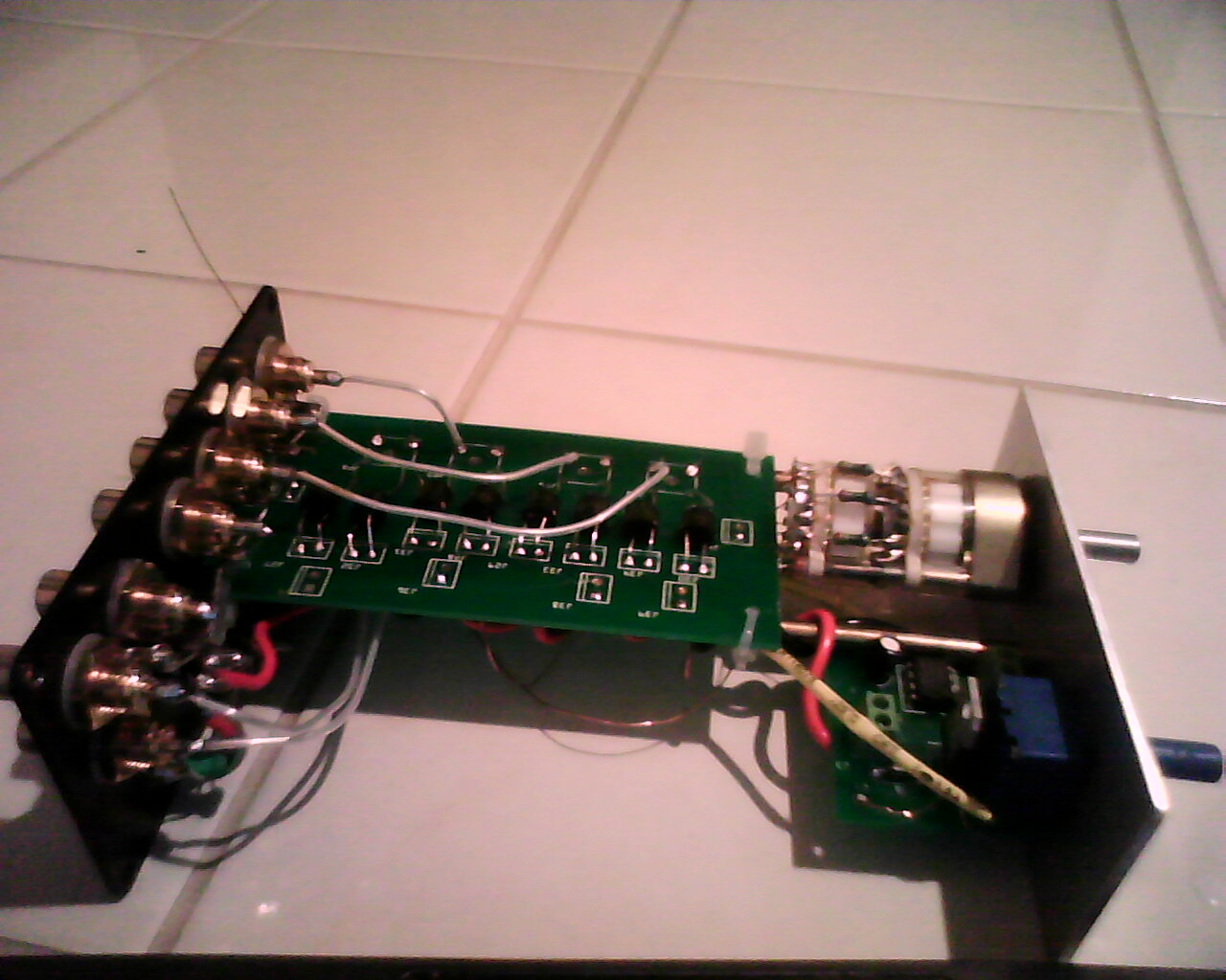

Here is a build of the 3 input LDR board without the RCA block. Its in a recycled Audio Synthesis PAS02.chassis.
Image shows 3 inputs ,the series LDR pair for the 4th input in this build will be added, I will post another image once this is done.
It shows how the boards can mounted to suit existing rear plate RCA's with the result of a big improvement to a prior switched attenuator type passive pre amp.🙂
Cheers / Chris
