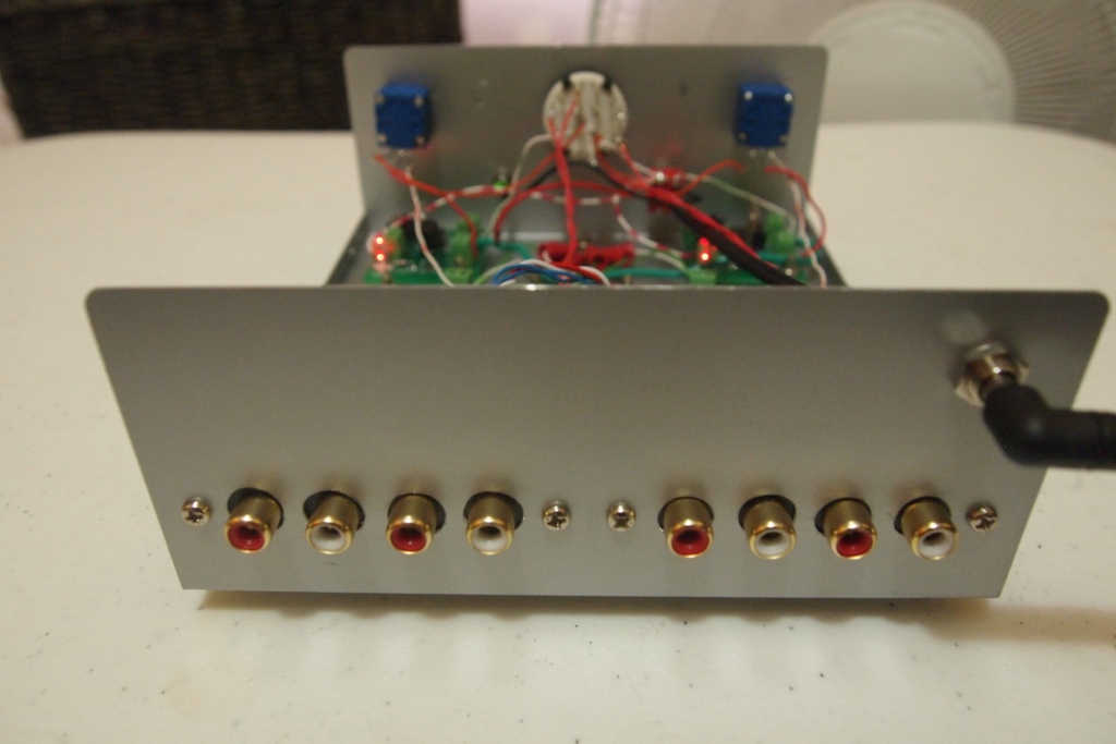

Hi Chris
Finally fitted the replacement board. Fixed up a little bit of low volume instability, sounds great. Will be ordering another for a different amp soon.
You can make them with 2 inputs and 2 outputs?
Hi Paul
Thats great, our Type c board has a few added improvements, so will get one to you very soon. Yes we can do 2 inputs and two outputs. do you need each to be volume adjusted independently or both together ?. to do this we will change position of what is normally input 3 to be a second shunt. it will need 2 control boards.
Hear from you soon
Cheers / Chris

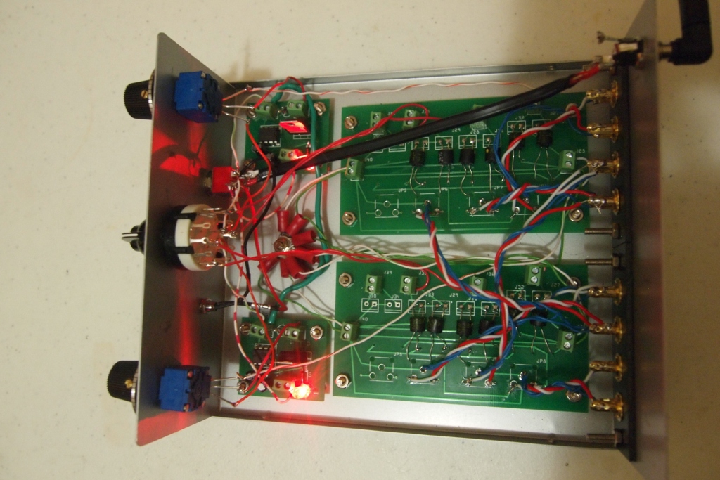

Hi
What Neilsan said and we are experiencing is this latest preamp rev C2 revealing everything what is coming off your CD player or LP. - like never before. Following Neilsans reply we have changed the diode placement instead of v+ of opamp to now have its anode extending from the board output, which is better .
We have ordered in additional parts that will take about 2 weeks to arrive, For sales in the mean time we are locally obtaining these same parts so the current large backlog we have of supplying these latest amazing C2 boards does not grow further.
For those constructors who just cannot wait, add a 6.8uH axial inductor 1/2 watt between control board out and middle pin of pot... this will give you a small indication of where we are heading. This inductor is planned to be a parallel arranged across the two lines of output ie 2x 15uH providing about 7.5 uH
due to the chance of constructors getting orientation of the prior mentioned diode the wrong way around we will not recommend its placement, so please await a new board.
Marco will send you new boards as soon as we get these parts.
Cheers / Chris

Hi
Today we tried our stereo coffee ldr preamp with placed inductors and is very special. An interesting observation though worth noting for those on the forum using a quad 405 with our preamp.
Our 405 has The DC Daylight mod with non inverting opamp stage, and repositioned C8. We tried a AD847 opamp and asked ourselves why it sounds so good with the stereo coffee preamp. The reason that we discern is that the AD847 has ability with its voltage swing to overcome R12 and C6 that are placed to not upset the dumper stage with excessive high frequencies. It appears the normal selection of opamps used with the 405 just cannot drive R12 and C6, or more likely other preamps are just so lacking in dynamics you won't hear it anyway.
End result AD847 equipped Quad 405 with DC Daylight mods to input stage and C8, partnered with our stereo coffee preamp is a very good combination. Have also tried a quad 909 and you would be hard pressed to find a better amp.
We will try other low distortion amps but current dumping amps and our stereo coffee preamp are a great and recommended combination.
Cheers / Chris
