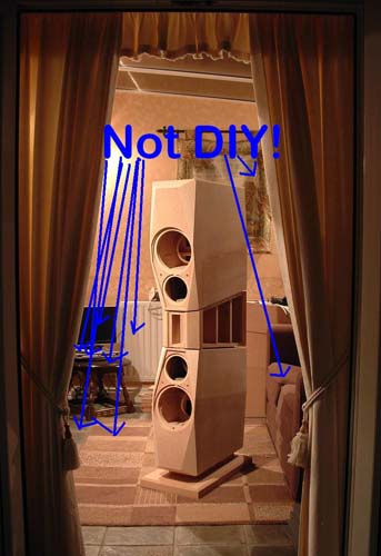

So close now:
imjatse said:Honestly you guys are giving him too much credit. Look at all the stuff that is not DIY in that picture. I mean really. Its like you aren't even trying Shin!
/I wasn't sure about the curtains.
I have to laugh at that. DIY radiator and chairs etc. Hmm. They do look excellent though, I have to say. It takes a lot of work, and a certain type of person, to be prepared to actually go through with something so complex, I hope they end up sounding, as good as they will end up looking.

Tenson said:Lol, gotta love the 'unveiling curtain' 😀
It wasn't intentional, we're having a new bathroom suite and all the junk from that is on the other side of the room so I couldn't get a decent shot from the usual angle, at least not without standing on a toilet 😀 There's a pair of doors in the conservatory so I decided to open those and take a shot from outside. What you see there is the result.
Just why am I explaining myself to you lot? 😛
float said:Good pic that. I love the look of these.
A roll of Fablon from B&Q and they're finished 😀
They were all out of my favourite 80's TV Teak otherwise I'd have been there in a flash.
Looks like sq225917 bought it all up for his KEF's 😀

Just the tweeter baffle to tweak and smooth out and then this one is finished:
I wanted to get some shots at different angles because wherever you look at this speaker from its just cool, however they're too heavy to push around so gave up.
You can plan, design and then look at as many computer renderings as you like but nothing really tells you what a project will look like in the flesh. For me there's three really rewarding moments in a loudspeakers construction. The first is this 'woodworking complete' stage, the second is when the finishing work comes together to create a finished loudspeaker and the third is when the sound snaps into place and you can sit back and enjoy a completed project on both aesthetic and aurally pleasing levels.
Its a real shame you can't see these in flesh because they're stunning, every one of my expectations set out in the initial design has been met or exceeded and the loudspeaker, as it stands, is easily my best work and has pushed the practical experience that I have to the limits. Few things are more rewarding than these things so forgive my enthusiasm but I'm sure you lot understand anyway 🙂
