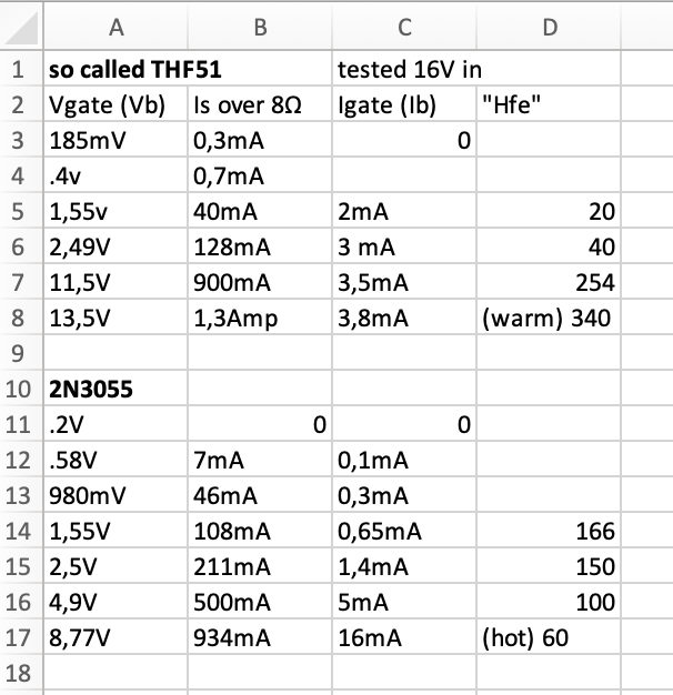

As for the so-called THF51 that I got from the ALIpages, they are an NPN as my tester says, with a considerable gate current drive - the tester said µ=2, I measured Hfe 200* - 350*(warm). It is an NPN, fancy 'new device THF51' is just a scam.
- Test jig - an 8Ω resistor on the source (=emitter), a 5K pot for the gate (=base) and an ammeter in the gate lead. I just set it up such that if it is a SIT, that would show this way; output current would be self limiting; my "lab source" limits at around 1,4A.)
To double test my setting, I tested the 2N3055 same way.
(Invalid test. I did not have a constant Vce, please understand. Just comparative.)

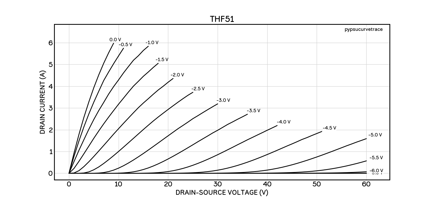

I just bought a quad of "very closely matched" THF51's from Japan. Even have the curves for each device.
Curves would make a 300B jealous. Not cheap but I believe them to be authentic. Test as J-Fets on my not
so fancy tester. If I can finish my F5T mono blocks I want to try a MZM creation next. Have a 3U and 5U deluxe

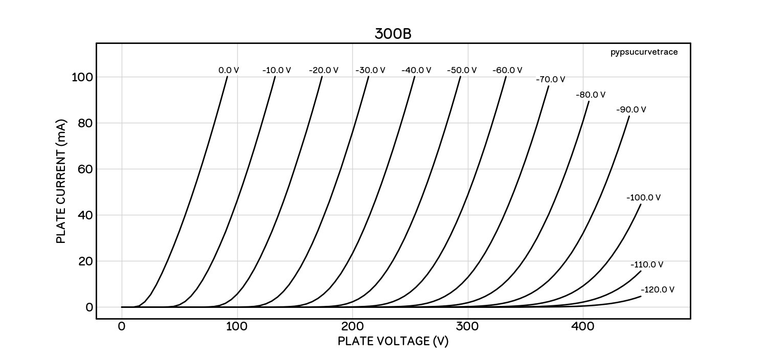

if anyone is willing to send me a quantity of either .......... even better - both 300B and Tokin SIT (any), I'll be happy camper
though, 300B is linear as 300B + OPT combo is linear
btw. comparing to proper KT90 in UL, 300B is Miss Piggy

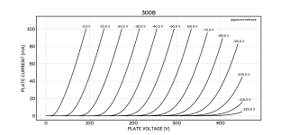

300V in the picture looks very linear.
Until the real load line is laid.
For SIT, you can choose it better.
In addition, let's not forget that there is no 300V without an output transformer. They must always be considered together
And 300B break if they fall off the work bench. And SITs are smaller. And 300Bs are available from new manufacture. And they are meant to do different things anyway. And, and, and. All I was trying to say is that SIT curves do not make a 300B jealous.
Didn't say they were better than a 300B but for a SS device they are damn nice 😉And 300B break if they fall off the work bench. And SITs are smaller. And 300Bs are available from new manufacture. And they are meant to do different things anyway. And, and, and. All I was trying to say is that SIT curves do not make a 300B jealous.
