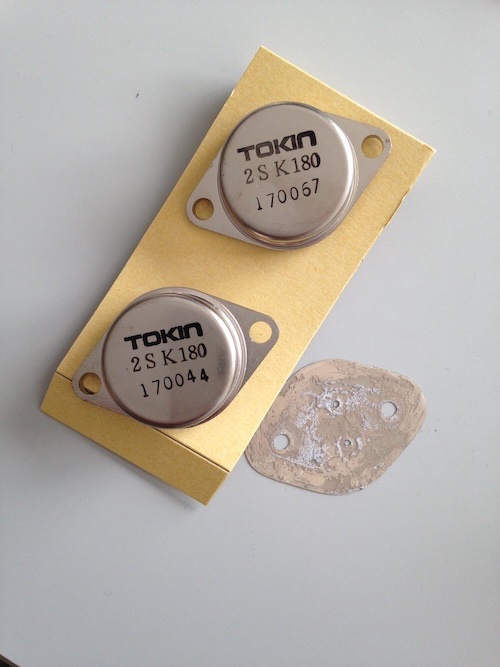

  • So here is his link, and he offers the pair of 2SK180 ; and the pair of current-matched THF51. It is on ALIExpress, so the EU import is all handled with VAT porepaid, including the dreaded customs handling (that lost me some device). It is the same price as his ex-VAT on the swap page.
And the current status:
Reactions: decramer
Wait a second: Aliexpress is a market place that offers good services to handle the imports in the EU, is my statement. Yes, many offers are just 'shyt', components that are different. I am not the one to certify Pras, others could do that. If you do not like AE then contact him directly but then customs declarations is tedious from individual post dispatches, if you are in the EU. [And yes, I worked at The Tax Authority and think it is good not to double cross the economy, even though I'm Dutch and we have the nickname to do so... 😡 But that is just my private belief.]
I have these already waiting waiting and so decided against another SIT. Thats all. And I did not want Pras1170 to be let out. That is just private demeanour.
As to old/new I cannot comment . contact the seller.

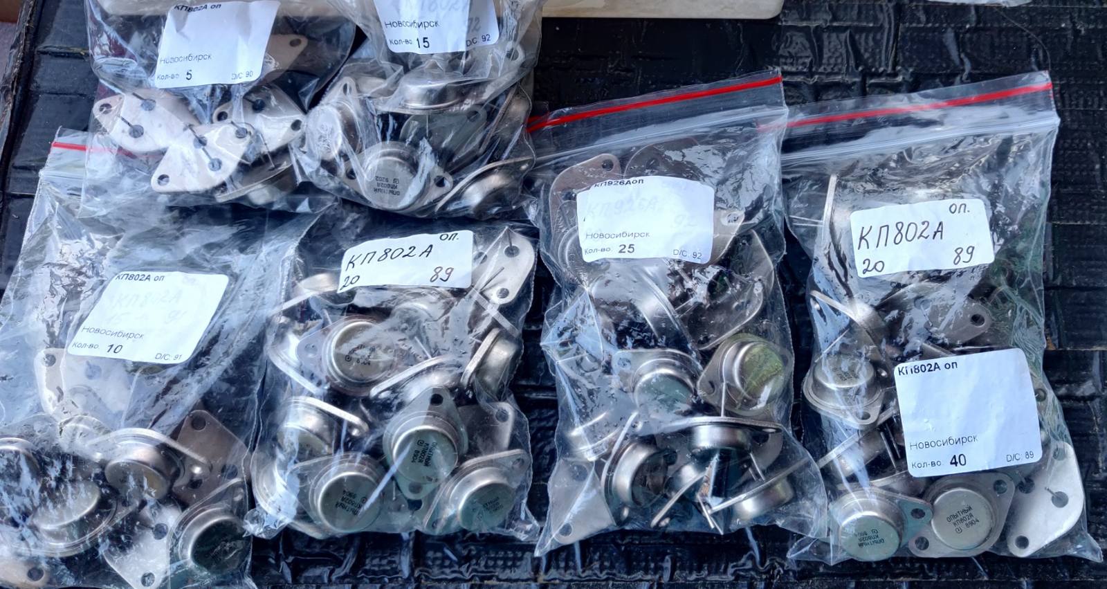

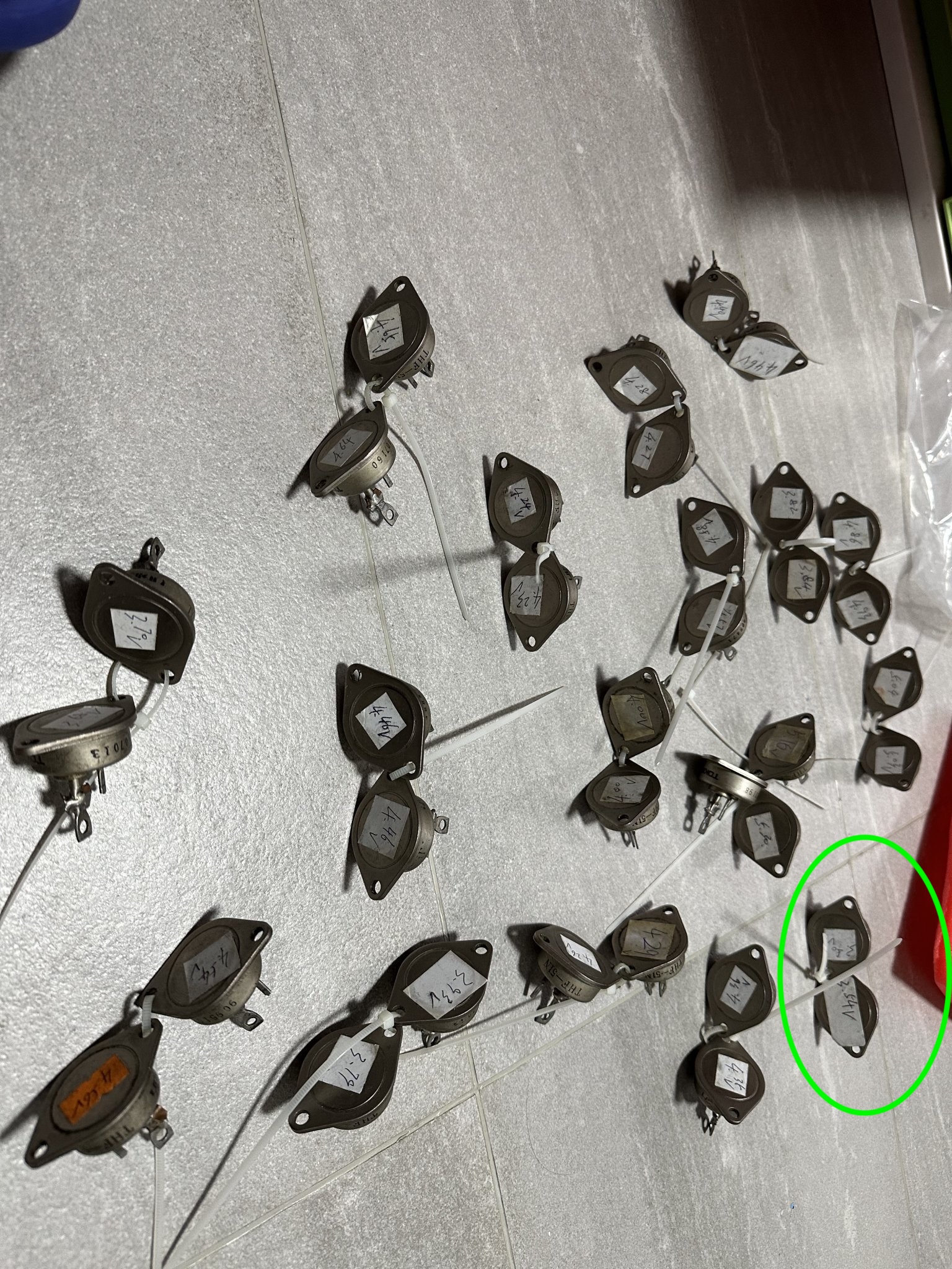

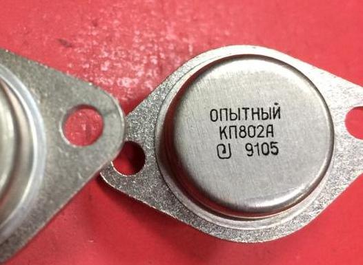

It is very hard to believe that someone abroad has at least one hundred "UA-RUS" VFETs in quantity. Not to mention kilograms, or tens of kilograms. I don't believe it, and that's all.
Because I know that a very limited number of them were produced.
"Russian" VFETs (SIT) - KP801, KP802, KP926 ( in the original language, КП801, КП802, КП926),
And that's it.

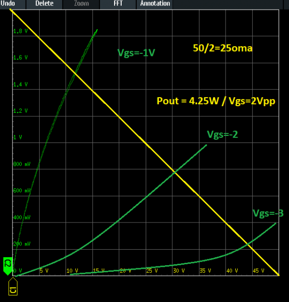

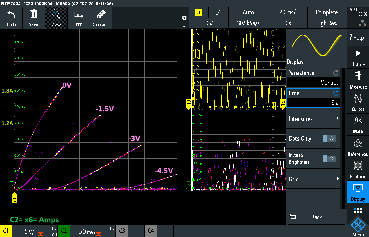

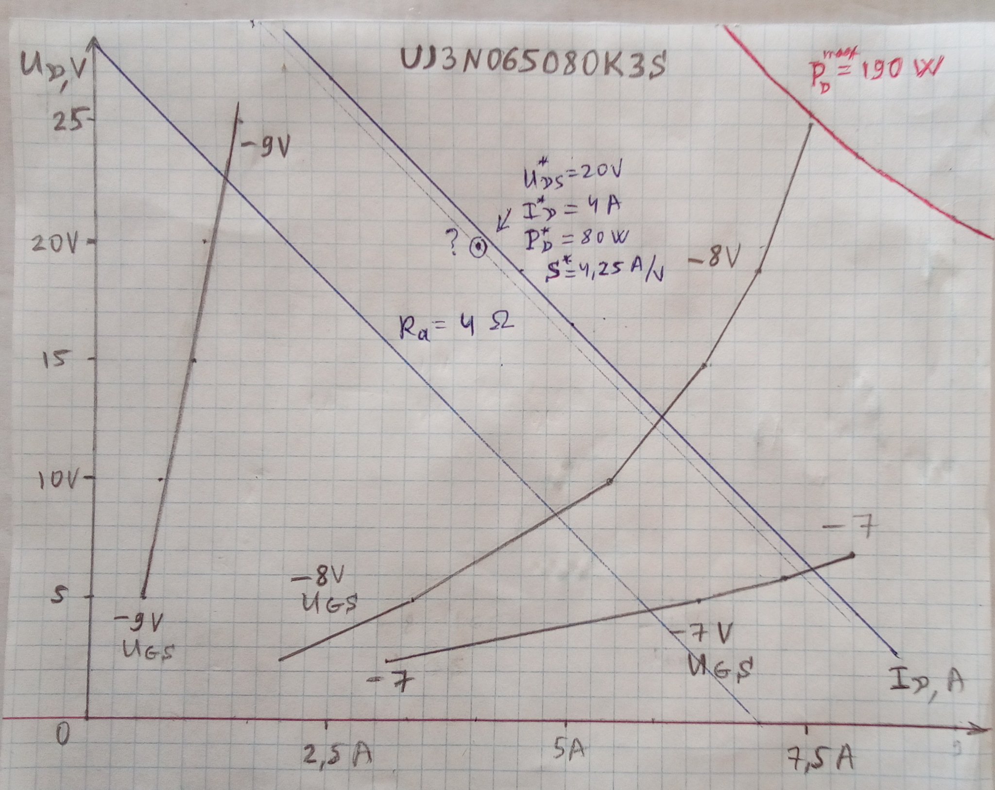

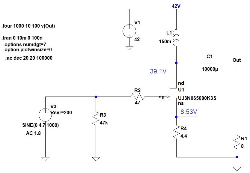

I measured the characteristics of UJ3N065080K3S
up to a voltage of 30V. For use in SE circuits.''
Possible operating point position in SE: 20 V, 4 A, offset. -8.5 V, S=4,25 A/V.
As you can see, the characteristic in the operating area is intermediate between the "triode" and "pentode".
So you don't even need to look for SIT.
Reactions: jpatay

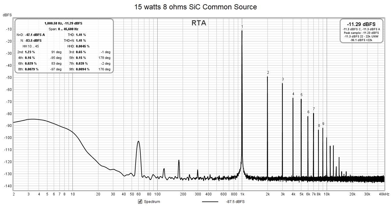

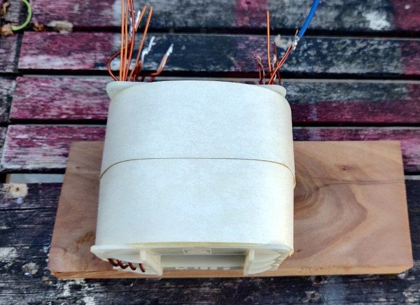

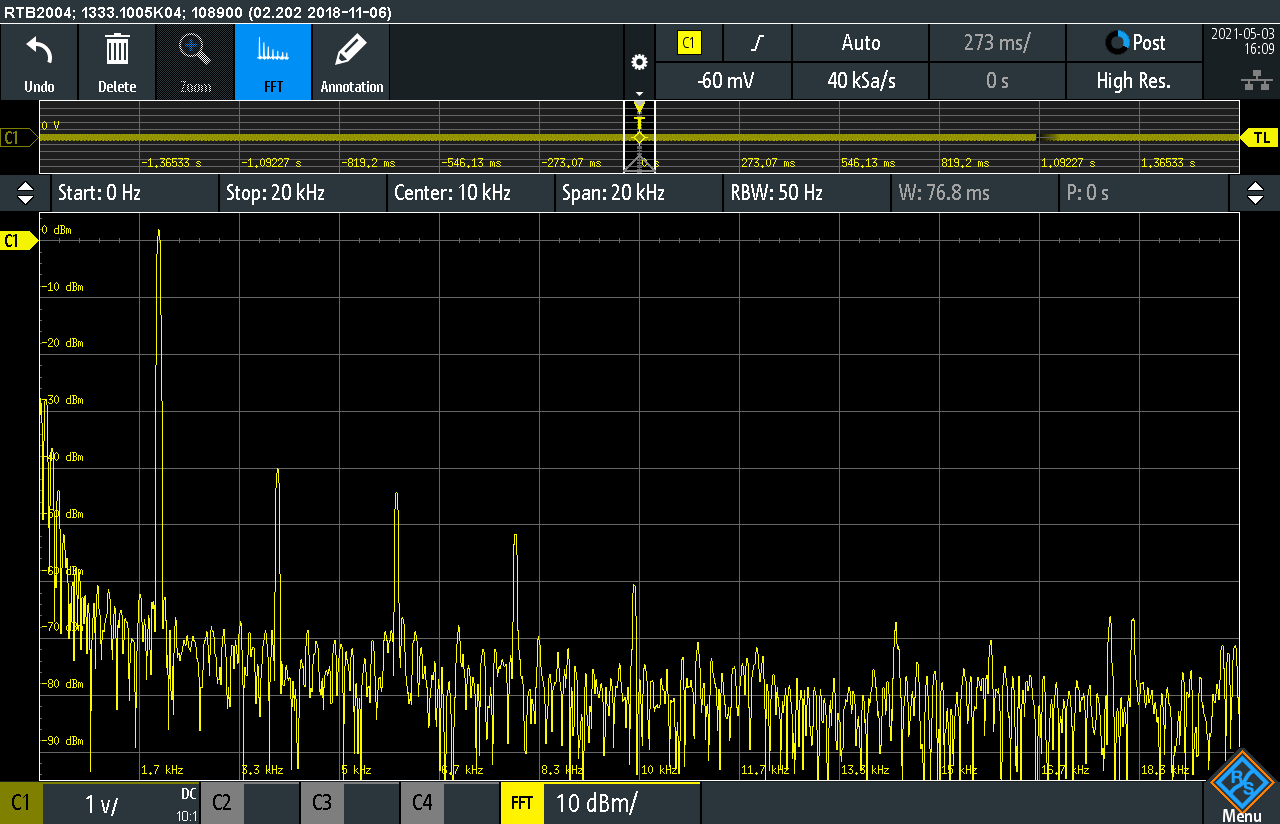

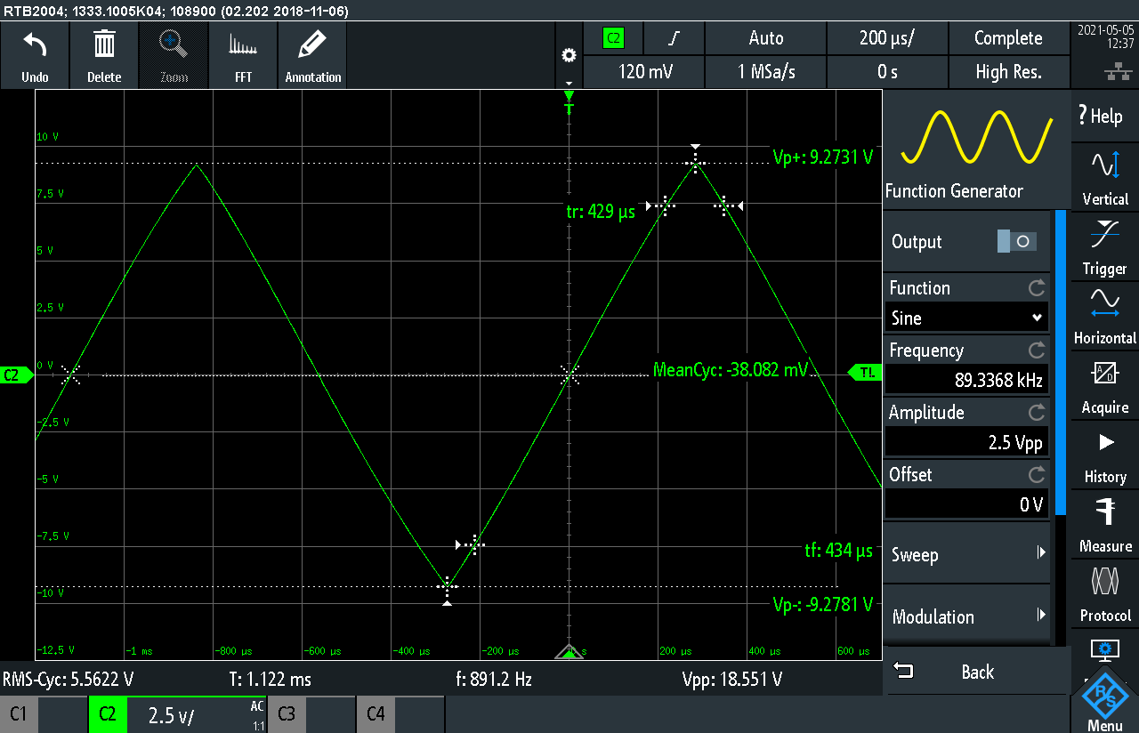

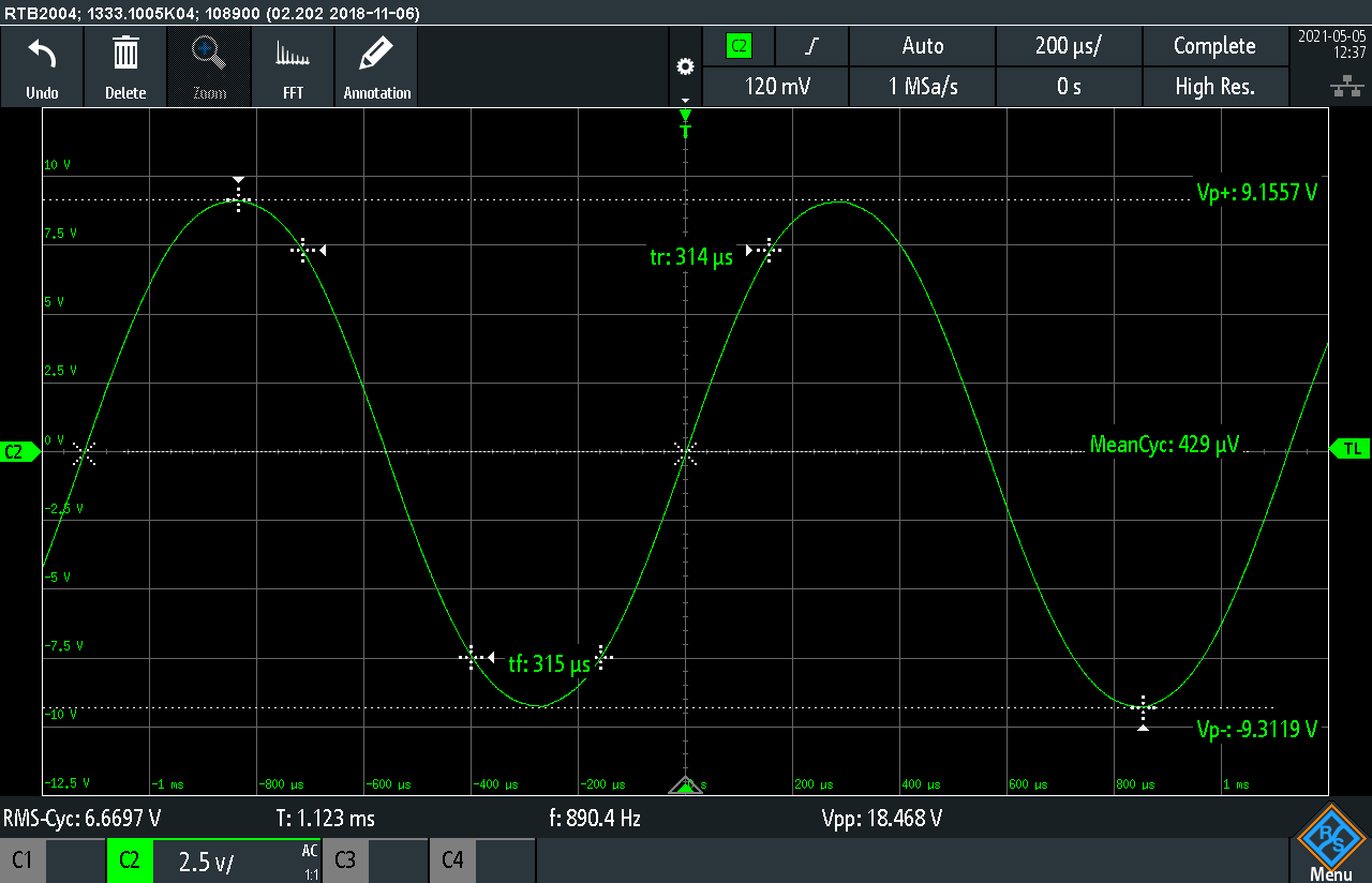

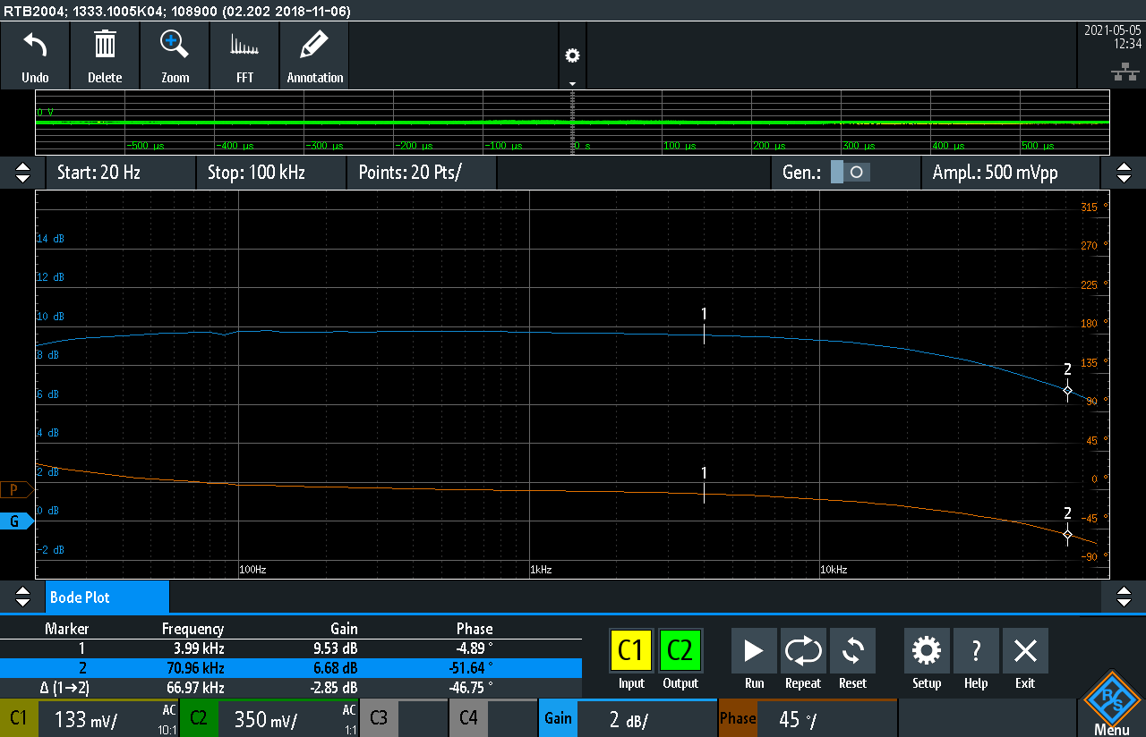

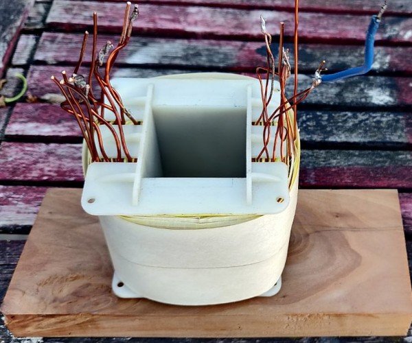

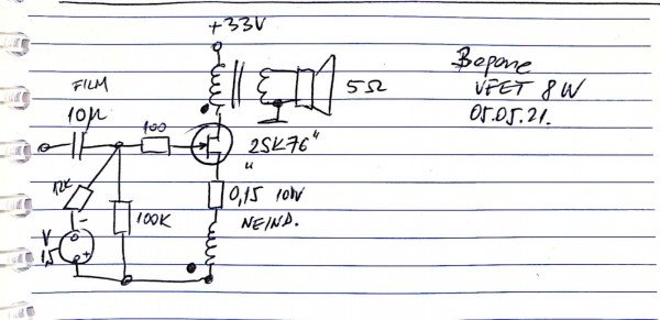

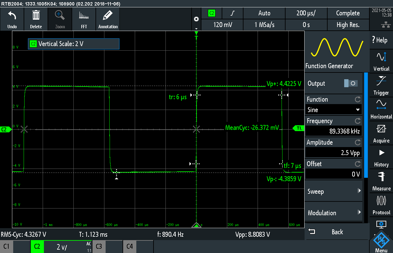

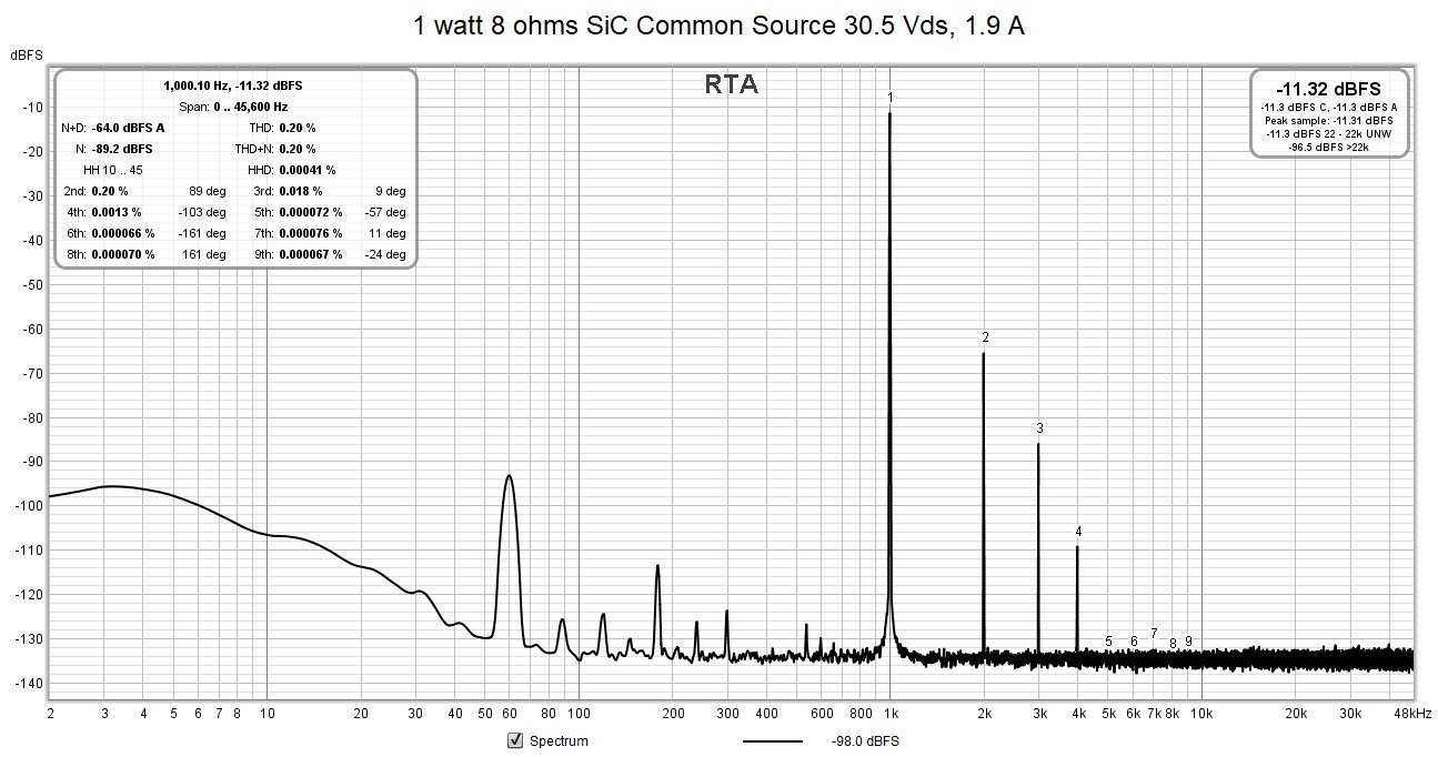

the test amp was made several years ago, with source feedback winding , with double C core custom transformer (25 to 8 ohms, 70kHz top freq, wound by myself) first with Yamaha and and then after with KP802.. after was needed to add the driver circuit but never come back to it.. i think this year i need to complete it. and opet proper thread for it, some graphs from testing phase:

Wow, you do have a big stash 👍 Please let me know if you have a pair for sale.
These Russian SIT don’t seem to be available anymore on eBay so looks like your timing was good. The only one left are the Japanese one from Tokin.
Have you had a chance to compare for example the KP802A with another SIT ?
Eric
Unfortunately nothing to sell, i was buying from the local stores .. hopefully one day will be possible to do again..
i have a lot of different VFets at home, also mamut 2SK77, but never had time to do all the measurements and comparations properly.. Built some experimental PP guitar amp in 2011. powered from 110V and it was working!!
I've never found enough time to dedicate myself to measurements and development in the last 10 years.. I think it's time this year to change this a bit..
