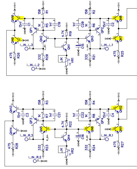

It doesn't make sense.
Manual says:
"Omitting the output buffer:
Omit: QN5-QN12, R25-R28"
According to the schematics, this will end up with something not so symmetrical.
Yes you are correct. We will correct the manual.
It should be :
Omit QN7-QN14
Ok, thanks to Brian, the manual has been revised. Thanks for spotting that error. Also it should be noted that all of the omitted buffer parts have an "X" in them on the PCB. And the places where the jumper goes have a small line between the two pads. I just use a small piece of left over resistor lead.
