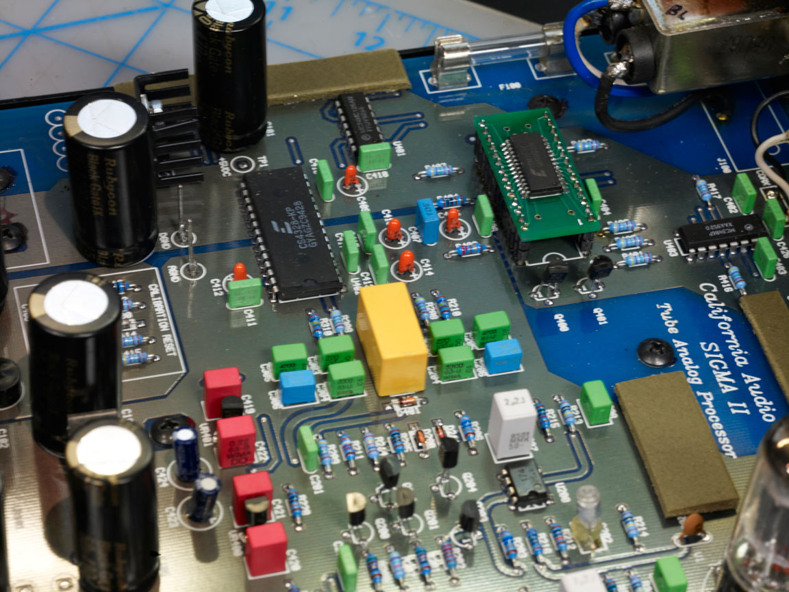

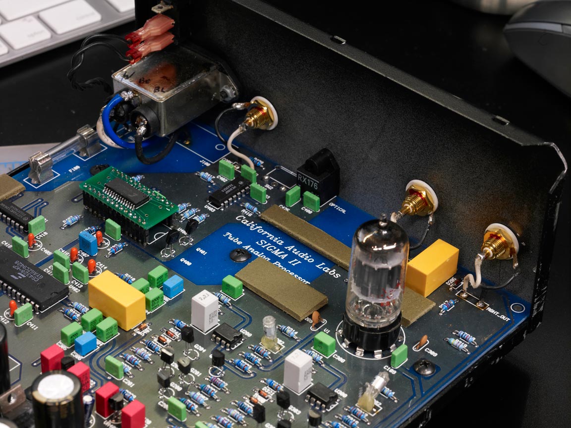

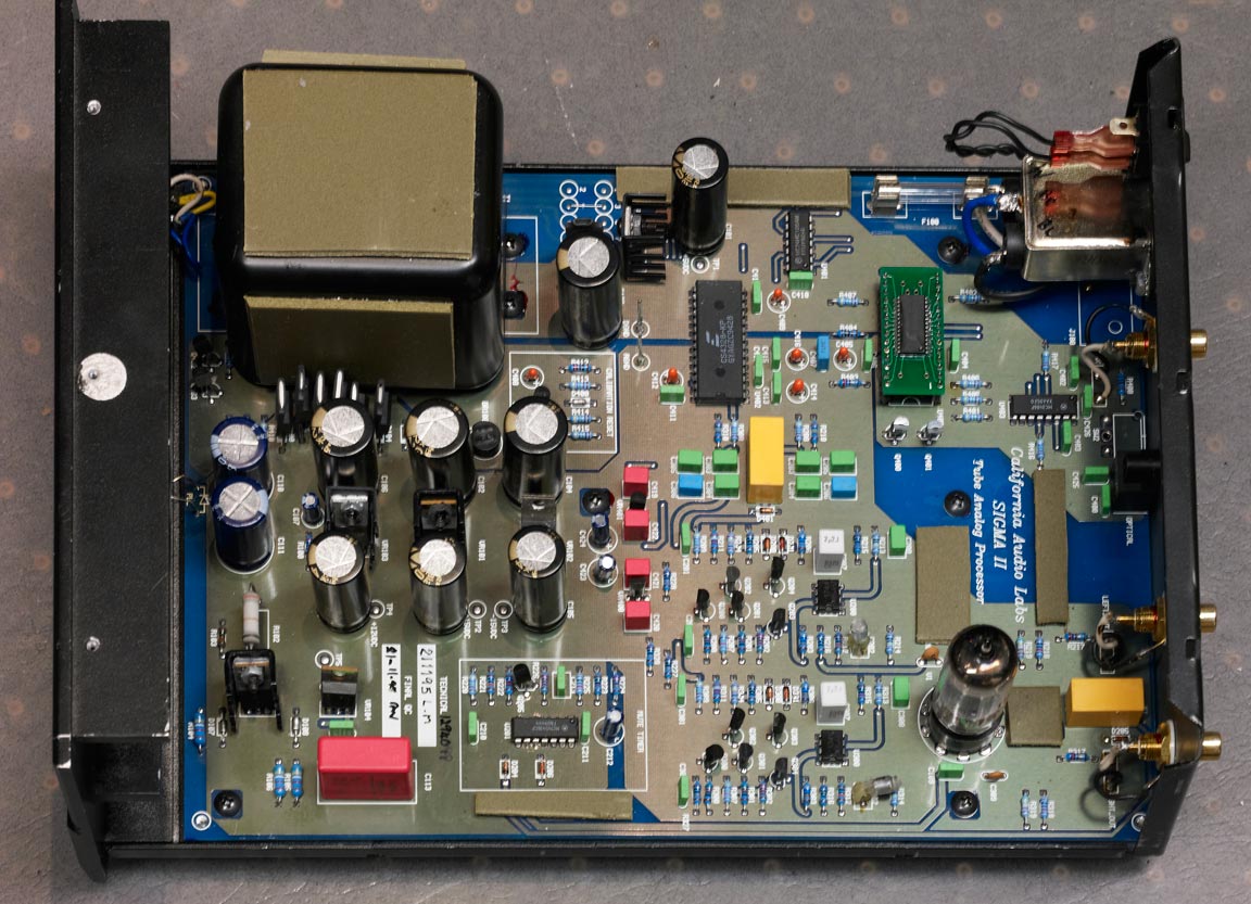

I just ordered last weekend Buffalo II and Legato 2. Cannot wait to receive it.
I have California Audio Labs Sigma II DAC. Long time ago I did updates to it with extensive use of Black Gate caps throughout. That DAC is 16 / 44.1 and it is the time to retire it. I have been using it at work in my office with small tube amp. This DAC has tube output stage.
Now since CAL did really great work at the time, they provided me with lots of real estate. That makes this DAC perfect to be used for Buffalo. I could use complete PS as is, input switching between coax S/PDIF and Toslink and tube analog output. I could easily make connections to Buffalo II through plug in modules, just like the one used for CS8412. As you could see they made perfect grounding on board clearly divided for analog and digital ground. I am right now taking schematic down so that I could use traces for input and output.
I also would like to use Legato for balanced output and for fun, so that I could switch between tube and solid state 😀😀😀 Brian, do you have any suggestion for some slick switching between output stages, something that could easily swap between these output stages? I am obviously thinking something like relay that could be easily implemented. Also is there any portion of Legato I/V that has to stay and that you would suggest to keep when used with this tube output?
See included pictures
Thank you

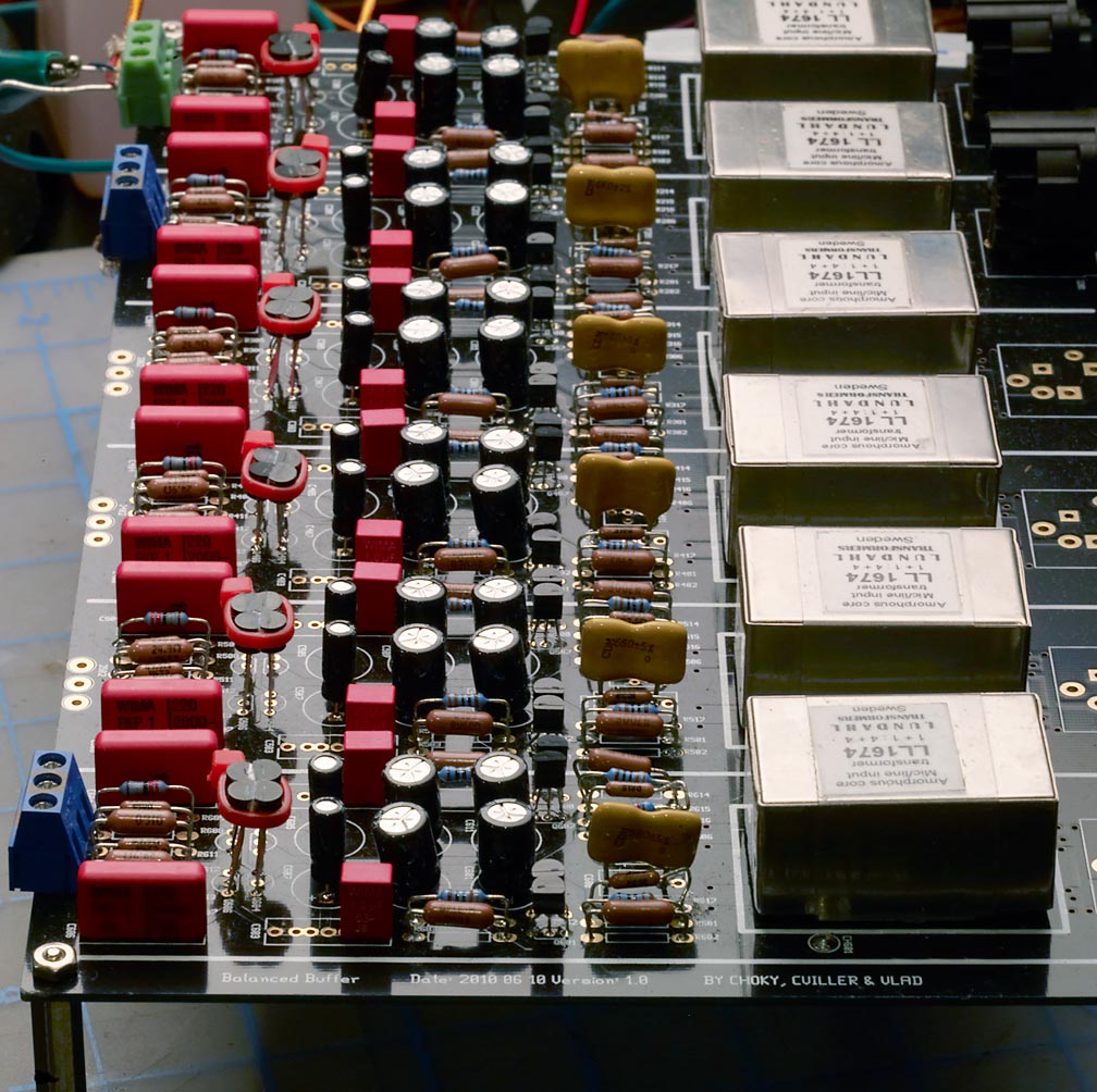

I will also try this - Lundahl jFet buffer board that I dedicated for my DCX2496 output, but as I see I could use it here as well, ether with trafo or just buffer out if I want. As I see it it will be pop non stop, hehehe.
