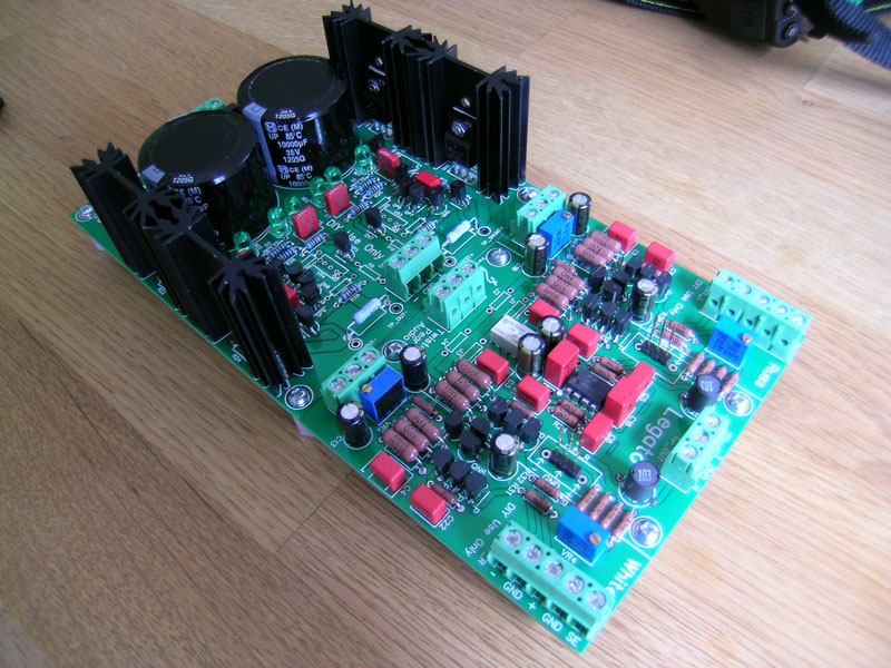

Yes . 🙂 At the SE outputs you have 250ma of SE output to use as you see fit.
Using the balanced outputs without caps is not going to work for everyone. I will cover this in the manual, but if you balanced amp has diode protection at the inputs, and/or cannot handle common mode DC while powered off or on, you should definitely use caps. This only applies to the balanced outputs, and those caps will not be in the path to the BAL/SE stage. If you do decide you need caps they will be external to the I/V stage, and can be fairly low value film types depending on the impedance of the next stage of course.
Those going into truly differential transformers with no tap to GND on the primary side will not need caps.
This thing is absolutely amazing into headphone. I have been listening to all of my cans, all of them from electrostatic to 600ohms sound awesome. Plenty of power to spare. Incredibly rich and realistic bass and extended but not harsh high end.

A convenience header for headphone output. It just bring the two SE outputs and GND close together so you can route braided wires up to you headphone jack.

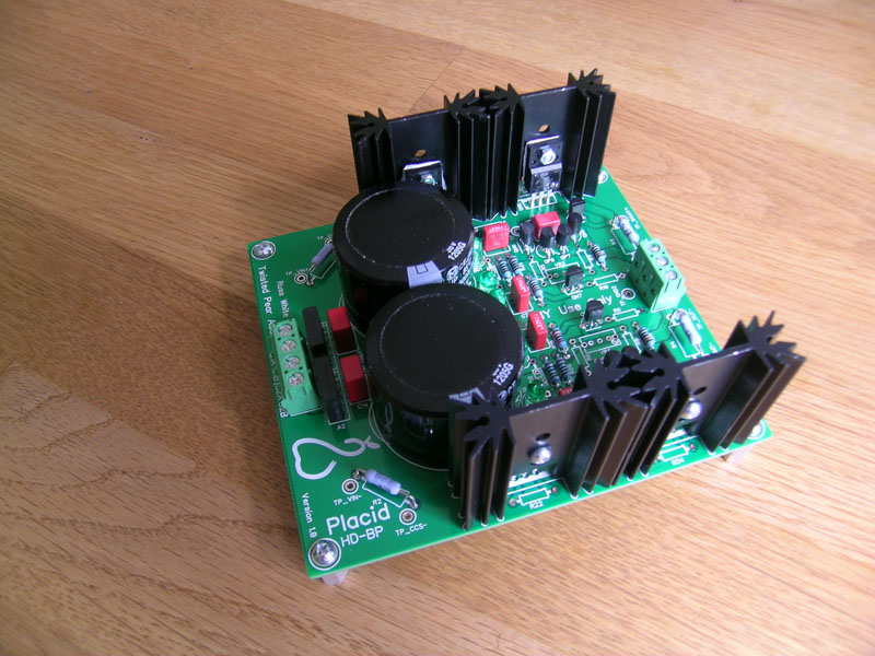

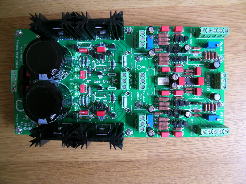

Russ thought I should post these as well, even though this prototype is awaiting a few more parts...
This is Placid HD-BP, designed for higher current output, and will replace Placid BP.

I was blinded by it's beauty - didn't noticed the missing opamps.
Can't wait...
haha, well thank you. 😀
