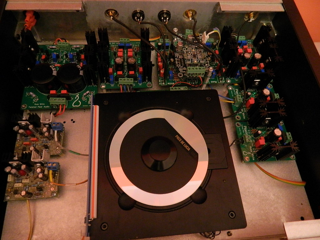

It sounds like you have something installed backwards (relay, opamp, etc). Can you post a picture?
Dear Brain,
Sorry for the late response, But today I bought the camera and
was able to take pictures.
Meanwhile I found the cause🙂
Transformer fault was not of good quality.
I changed and now works perfectly.
I put coupling capacitors 33mkFx16v BG.
First Watt F5 balanced not work without.
The sound is incredible!!!!
Thank you all for your help🙂
Best regards,
Vitali
