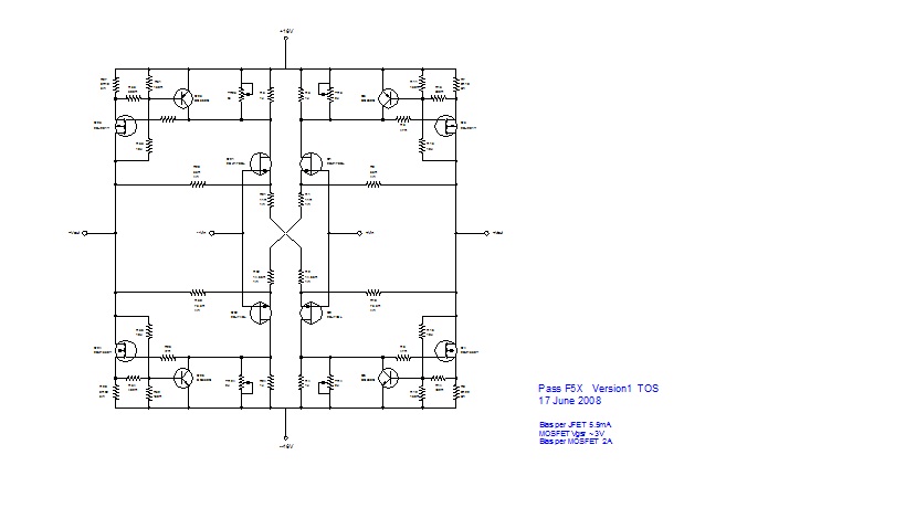

I tried F5X( Euvl), but does not work without capacitors🙁
I do not see any use of ground in the schematic. I wonder why it didn't work without caps?
I apologize, I was on vacation🙂
I do not know why not work without caps ...
The balanced output we now 33/16vBG (N) and F5X work.
But without them, no.
But I wanted very much not to put capacitors ..
Hi Vitalica,
What is the balanced ground input connected to?
