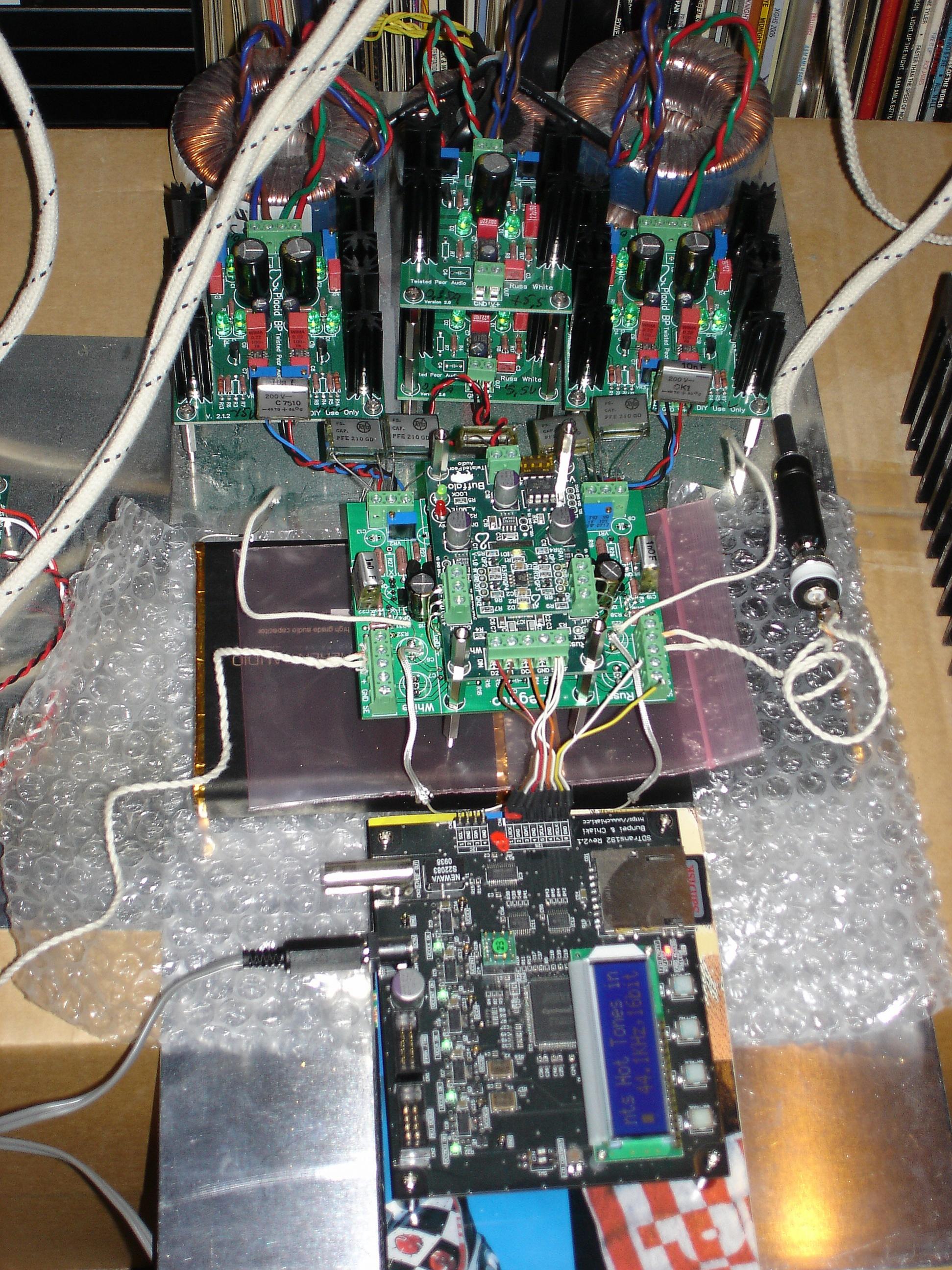

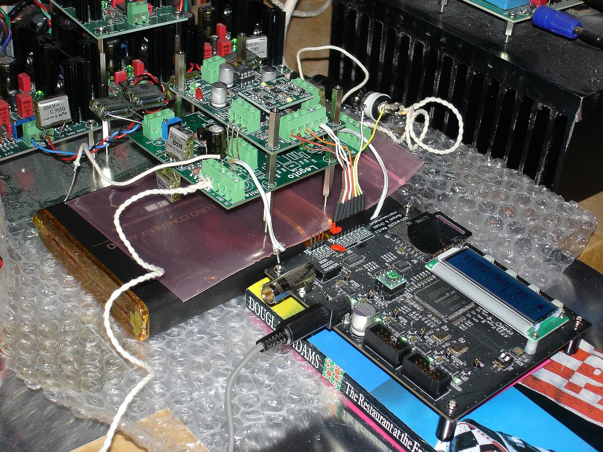

Yes, that is the superb SDTrans192 ver 2.1 from Bunpei/Chiaki in Japan. I now also have the better sounding, IMHO, SDTrans192 ver 3.
The 2nd stacked Placid is suppying +5V for my 2nd B2-Tridents that is to the left of the setup in the photos. That B2 is connected to my computer via an USB-SPDIF interface and 10m of 75 coax - for background listening mostly.
The sound of the VSF are much better than the Mundorf Supreme 15uF caps I have tried. Better bass, more enjoyable midrange, and a silky smooth treble.
What I miss in the main setup are the Tridents. They made the B2 sound even better 🙂 I do have have the Tridents but....
/S
/S
