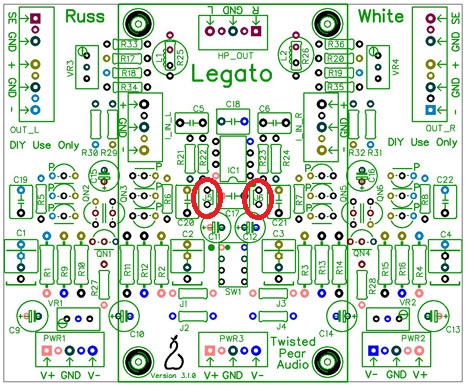

So if I am omitting buffer and opamp SE/BAl stage, than J5 and J6 needs to be populated - right?
Should that be C5 and C6, as opposed to J5, J6?
SMathews
Just to confirm, I have the board with buffers installed, but will initially omit the bal/se stage. Do I install J5 and J6? I'm assuming yes.

I would leave the jumpers out and just not power the bal/se stage (center power terminals).

Not to sure I understood well. I too would like to use the SE output available at J5,J6 and not power the buffers. Since IC1 takes its power from +15V3 and -15V3, thus center power terminals, I would need the jumpers at all times. There is no way to unpower those buffers easyly, that I saw.
Could you clarify, please.
He was not using the bal/se section at all.
You are correct, that it is not straight forward to not power the buffers. However, why do you want to avoid using them is they are already there?
If you want to *not* power the BAL/SE stage (including the buffers populated or not, it won't matter) yet still use the balanced I/V stage you you simple omit the supply jumpers and wire both the left and the right side terminal blocks directly to your power supply.
This IMO is an extremely impractical thing to do. Instead go ahead and populate the BAL/SE stage and power it, but either use i's output or not. your choice. Its presence does do harm. 🙂
The buffer and the op-amp are one loop. You cannot really isolate them with removing the buffer from the equation. As I have said multiple times - if you have the buffer, it is only ever a *good* thing. If you don't want to use the buffer order the version with out it. Simple as that.
