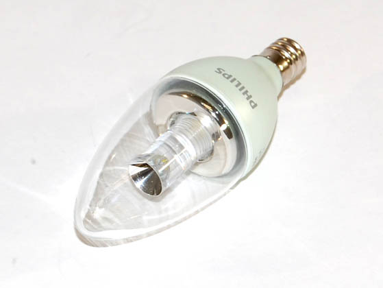

When I recently had to replace about 4 LED bulbs in my house, I went with Philips. Fingers crossed.
Like I've said, I've had Philips for years now, and not one failure of that brand.
