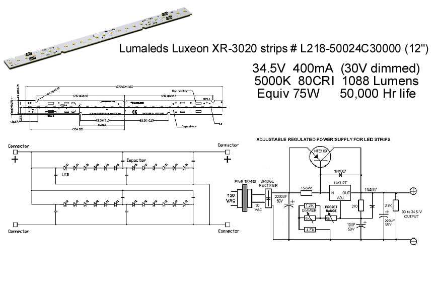

This is the very nice LED strips that I installed under my kitchen cabinets
Reasonably priced, along with the aluminum channels w/frosted diffuser covers, they're about 1/2" thick, 12 inches long.
4 of these, wired in a chain to my own dimming power supply design, I couldn't be more pleased with them.
I would assume they're also great for uplighting, backlighting, or inside cabinets for a nice effect.
They also come in a 24" length, double the lumens/LED's, and current (800mA)
