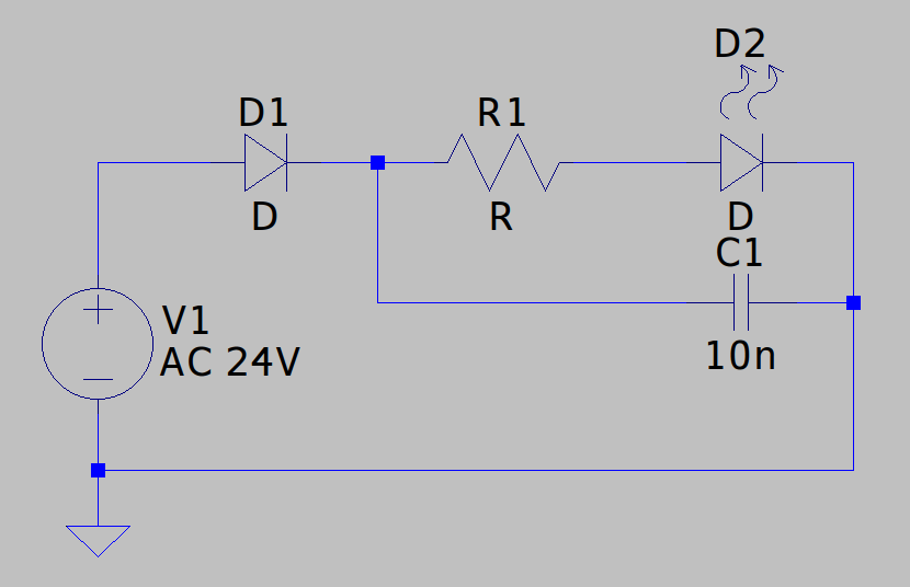

Well the diode has a Vf that is within a small window and all the rest of the voltage is then "dropped" across the resistor, right? 🙂Apparently many don't see that but I am glad I am not the only one that does see it. Since they were intended for DC use it seems the simplest and most optimal way of dealing with them.
* It is a current limiting resistor. Dropping resistors limit voltage AFAIK.
Still it is a current limiting resistor as current is the parameter that must be limited.
R led = (U bat - Uf led)/I led
No, maybe it is good to follow standard lingo. Main subject/part is the LED that needs the current limited, not voltage.
Diode, 22 kOhm series resistor (for 24V AC), 1 ... 10 µF cap, second 22 ... 100 Ohm series resistor + LED.
High part count for an indicator light.
I hate this thread already.
No hate just love. You should add the main current limiting resistor and the antiparallel diode I forgot to mention based on the info Elvee provided (I think). It was the leakage current of D1 that made the LED blow up. This is prevented/solved by adding the antiparallel diode. R1 was meant to overcome the issues that come with the LEDs parameters in combination with a parallel cap as mentioned by Elvee.

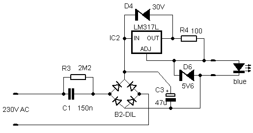

One could use a diode-cap-voltage regulator-cap-series resistor-LED to overcome all the blue LED issues 🙂 The anti-KISS approach.

I would use a 'normal' LED, this is complicated, and failure prone.
Use a bridge rectifier, drop / current limiting resistor, smoothing cap, 3V9 zener (if needed), as a possible supply. Pure controlled DC.

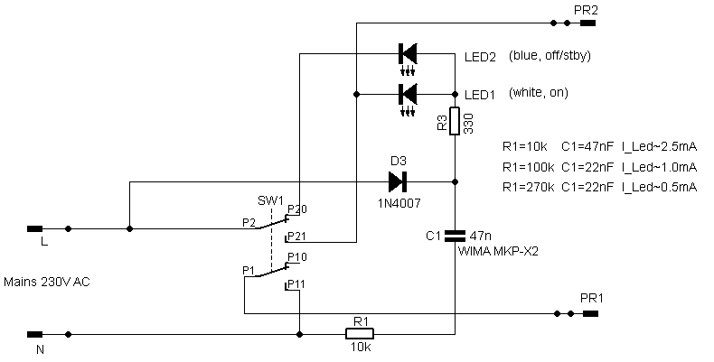

Nice circuits, especially the second one with standby indication! Almost more complex than the device they are built in 🙂 Hey if it floats your (blue) boat....
Some hesitance to bring higher voltages to a front panel LED though. In the past a few extra windings on the toroid with normal insulated wire to the standard green LED and just a series resistor also worked. Safe, simple, cheap and reliable.

But I wanted an indicator each for on and off state. Wouldn't work with voltage from the switched transformer.
The LEDs also aren't put directly in the front panel. I would see isolation issues with them looking through a metal panel.
The panel is either of transparent Plexi and the LED is shining through it (Like here).
Or there is a kind of light guide from Plexi which reaches trough the panel.

One amp I'm working on uses a blue/red LED for standby/on, DC powered from a tiny standby transformer which also kicks in a speaker delay relay.
The 3 position source selector also powers 3 LED's - blue for phono, red for CD, and green for aux.

Yes Jean-Paul, blue for ON.... red for Standby.Wiseoldtech again... with even 2 blue LEDs to laser the eyes 😀 I take it is blue for power on and red for standby?! Otherwise many would be switching stuff off instead of on.
CORRECTION: Both are OFF when unit is OFF.
The red illuminates at power ON... then switches to BLUE when the delayed speaker relay kicks in.
And they both are dimmed to a comfortable glow and show through a single frosted lens, as are the selector LED's
