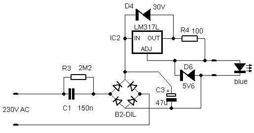

Let's forget the first circuit.

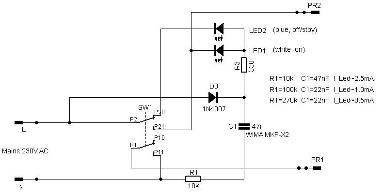

I am sure that the second appears to work -for now- (and maybe forever), but leaving the cathode of the LEDs ~floating when the other side is connected to the mains is not a good idea, especially for the white one, which remains connected to the (inactive) PSU. They can catch all sorts of stray voltages, which come from a very high impedance and are benign with regular LEDs, but modern blue and parented Leds do not like this kind of treatment and might fail unexpectedly.
An antiparalell 1N4148 on each Led costs nears to nothing, but buys you peace of mind, which invaluable

@Elvee: you sold the antiparallel diode to me. Will do so next time but it may take a while as they seem to be made for DC.
I take that risk (imo theoretically and small) and see what happens over time in daily use.
I had specified a specific small PCB area for this circuit and initially an anti-parallel diode on each LED. But that collided with my self-imposed requirement that all conductor tracks that carry mains voltage should be at least 4mm apart. There just wasn't enough space and that's how the single diode came about.
😉 I have to set priorities. My peace of mind depends more on my 4mm rule than an eventually blown LED.🙂
Ok you bring higher voltage, even mains voltage to a sensitive blue LED with long cabling and then insist on 4 mm distance. Understood 😉 I have gutted a telecom device that used plastic light tubes to the LEDs over the distance to the front panel, seemed a nice and safe but expensive way of doing things. The LEDs were SMD and included on the mains voltage/PSU board.

...... a final update perhaps ....... with the anti-parallel diode, the blue LED is still working, estimated use about 30-50 hours.
If I move may head around or move the power supply it is fitted in, I can see it 'pulse' but not when looking at it normally, so flashing is not an issue.
