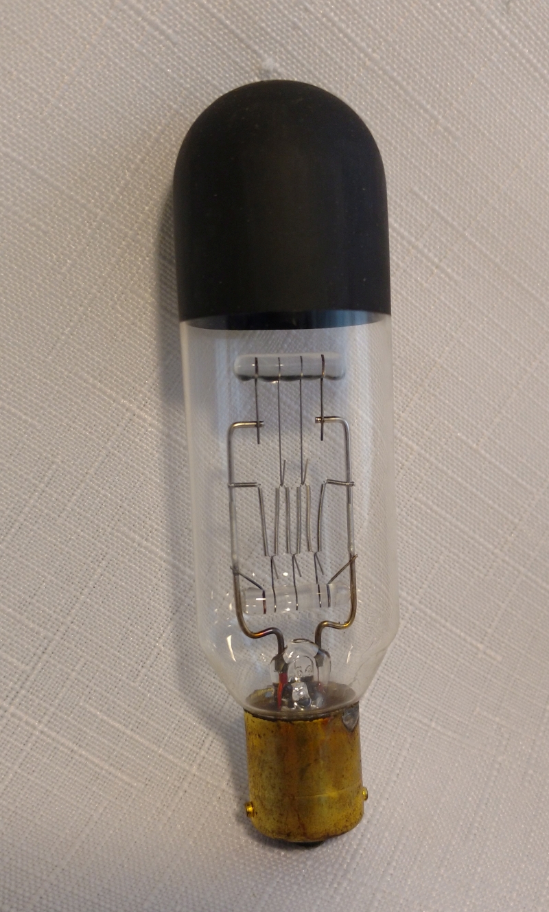

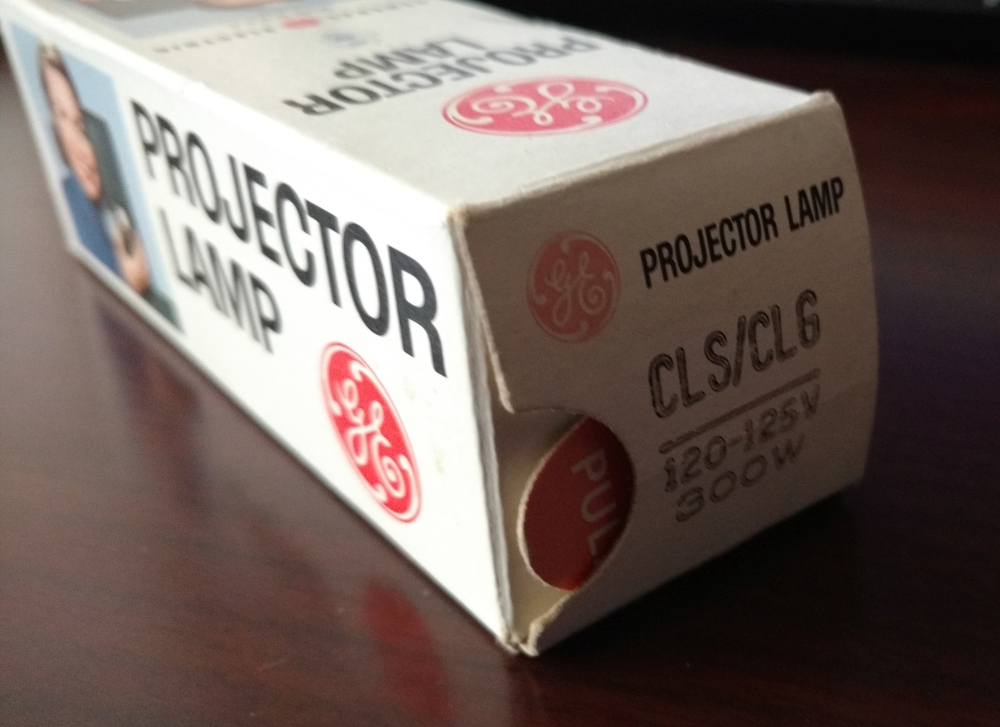

If your planning on building one of my older Zen Lite with the 300 watt bulbs,
you probably want to buy some soon....
I had some 500W photo bulbs
I snagged a few 300W projector bulbs to hoard just in case I get the itch.
Are those the ones that look like 211's?
😀 Appropriately shaped for an amplifier.
res07njc: I'm sure they're available somewhere!
