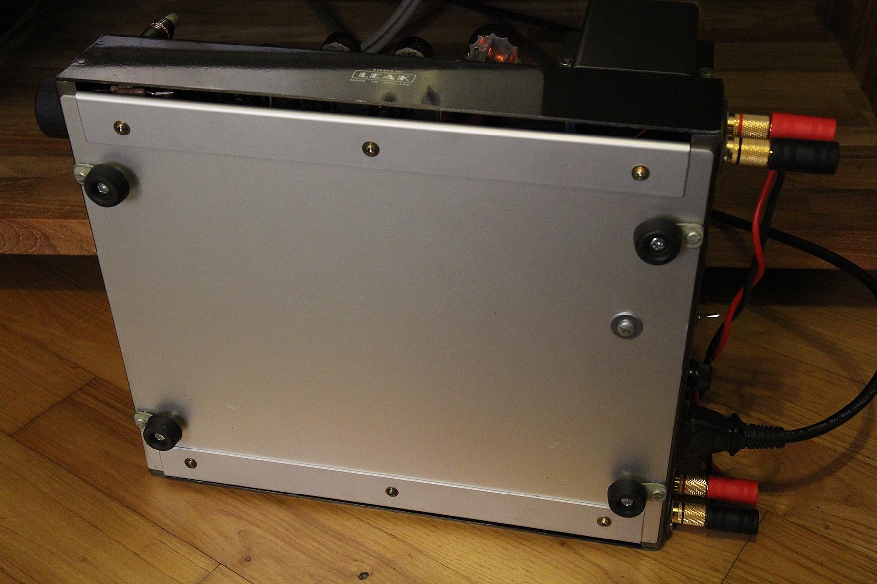

Leak Stereo 20 "Rebuild"
Important to mention, is that a bottom plate is mounted, this to eliminate the last bit of (from outside) induced hum.
Without, the stereo 20 will always produce some audible hum.
