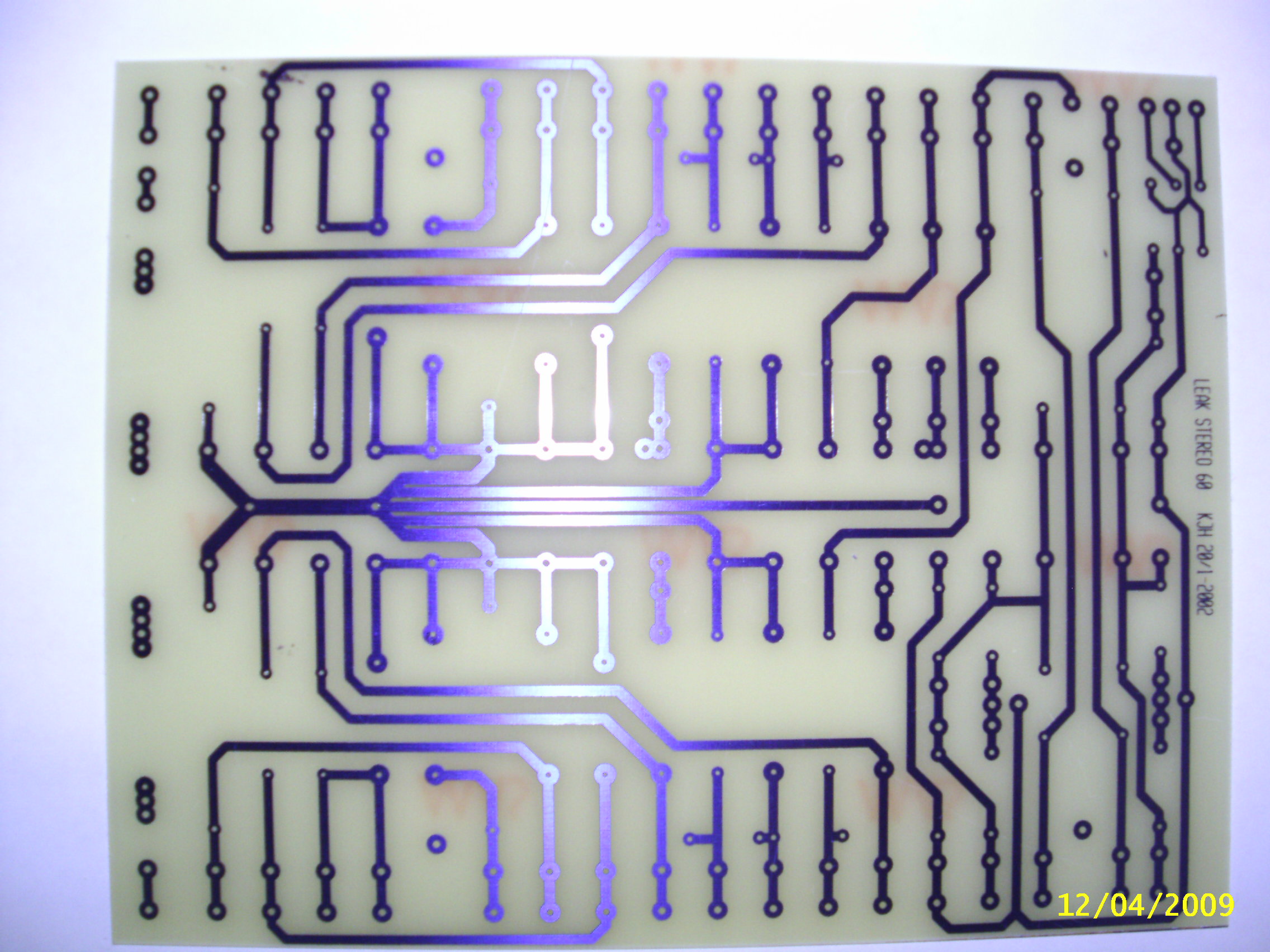

Andy.
You are way beyond me as for as the circuit is concerned. Don't know that much.
Tried to make a new precise PCB copy of the original without all the bottom wiring. The idea was: outer holes for wires - inner holes for silverpins.
What is best - hardwiring or PCB with cobberlines? Would like to refresh one of two amps - one original - one with new brown paint and Leak "marks" like "L" and "R" , "Input", ECC83 a.s.o.. Do you know the brown paint code? How do we make the "silkprint" on the paint?
Want to use EL84 - the type I can afford with best sonic sound! Is it possible for you to show the circuit you prefer for the Stereo 20?

If you want to restore Leak equipment, best to join the Leak users group - hjleak at Yahoo Groups.
I don't think I have any record of all the circuits I dreamed up. They were pretty simple - some kind of voltage amp first stage direct coupled to a differential pair with the second grid grounded. I then used russian teflon caps to couple to the outputs.

RP is plate resistance and gm is mutual transconductance. The amplification factor (μ) can't be realized, as an infinite load is necessary. You can come quite close by using constant current source (CCS) loading.
Installing a 12AY7 instead of a 12AX7 as the I/P tube reduces open loop gain. However, in a circuit with sufficient open loop gain, loop NFB circuitry determines net gain. Look at the Stereo 20 schematic. A global negative feedback (GNFB) loop is present. R18 and R4 form the gain set pair. Reducing R18's value increases the % of the O/P voltage fed back and decreases the net gain.
Now comes the tricky part. C9 is present for phase compensation reasons. It shorts R18 out at high frequencies. The 1/2 power freq. (F3) Leak chose is approx. 66.3 KHz. As R18 goes down in value, C9's value must increase to keep F3 "unchanged".
The tricky part, if understanding you right, is that c9 and r18 works like a filter that turns the phase at higher frequences? If one want to determine the "net" gain we have to reduce R18! - Increase C9.
What about R4 - do we keep same value? C9 have to be increased - how much?
Is it difficult to calculate?
The 1/2 power freq. F3 Leak chose 66,3kHz - did not understand? Is it 66,3kHz -3dB point at approx 6watt??

Sorry about creating confusion by using the term 1/2 power. R18 and C9 form a high pass filter. The frequency at which reactance and resistance are = goes by several names, including F3, "corner", and 1/2 power. This has nothing to do with the power O/P of the circuitry.
The law (formula) for RC filters follows immediately.
(2Π) (Fin Hz.) (C in Farads) (Rin Ω) = 1
Knowing any 2 of the 3 variables allows you to quickly compute the 3rd.
IMO, changing the value of R4 is not a good idea, as the bias conditions for the I/P triode will be altered.
Respectively, the OEM values for R18 and R4 are 12 KOhms and 100 Ω. Therefore, the fraction of the O/P voltage being fed back is approx. 0.008, which (IMO) is quite small. A seat of the pants guess for R18 and C9 is 4.7 KOhms and 470 pF. Use either NPO ceramic or NOS mica for C9. Unfortunately, there have been quality problems in current production silvered mica parts.
The OEM 1 MOhm value for R1 is not good. A low pass pole is formed by that resistance and the I/P triode's CMiller. As a consequence, HF info. loss occurs. Reduce R1 to 100 KOhms. Modern signal sources will have no difficulty in driving that value.

When you say NPO ceramic or NOS silvermica for C9 - does it mean that it is essential to be very precise at this point/component?
The info about R1 is good to have in mind - 100K it will have to be.
Gudmund
The problem with current production silvered mica caps. is the delivery of parts well outside the 20% tolerance claimed. NOS "domino" style mica parts are true, within tolerance, to the claimed value. Many NOS mica caps. are not silvered, as silvering cost more in manufacturing. What is important is that the claimed value be correct, within tolerance.
The specific tolerance of the phase compensation cap. is not particularly important. Each amp section, due to difference in stray capacitances and parts (particularly the individual O/P trafo) really requires empirical optimization at the bench. The value of the phase compensation cap. is tweaked to get the best looking (tilt, ringing, overshoot, ...) 2 KHz. square wave on an o'scope.
BTW, if you are going to try 4.7 Kohms for R18, make C9 510 pF.
After rebuilt the Stereo 20 have to be tested on a scope - by a friend - Will try to get NOS silvermica.
Yes - would like to try the suggested values - Thanks for the calculation.
