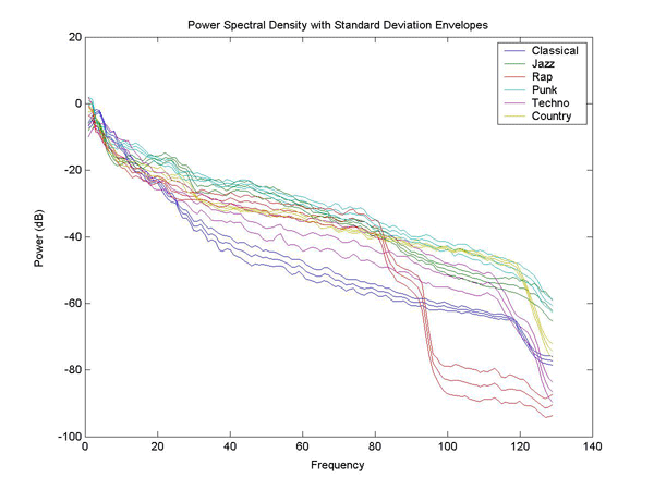

1- in an active system the voltages would not be mixed, so the graph is wrong.
This has no effect on the main point, which is you get the same SPL with 100W dedicate bass amp in an active setup as you would with a 400W passive setup'2- we need to add the loudness of two or more drivers in an active system, not the voltages.
3- In practice (i.e. music) the system would start to clip (run out of power) in the bass amplifier first, hardly in mid or treble amplification eventhough they may have half the power capability of the previous amplifier.

Amps clip at bass frequencies far sooner than any other frequencies for a good reason, read up on 'music power spectrum' to see that in music (or audio), bass signals are about 20-30 times higher in level than mid frequencies, which themselves are at higher value compared to treble.
This is why you need a large diaphragm for a bass driver because it needs to move so much air, while a 1" dome tweeter can move enough air to match the loudness of a 12" bass driver.
It does not take a genius to see that you need more power at low frequencies compared to high.

And I'm baffled (no pun intended) by that graph, specifically the horizontal axis labeled "Frequency" and numbered from 0 to 140 in steps of 20. What's especially interesting is how all the plotted lines have their highest areas between 0 and 20 - does that mean for all those types of music that the highest volume level is BELOW 20 Hz?

ben - my thoughts exactly - perhaps citing the source / context of that graph would be enlightening?

it is just a quick graph I pulled off the net, but it is valid.And I'm baffled (no pun intended) by that graph, specifically the horizontal axis labeled "Frequency" and numbered from 0 to 140 in steps of 20. What's especially interesting is how all the plotted lines have their highest areas between 0 and 20 - does that mean for all those types of music that the highest volume level is BELOW 20 Hz?
ETA: I won't argue with "unable to comprehend."
If you look closely, most types of music stop at 140, it is not hard to guess that means 14000 Hz.
equally 0 to 20 means 0 to 2000Hz.
Actually highest areas are from 0Hz to 200Hz.
"pulled of the net" - as posted above, source and context could be illuminating
or not - a poorly lableled graph is more than slightly misleading
"most types of music stop at 140Hz" - really now, stop doing what exactly?

from the graph, if you need 100W at 100Hz, you only need a few watts for mid/treble.
would this do?"pulled of the net" - as posted above, source and context could be illuminating

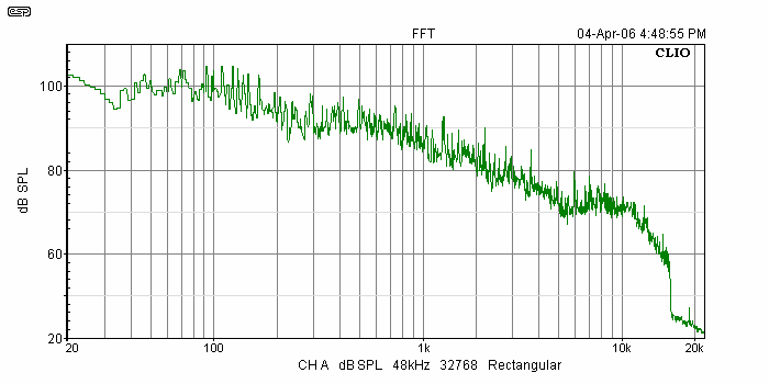

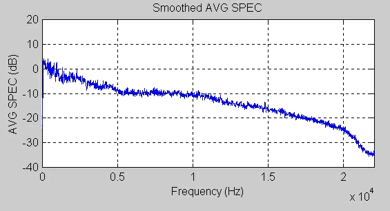

it is from ESP - Frequency, Amplitude and dB
Also another plot from Chapter 4: Listening Tests
the other one was from OpenStax CNX
