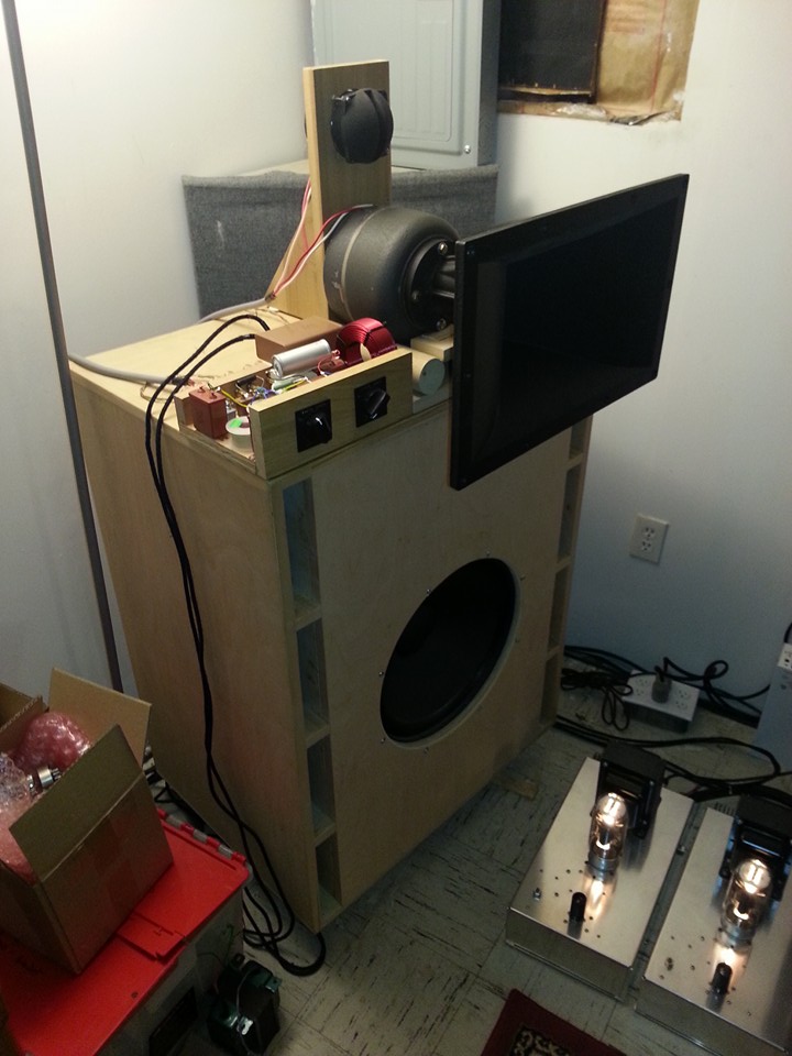

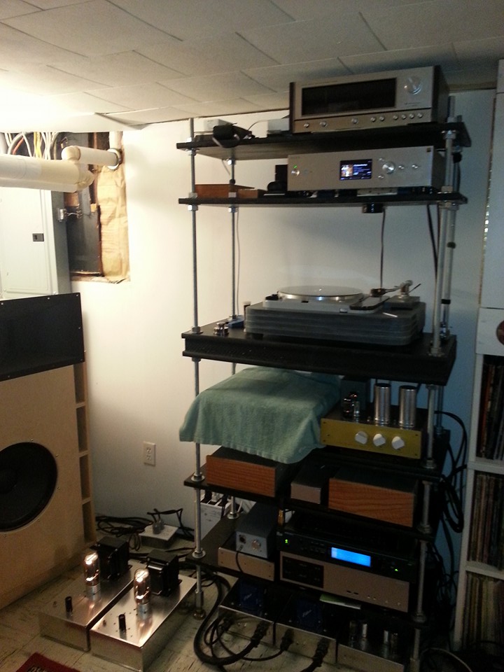

I designed and built my current SE amps roughly 4 - 5 yrs ago. I was not too sure this particular design would be a success. It's a two stage all transformer coupled GM70 amp with triode connected D3A as drivers. It will just about manage 20W per channel and is distributed across 4 chassis. Input is balanced to a UTC A-20 1:1 line transformer which drives a fixed biased D3A, which in turn drives a custom Monolith Magnetics 1:1 amorphous core IT, which drives the GM70, also fixed bias. The output transformer is Electra-Print. Power supply on separate chassis is solid state with CLCLC filtering to the output stage.. Driver stage DC operating point is controlled by CCS which also provide a lot of isolation to the supply and force all audio currents to flow through the local decoupling caps. Works very well, but is a PITA with fixed bias, as selected tubes are required, fortunately they last a long time.. I use Rod Coleman's CCS for filament heating on the GM70s and AC on the D3A.
The speakers are also diy and of my own design; 3 way based on Onken bass bins my father in law and I built 9yrs ago which I designed using the spreadsheet from Marc Cyre Debien.. Woofers are Iconic 165s, mids are handled by JBL 2440 2" drivers on JBL 2382A bi-radial horns, the highs are handled by Fostex T-825 bi-radial horn tweeters. Everything thing is pulled together by my 3rd generation 2nd order LR XO.. (700Hz 12dB/Oct, 8kHz 12dB/Oct, air core inductors, Russian caps)
Not one of the best looking systems I've seen, I tend to be a bit industrial and not into fancy finishes, and I move on before prettying things up... I've uploaded two pictures of my system. As you can see it is all DIY and it shows.. lol
Perhaps utilitarian is the better word...
I measure almost everything. (Use partially overhauled BSS Varicurve FCS-926 for room EQ) Future projects include getting my Garrard 401 (early version) up and running.

KevinKr, DIY speakers? Nooo they're so professional. Enough so it looks like your wife put you in the room with the furnace.

My setup looks like a 70's music-centre compared to yours!I designed and built my current SE amps roughly 4 - 5 yrs ago. I was not too sure this particular design would be a success. It's a two stage all transformer coupled GM70 amp with triode connected D3A as drivers. It will just about manage 20W per channel and is distributed across 4 chassis. Input is balanced to a UTC A-20 1:1 line transformer which drives a fixed biased D3A, which in turn drives a custom Monolith Magnetics 1:1 amorphous core IT, which drives the GM70, also fixed bias.
I thought you could get more than 20W out of GM70's, but then again the output transformer needs to be huge, with a cold water radiator, built in.
Thanx for the reply and pictures.
Do you play any kind of music through them, or are you a classical man.

The furnace is in the room next door. This room was actually built for me, but the JBL Rhodes I had previously were a bit smaller.. lol It's actually (and strangely enough) by far the best sounding room I have ever had. Must be that crumbling 106 yr old concrete behind everything, and the clutter everywhere, and yes a bunch of bass traps helps too. Happy accident, and unfortunately not large enough for my crowd.. I will admit that the speaker system was designed taking into account the nature of the room. The horns are deliberately rather directional to reduce early reflections, etc. LF response extends to a bit below 30Hz.
