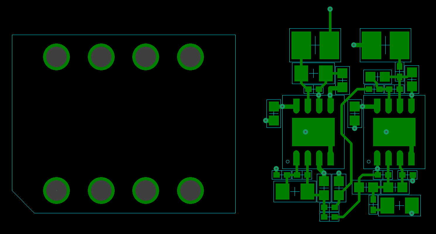

Had a look at your design CBS240, one question, why when you have used SMD have you spread them out so much? It is not just your design but other SMD designs on here, they regularly spread the devices out.
Sigh...they don't do that here. The tradeoff is number of layers.
Honestly, some of the boards have the look and feel of 60 grit sandpaper. It's hard to imagine a schematic which requires so many caps and resistors..
I truly like power devices, something I don't need a microscope to see.

Not something like this then (its a standard 0.1pitch PTH IC on the left).
Of course these days the boards when they come in a just a blur...
Yes. When creating a prototype PCB it becomes necessary to change component values as you troubleshoot each circuit so reflow is out. If your design is accurate you won't have too much trouble barring a steady hand and a magnifying glass.😛 Spacing would be for 3 reasons, 1) the PCB is only 2 layers and the space is needed for routing. 2) heat dissipation. With SMDs the PCB and the copper pads are the heat sink. 3) Hi current routing takes precedence in placement with small signal and control circuits of lesser importance. I like grouping the components of one of the many circuits together in a general area.
Spacing between SMD lands may be to allow old fashioned hand soldering methods to gain access to the individual solder pads.
All the footprints are to the IPC-7351 standard (least). The actual full board is a 8 layer HDI construction. The smallest devices are 0201 chip devices, and some people can re-work them. I'm not one of them, most of what I layout is just a blur these days.
Most of the routing is shown, on the top layer, the vias shown are laser drilled 0.1mm hole, 0.3mm pad.
A bit extreme for DIY. Add this headphone amp (the bga package) and you have a very very small headphone amp, think small portable devices.
I use 0201 resistors in that project I posted, several 0201 resistors in fact. None of them are running above 40% of the 0201 de-rated Pd rating. I can hand solder them, but it is not as easy as 0402 size. It takes a certain technique. 😛 SOT-923 is quite small as well.:magnify: That PCB includes the complete power supply along with all the logic and protection circuitry which is why it looks so complex with so many parts.:xeye: They are not just thrown in for sh!ts & giggles. There is a half dozen different seperate circuits on that PCB. The PCB is only 2 layers, 1 Oz Cu. Vias are 10mil. All cut-outs were done by me, it cost a lot extra to have the boardhouse make cut-outs. Overall, I paid ~$100 for 5 PCBs including shipping.
