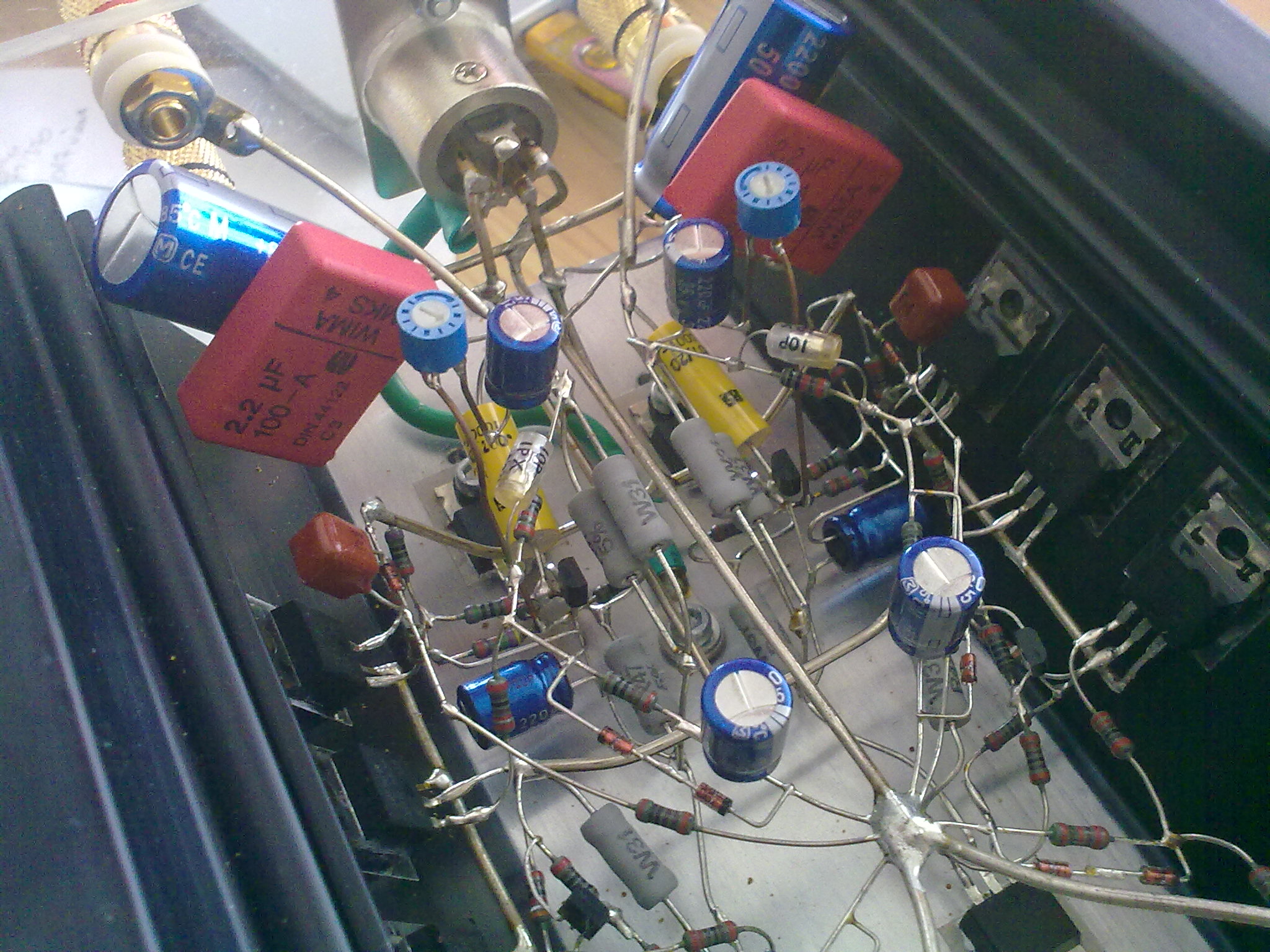

See this? All done with lead-free solder. With the proper temperature and technique, there is practically no difference between lead-free and lead solder. Lead-free smells better perhaps, but that's it.

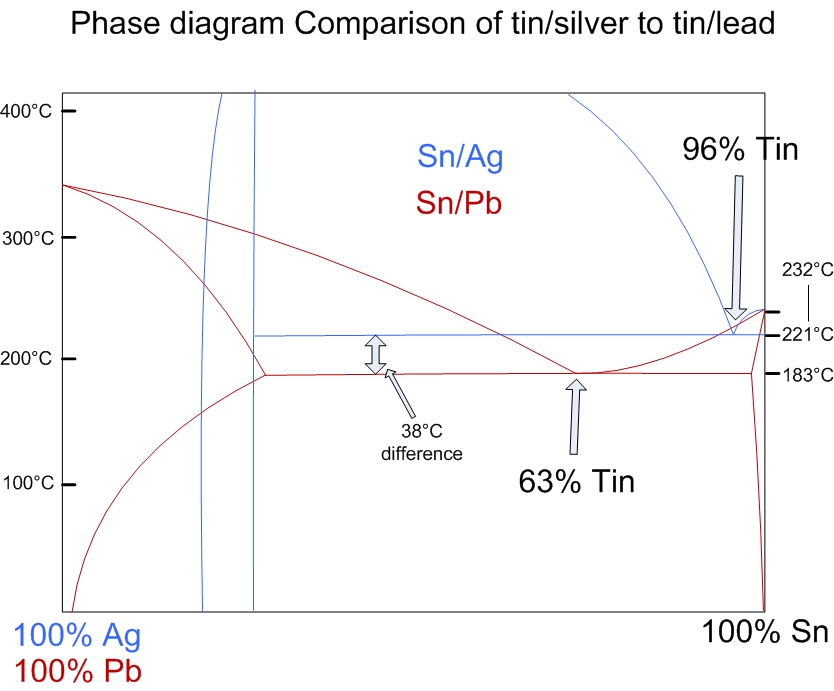

Tin whiskers, a big problem for high rel products even when you can use tin/lead solder, most modern components have a Pb free finish on the terminals...
I use Multicore Tin/Lead/silver, because I have a big roll of it🙂
The wetting of solder has nothing to do with the temperature of the solder.
It has everything to do with the flux, both it's activity and it's working temperature range, as well as the surface cleanliness, and the surface type. Some fluxes are better suited for some metals, nickel for example has one flux that's better than most.
RMA flux has historically used zinc chloride..I understand Kester is now using something I can't pronounce..abba....abba...abba something..🙁
Tin whiskers are an issue if a short caused by them cannot clear it. Toyota had this issue according to a nasa report.
Tin pest doesn't seen to be an issue for tin/silver eutectic. I used about half a ton, it all is at liquid helium temperature, and no pest so far.
Can't say if whiskers grow in tin/silver however. 7000 amp busses tend to clear whiskers, so if they grow, they don't survive.
Me, for hi rel, it's tin/lead eutectic all the way.
edit: oops, this must be an earlier version of my slide presentation, that 232 C is the melt temp of pure tin, for some reason the drawing is messed up..sorry.
