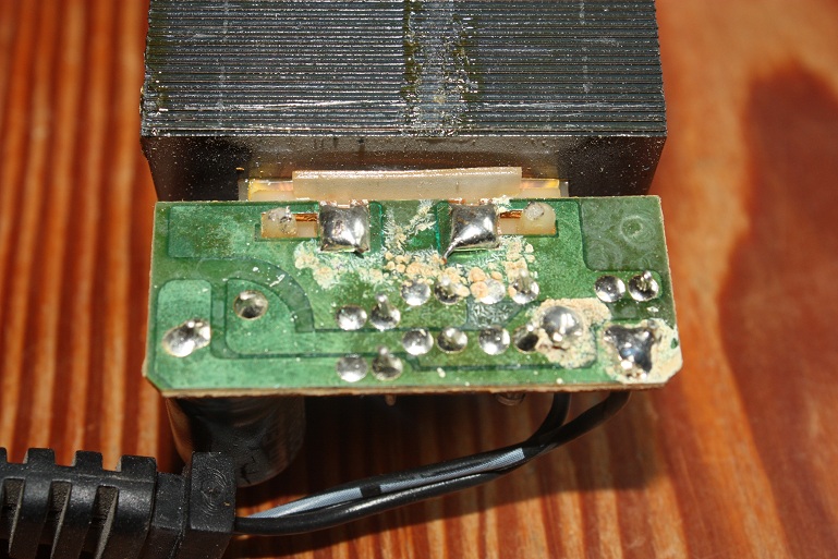

any idea why it looks like this 😕
Not cleaned flux? (wild guess)
Telstar, thats what I said...
You very rarely get copper pins thery are always have a finish on them for components, and if you are soldering wire you tin it first.
It aint realy added for any other reason...Copper was added as a tip saver
As ENIG is one of the most popular finishes for SMD boards (ie the majority of baoards manufactured) and has been for a long time I would take that as a given. Though due to the price of gold other finishes are gaining in popularity including ENIPIG, immersion silver and some of the newer OSP finishes with a longer shelf life such as ENTEK® PLUS HT.Most PCB have tinned pads, therefore any solder containing tin (=all of them) will bond. I think zero issues are also caused by gold-plated pads (they have the advantage of not oxidizing over time, which is the main cause of bad solder joints).

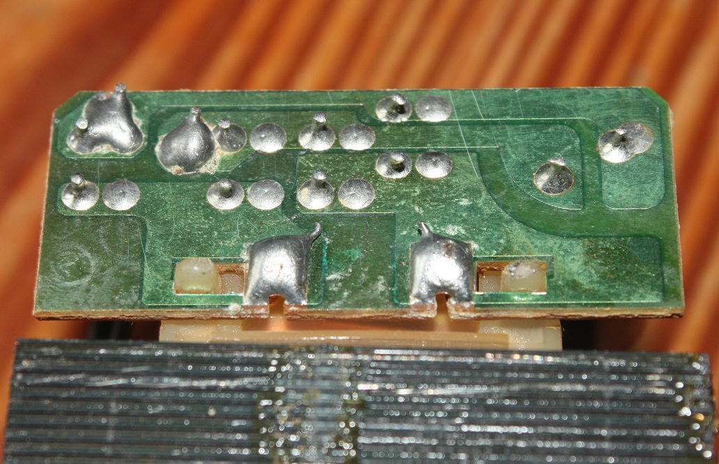

what you see is corrosion
so if you mean the flux remains is acid that slowly eats its way through to the copper ...
Not so wild. It does look to be that the board components were installed cleanly, then the AC cord and transformer were soldered and left messy.Not cleaned flux? (wild guess)
If the mess is only on the surface the board should be salvageable.
There is no such thing as a no clean flux if you want reliability, flux residue can be reactivated in hot humid conditions and ruin the board. Always clean the flux off.
