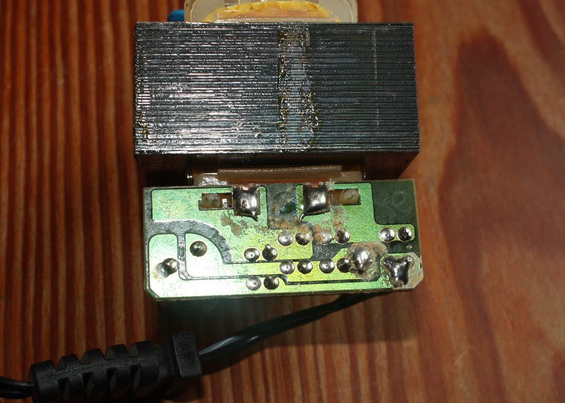

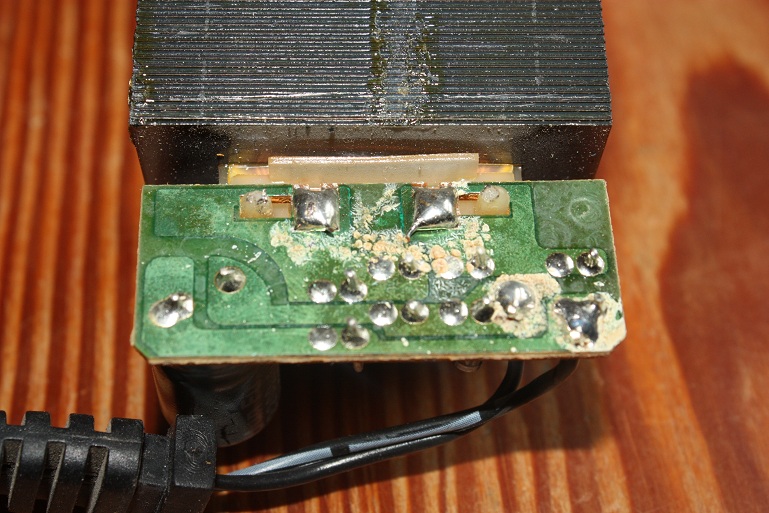

just now slaughtered this wall plug thing, because I wanted the trafo
looking at it I thought, maybe I should save/use the diode board
until I looked at solder side
looks real nasty 😱
solder looks shiny and new
any idea why it looks like this 😕
