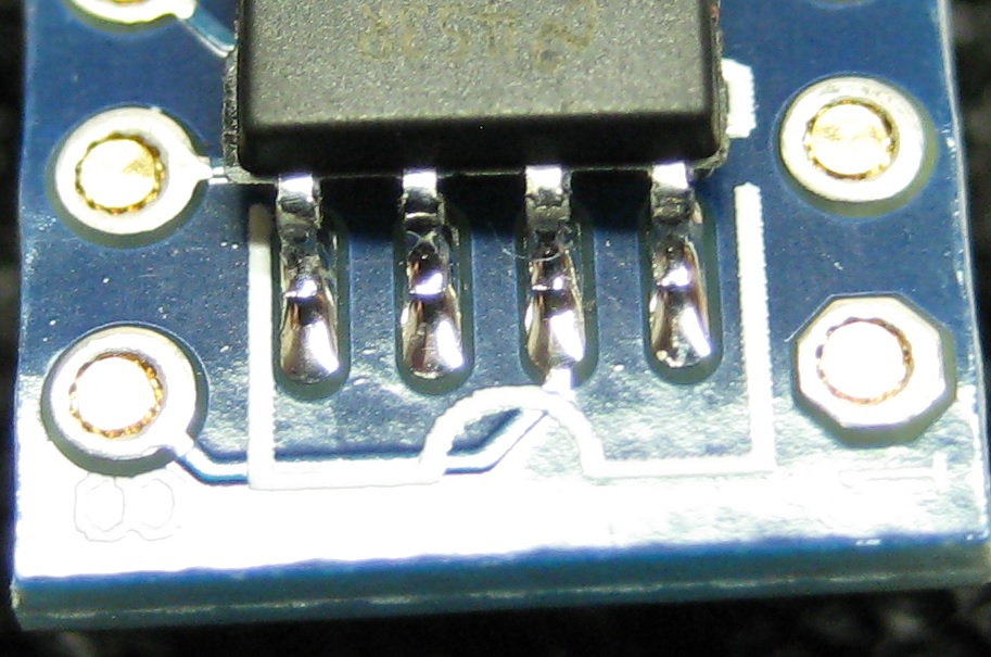

I'm confused. Tin silver doesn't have a shiny surface finish like eutectic tin/lead. It's a wee bit frosty in appearance. I had to re-teach all the techs and the QA people because of that visual difference.
Sorry, I didn't realize he was talking about tin/silver solder. The stuff I use is 62/36/2.
