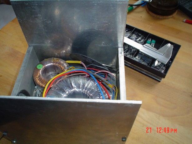

Nice pics Terry,
I still don’t quite understand what you want with the superamp, I just measured 150W RMS into 8 ohm, and 275 W RMS into 4 ohm using the extended Leach design that I made.

Me neither Terry. Couple years ago I measured 310W into 8 ohms using the same board as you built. But my power supply is 93V dc.
Only 8 T03's per side tho. Heatsinks get kinda warm when driven above 100 W. Foolish waste, eh?

I have a 4.5" X 14" board, .090" double sided, with six pair running at ±93V (idle), does 600W/4R.
Also has relay and subwoofer crossover.
These were laid out a few years ago when the large plate amps were not available.
Nothing wrong with the basic Leach design.

Hi Jens,
Well, if you read the thread where I posted the pics, you'd see that it all started because I had bought the 64-0-64 transformer and was looking for an amp design I could use it on. The Superamp was suggested and the rest is history. As a matter of fact this thread sort of got started because of my asking questions in the Leach clone thread about your boards.
I'm into it now so I'm going to stay the course until it is finished. Still hoping that it will sound great. Time will tell.
Blessings, Terry
