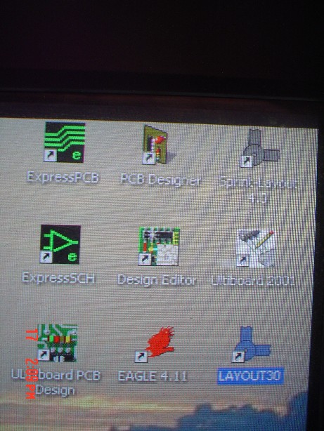

Mind if i ask what software you use for your layouts, Jens ?

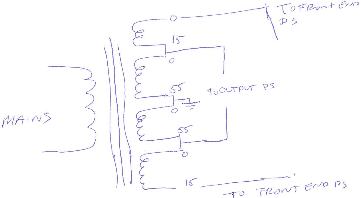

Wow, this is all very interesting. I'm "steppin' and fetchin'" to try and keep up with what you guys are saying.
I would love to understand how to wire my transformer and board as stated by jacco. could someone maybe draw a little diagram so I could get a better grasp on it?

Terry,
Assuming you have four separate windings, connect them all in series, hot to cold like this:
To front end PS -- 15V -- to output PS -- 65V -- ground -- 65V -- to output PS -- 15 V -- to front end ps.
You should see 160 VAC across the front end terminals. You cannot do this if your 15V windings are a single 30VCT winding.
To separate the power supplies, leave out R32 and R33. Use the pad as your connection for the front end PS. This will leave the drivers at output rail voltage.
You could also cut the trace between Q24 and Q26 collectors as well as between Q25 and Q27 collectors, leaving R32 and R33 in place.

Thank you, Bill.

Terry,
your secondaries give 70 VAC in series, not 65 VAC !
After rectifying that is 7 volts DC more than designed for.
With your transformer you may need to regulate the powerline to drop the voltage to 91 VDC, the regulation comes free.
It is possible that you can run the front end of the amplifier on 98 VDC but i'd check first.

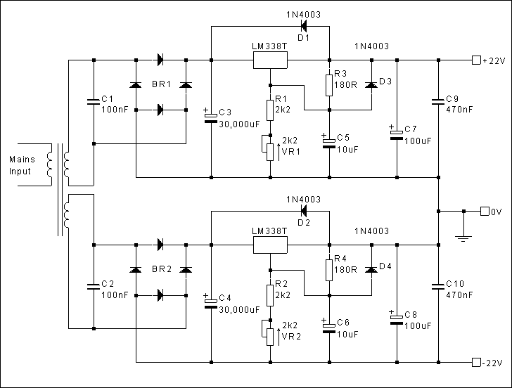

Maybe you could take a look see at Rod Elliot's for a regulator circuit.

This is the transformer I am hoping to use. THe add says 62+62+17+17V 1000VA .
On the side of the transformer it shows this;
If you read the add you can see the test results which show higher than 55V. I'll let those of you who know better to decide what this tranny actually puts out.
If I understand properly, 62*1.414 = 87.668VDC I know there is some loss for the rectification, but still it seems suficient to power this amp. If I add the 15V or 17V which ever it is, won't I have too much power?
62 + 17 = 79*1.14=111.706VDC
My transformer has 8 wires coming out of the secondary, 4 for the 17 + 17 and 4 for the 62 + 62.

Terry,
That should work, just move the bottom 15 volt winding to the top of your picture and connect the windings in series - 0-15V to 0-55 to gnd to 0-55 to 0-15. your front end takes power from the outside windings, the output stage from the 55 volt windings.
With BJTs you really don't need to run the front end at significantly higher rail votage than the outputs like you do with MOSFETs. Use the extra voltage to allow you to regulate the front end back down to a volt or two higher than your output rails.
For a regulator you can build something like Rod Elliot's, or modify something like the one at passdiy.com in the balanced zen line stage. Just change the voltage reference zener stack to suit. For no particular reason I like the regulator used in the Pass-Thagard A75. you can change the values of the voltage divider resistors to get the output voltage you want. It's easy to build point to point on perf board if you don't want to make a pcb.
edit: I hope that your primary is really two windings or you may be in for a surprise - only half the output voltage that you expected.

It seems there are two ways of looking at Terry's transformer. I agree with Jens that Terry probably doesn't need or want to to run the whole amp at potentially 122 volt rails.
Using the low voltage windings to allow a regulated front end, does make sense, though. Here is a sketch of the connection I tried to describe above.
With a suitable regulator Terry could end up with something like 84 volt output rails and 86 volt regulated front end rails. It's probably a good idea to mount the regulators' pass transistors on the main heat sinks - at least give them something substantial.

I can never decide if regulation is a good idea or not. I guess it depends on the answer to this question:

maybe Terry will build his amp so that he can easily switch from regulated to unregulated front end rails and let us know whether he finds the difference audible.
OK, OK, my head is spinning.
First of all, I just bought 4 100V 10,000uf caps for the power supply so I'm not going to be running something that takes 150V caps, at least not for this amp.
I can't seem to find any info at Rod Elliot's site about building a regulated supply so for now I think I'll stick with just using the 55V. I'm afraid I'm going to get into trouble if I start deviating too far from the proven design. And, Like Jens said, what will I do with all that heat. I just want this thing to sound great and have a little kick when I feel like it.
That running in series is a good thing to know. A lot of the transformers that the guy sells have dual secondaries like this one. Definately gives one more options.
Thanks Bob,
I think I see how to hook it up. Am I right in assuming that both sets will need their own rectifier and set of filter caps?
Thanks, Terry

Terry,
Thanks Bob,
Thanks, Terry

if you use this transformer for the Leach you will have the 62vac on the output any way.
The 17 vac give you 24 vdc on top of the 62vac .
If 65 Vac is needed to deliver 300watts in 8 ohm, 49 volts, the front end needs less than16 volts, the rest is a margin on the output voltage.
Meaning, with a regulator you can drop 8 volts, from 24 to 16, to drive the amplifier and get a stable voltage.
A regulator can easilly do an 8 volt drop.
Thanks, Terry
Yes, you'll need two sets of rectifiers and filter caps. The good news is that the front end draws very little current, so a 1 amp bridge is more than enough. Similarly, small current means smaller filter cap requirement. For the front end, a few hundred uf before and after the regulator will be more than enough. Don't run the front end without a regulator if you boost the voltage - you don't need an extra 20V.
