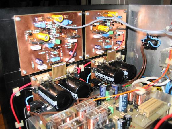

After waiting a couple of days and nobody adds to this thread i suppose that asking Jens if he is willing to convert the Extended Leach board he did to just the front part with a jumper connection for the output boards should please all.
> With solderpads for attaching powerlines from active
regulator boards to the Leach front end pcb or just regular
powerlines.
> An output board for 6(?) TO247's.
> An output board for the 2(?) double barrels.
> All three boards with jumper connections for
signal in/out/power/ground/feedback.
So far i have not read a posting disagreeing with some of the Extended Leach's features, other than the possibility of a smaller pcb and smaller R's.
Me, i find the Extended Leach board Top of the Pops.
Just that one with connections for output boards that take either TO3's or TO247's would make me a very satisfied kid.
Does anyone know where i could find the datasheet for the Toshiba 2SA1302 and 2SC1381 ?
I should have them somewhere in my paper data dump, a search on the net so far ended up Zilch !
I have no experience with the MJL1302/MJL3281 so far, but would like to compare the datasheet of the MJL's with the one of the Toshiba's.

I could not keep waiting for a conclusion so it happens that I’m almost done with the small signal part of the super leach amp. The PCB is based on my extended design but without the output and driver transistors.
Should I just add solder pads to the power section, or should the connection be a “bridge” like my prototypes?

Jacco wrote:
I was wondering who are still in favor of a front stage pcb and two power boards ?
I am in for 4 Leach amps:
powerlines.
> An output board for 6(8) TO247's.
Thanks, Loek

JensRasmussen said:Update,
The small signal PCB for the superamp looks like it will be about 11 x 13 cm = 4,3 x 5.2 inches
Is this ok?
\Jens
Forgive me if this is a stupid question. If you are going to do separate boards, what is the advantage of redoing the signal board? Is there something wrong with the one that Dr. Leach designed? I thought this thread was about creating a board to accommodate flat-pack output transistors. If we are going with separate boards, wouldn't we only need the boards for the outputs?
Thanks, Terry
Hi Terry,
Good point, but I have not been able to get the original parts so I have been using MJL340/350 in the VAS and predriver stage.
I like to have everything on one board, but this solution seems to unpopular.....
Anyways, you might be able to use an output board along with the original boards if you want to.
I think the one board solution is better, since the long wires are eliminated. It does however need a bigger heatsink
\Jens
\Jens
A compact solution on a single board is good becuase then the pcb designer make all critical wiring. What can go wrong when building for example a Gainclone? The wiring! => Eliminate the wiring!JensRasmussen said:I think the one board solution is better, since the long wires are eliminated. It does however need a bigger heatsink
